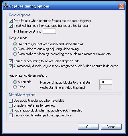

  4. Don't waste your time capturing long segments until you've gotten close to the right settings for your capture device. Capture a minute or two. Check it. If there's something wrong change some settings and try again. Once you can capture a short segment with no obvious issues move on to longer segments.
    Wrong pitch on captured audio may be Capture -> Timing... -> Resync Mode -> Sync audio to video by resampling... Turn it off.
    Yeah, i did that and swapped it to the opposite option of sync video to audio, but it still was out of sync, it cured the pitch issue though.

  6. What about "do not resync"?
    Also, don't play the audio while capturing (Audio ->Eanble Audio Playback off) and save it uncompressed (many audio compressors are too slow for this).

    I never have the audio playing while capturing, so that has always been set to off.
    I just did another capture turning resync off and its still out of sync (worse than before i think), ive made screenshots of my settings that i've attached including one of the finished stats.
    Could this be an FPS issue?
    (Audio Compression is set to "No Compression PCM")

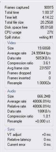

  8. In what way is the audio sync off? Is it off by constant amount through the entire cap? Or does it further and further off during the cap? The former isn't anything to worry about, it's easily corrected by applying an audio skew later (Audio -> Interleaving -> Delay Audio...).
    Jul 2016
    UK
    Well using VLC to change the track delay whilst watching it back i found that i had to hasten the audio track syncronization by the following:
    09:51 -0.600 s (that is a minus number, not a dash to seperate the time from the delay, same with the two below)
    45:28 -0.900 s
    59:53 -1.200 s
    So it gets gradually worse but doesn't even start in sync from what i can tell (those times were the clearest you could see lips moving).
    This is taken from the latest capture using the settings shown in the pics above.

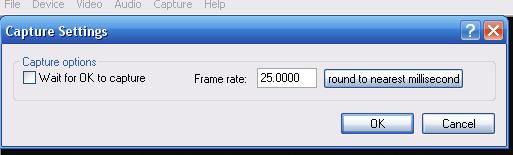

    Success!
    I managed to capture at 25 fps using AmaRecTV 3.10.
    For anyone who is following this thread, what i did was manually type 25.00 into the "Format" field in "Graph 1(Device)"

    It worked great, audio totally in-sync and running smoothly at 25 fps.
    Thanks to everyone who has helped me achieve this, especially jagabo.
