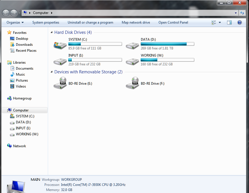

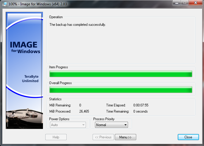

  23. Banned
    Feb 2013
    Imaged C drive to D drive
    Running encode with source on D drive at same time
