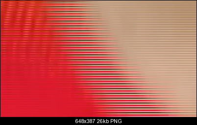

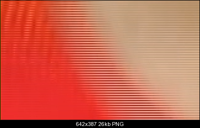

  28. Like I said, 99.99% of what I use for Blu-Ray starts out as 4:2:2 25fps 1080i. If UYVY is 4:2:2, can I not just frameserve as UYVY, instead of YUY2? Cleaned out some hard drive space and put together a YV12 Lagarith AVI to use with MeGUI for a 4:2:2 1080i25 video I'm using in the same project, because I'd previously just run it through the frameserver and it looked weird around the edges of some things when there was movement. Saw some differences in the combing in Premiere between the final .264 and the initial .ts, so I gave the Lagarith file a shot. But the Lagarith AVI shows the same differences.
    Original .ts:
    Lagarith AVI:
    400% zoom in Premiere. Zoom out and they both look identical as stills, but watching on a TV the resulting .264, showing the same combs as the AVI, looks weird around some areas. It only seems to affect certain colors, strangely. It looks very similar, if not identical, to what used to happen before I added "interlaced=true" to the ConvertToYV12 line in the AVS file. Seems fine in PowerDVD though.
