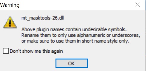

    the first error i've got was this when i try to load the script https://forum.videohelp.com/images/imgfiles/LAeyXYL.jpg
    i've solved it by changing the name of "mt_masktools-26.dll" to "mt_masktools_26.dll"
    and it solved the problem tho i am not sure its right
