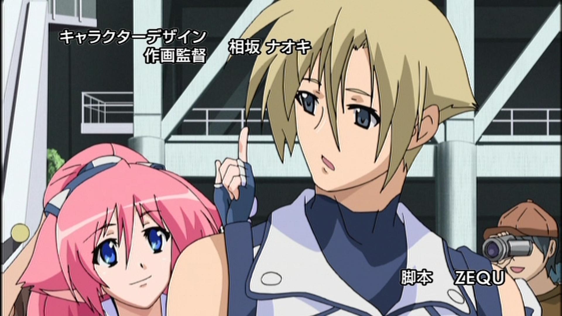

3.some sort of a "coating" along the endges
https://forum.videohelp.com/images/imgfiles/gHXLsfQ.jpg
look at the guys hair there are like some sort of half transparent blocks all along the lines

1. Poor deinterlacing. Inverse telecine instead, or a better deinterlacer.
2. Compression artifacts. DVD source shouldn't be that bad.
3. Oversharpening halos. DVD source shouldn't be that bad. DeHalo filter.
If you're serious you'll have to learn AviSynth. -

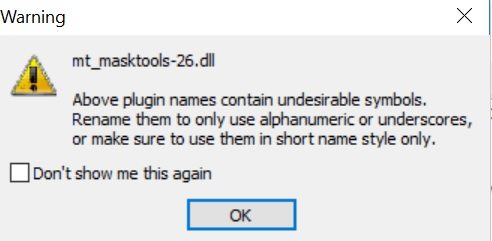

for example here is my script where i try to load the VOB file i've got from "DVD Decrypter" and it errors
https://forum.videohelp.com/images/imgfiles/LAeyXYLh.jpg
script:
v = LWLibavVideoSource("d:\4.VOB", fpsnum=30000, fpsden=1001, format="YUV420P8")
a = LWLibavAudioSource("d:\4.VOB")
AudioDub(a,v)
QTGMC( Preset="Slow", EZDenoise=2.5, NoisePreset="Slow", SourceMatch=3, InputType=1) -
