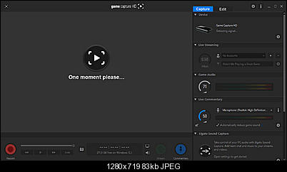

    I recently purchased an Elgato Game Capture HD with the goal of converting some old home videos to digital. Most of them were on video8 cassette tapes and the rest were on VHS tapes. While recording these I ran into an issue where the Elgato software will lose signal from the playback device.
    This happens whenever there is a break in the playback from the tape. Some examples:
    • Breaks between scenes
    • When I fast forward or rewind
    • Resuming playback after being paused
    • Playback comes to a defect in the tape where the picture gets messed up for a split second
    This can be very frustrating because it can take 5-10 seconds to reacquire the signal.
    The VCR I am using is a Samsung dvd-v3500. Here is the user manual and some other information. Also here is the manual and user guide for the Elgato Game Capture HD. It is primarily meant for capturing gaming footage, but it also has an adapter for composite and component input.
    What would you recommend I do? Is there some other software I could use with the Elgato that would not drop the signal due to hiccups in the playback? I searched around a little but couldn't find much.
    Or maybe there is there some device I could run the video through to eliminate the glitches and make the source constant?
    As you might be gathering I don't know much so any help would be greatly appreciated.
    Thanks!
