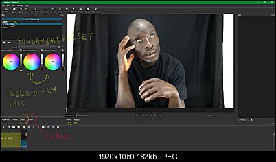

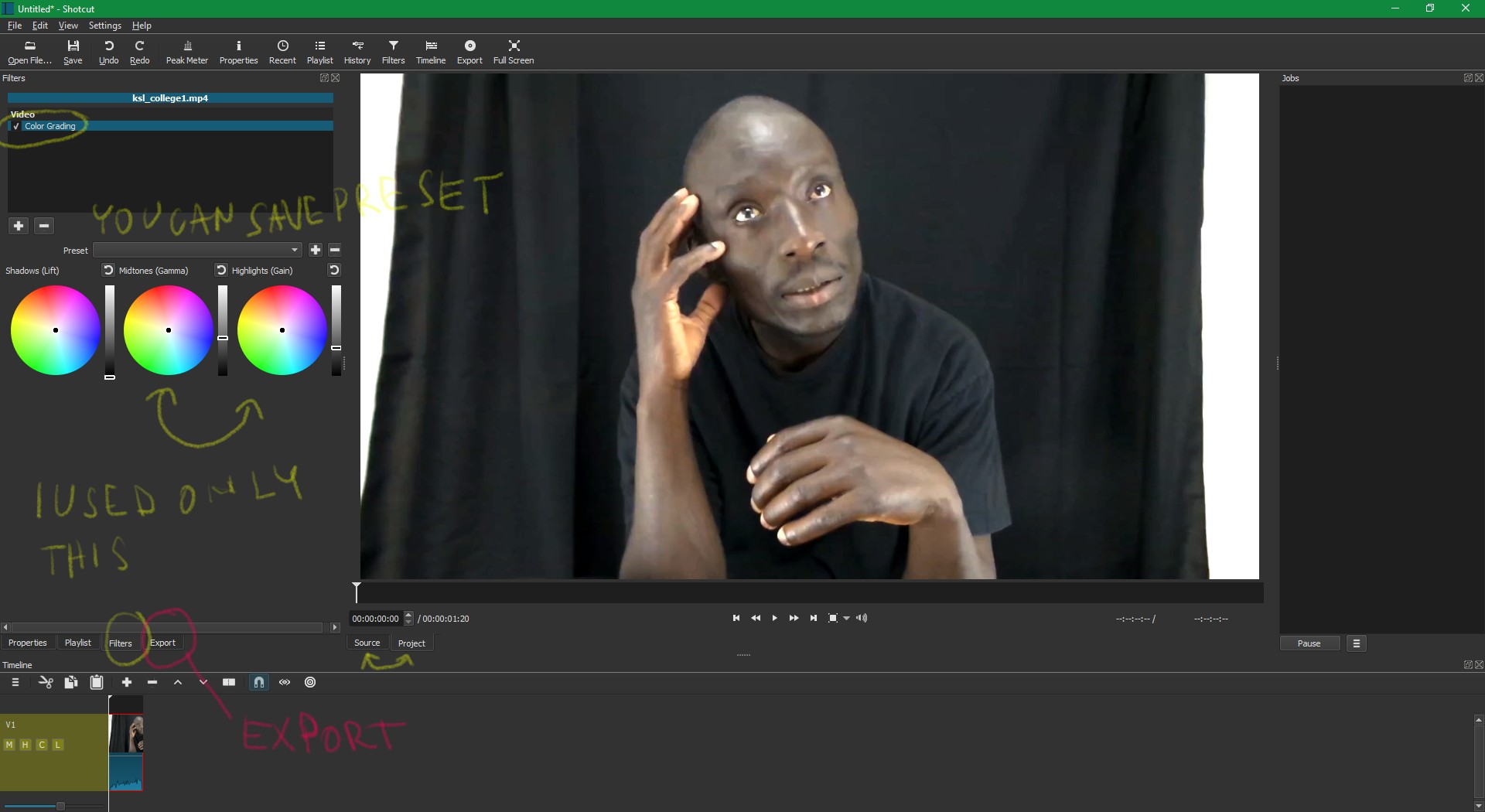

  8. Member Bernix's Avatar
    Apr 2016
    Europe
    You can use Shotcut for this. If it will works for you. For me it works well. But it has slow start.
    is that any better ?
    Bernix

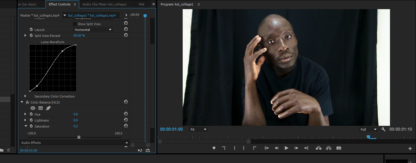

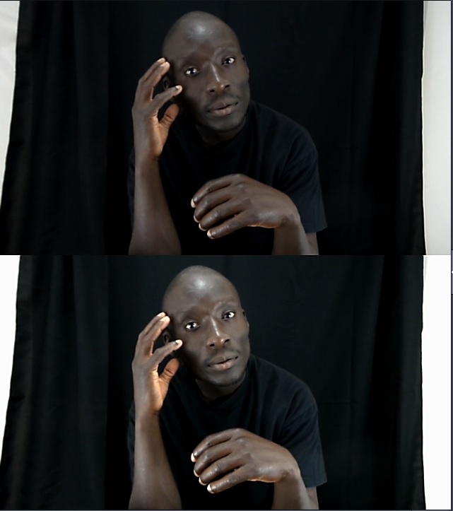

  10. Originally Posted by BobAchgill View Post
    I just seems that there should be more highlights and detail for having that much light and resolution. I guess the white parts of the curtain on the sides knocked off the color balance. Is there a tool that works with source mp4 that can adjust the color/contrast/shadow?
    There's nothing wrong with the color balance. There's nothing wrong with the amount of light you're using. Remember, lighting is about proportion more than quantity. You've just made some bad decisions by not using back or top lights to separate the subject from the background. You want more contrast, not more light.
    [Attachment 37271 - Click to enlarge]

  12. Originally Posted by Bernix View Post
    Bernix
    Yeah, that is better.
    Can you show me a screen shot of the filter setting you used?
    Is it possible to batch correct 1700 clips using that preset?
    Can I achieve the same using Video to Video? ... since I know how to batch using app.
    Tks!

  13. Member Bernix's Avatar
    Apr 2016
    Europe
    I dont think, you can do a batch. Maybe throught FFmpeg ??? But I dont know if it has filters for Midtones and highlits...
    I wrote something. If you have a any question, I will try to answer.
