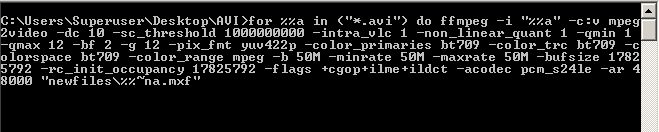

    I ran the following (from your code) as a bat file from a command line inside the avi file source folder and the files converted ok.
    for %%a in ("*.avi") do ffmpeg -i "%%a" -c:v mpeg2video -dc 10 -sc_threshold 1000000000 -intra_vlc 1 -non_linear_quant 1 -qmin 1 -qmax 12 -bf 2 -g 12 -pix_fmt yuv422p -color_primaries bt709 -color_trc bt709 -colorspace bt709 -color_range mpeg -b 50M -minrate 50M -maxrate 50M -bufsize 17825792 -rc_init_occupancy 17825792 -flags +cgop+ilme+ildct -acodec pcm_s24le -ar 48000 "newfiles\%%~na.mxf"

  10. cool. thanks
    I'm just not that good at this. But how did you do that? Did you make a .sh file and ran it in the terminal or ?
    [Attachment 36956 - Click to enlarge]
