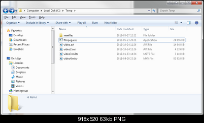

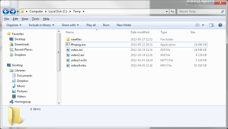

    Extract the ffmpeg.exe from the 7z file with 7zip and put it in same folder as your video files.
    Create a folder named newfiles in your video folder.

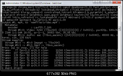

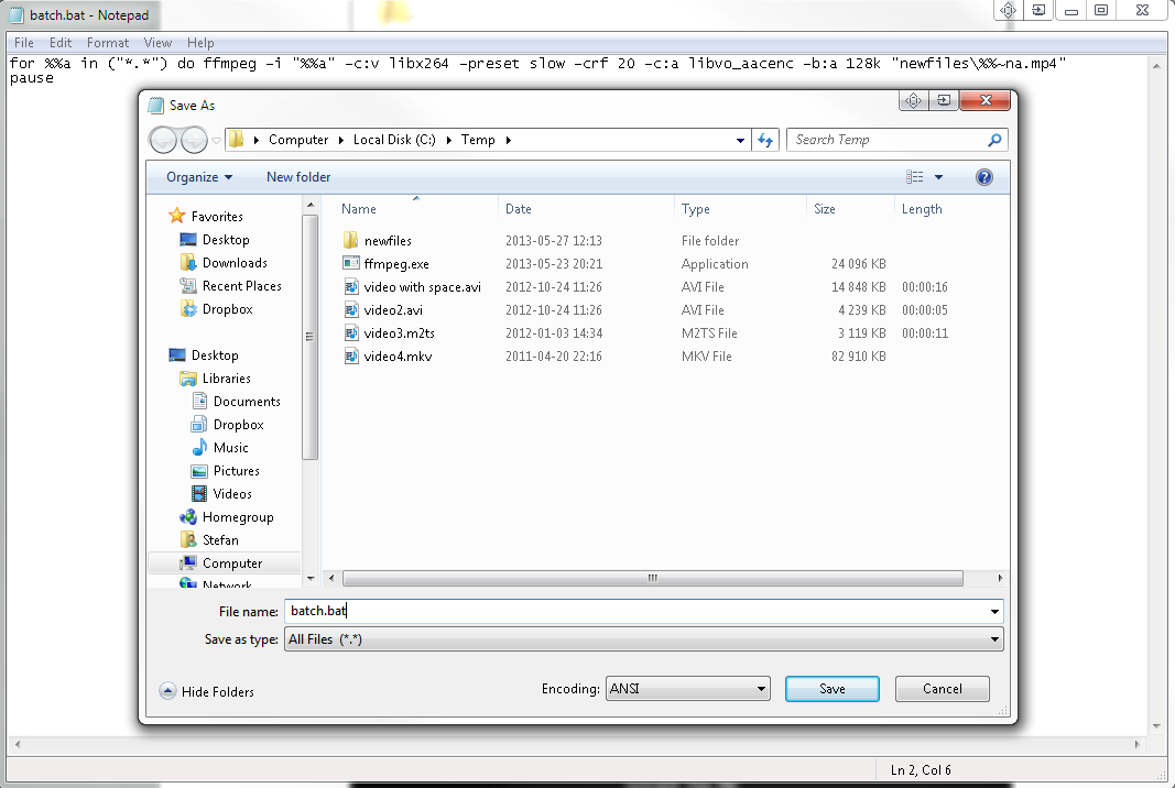

    Start notepad and type the following to convert all your video files to mp4 with h264 video and aac audio. See more examples at the bottom of this guide.
    for %%a in ("*.*") do ffmpeg -i "%%a" -c:v libx264 -preset slow -crf 20 -c:a libvo_aacenc -b:a 128k "newfiles\%%~na.mp4"
    pause
    Now save it, File->Save as, change to All files under Save as type and save it as batch.bat.

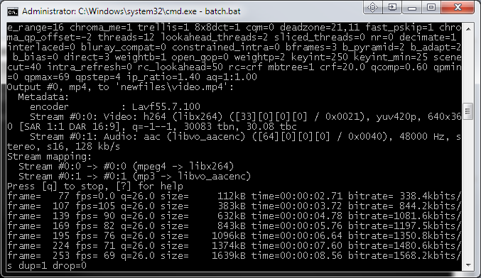

    Just double click on the batch.bat to start converting. You will see any errors in the command line box.

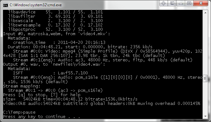

    When it's done just press enter in the command line window.

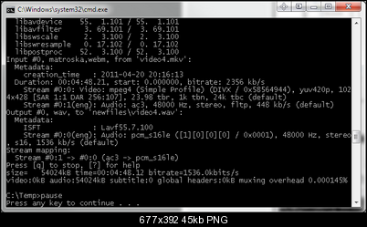

    Convert *.* files to wav audio
    for %%a in ("*.*") do ffmpeg -i "%%a" "newfiles\%%~na.wav"
    pause
