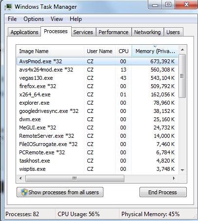

  4. 8-9x faster is significant, but it still seems a bit slower than it should be on that computer (which google says is a I7-920), and it says 56% CPU usage on the screenshot so you have some slack/idle cycles

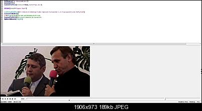

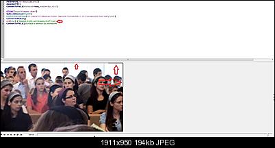

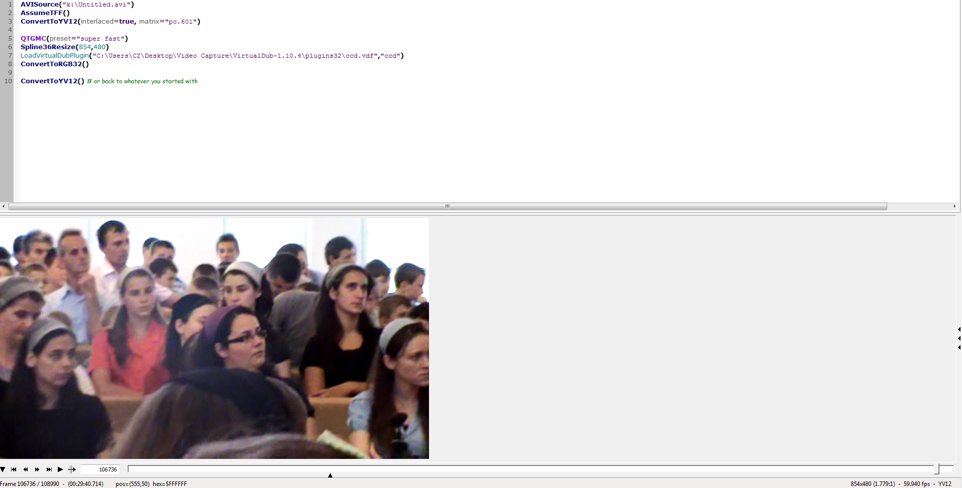

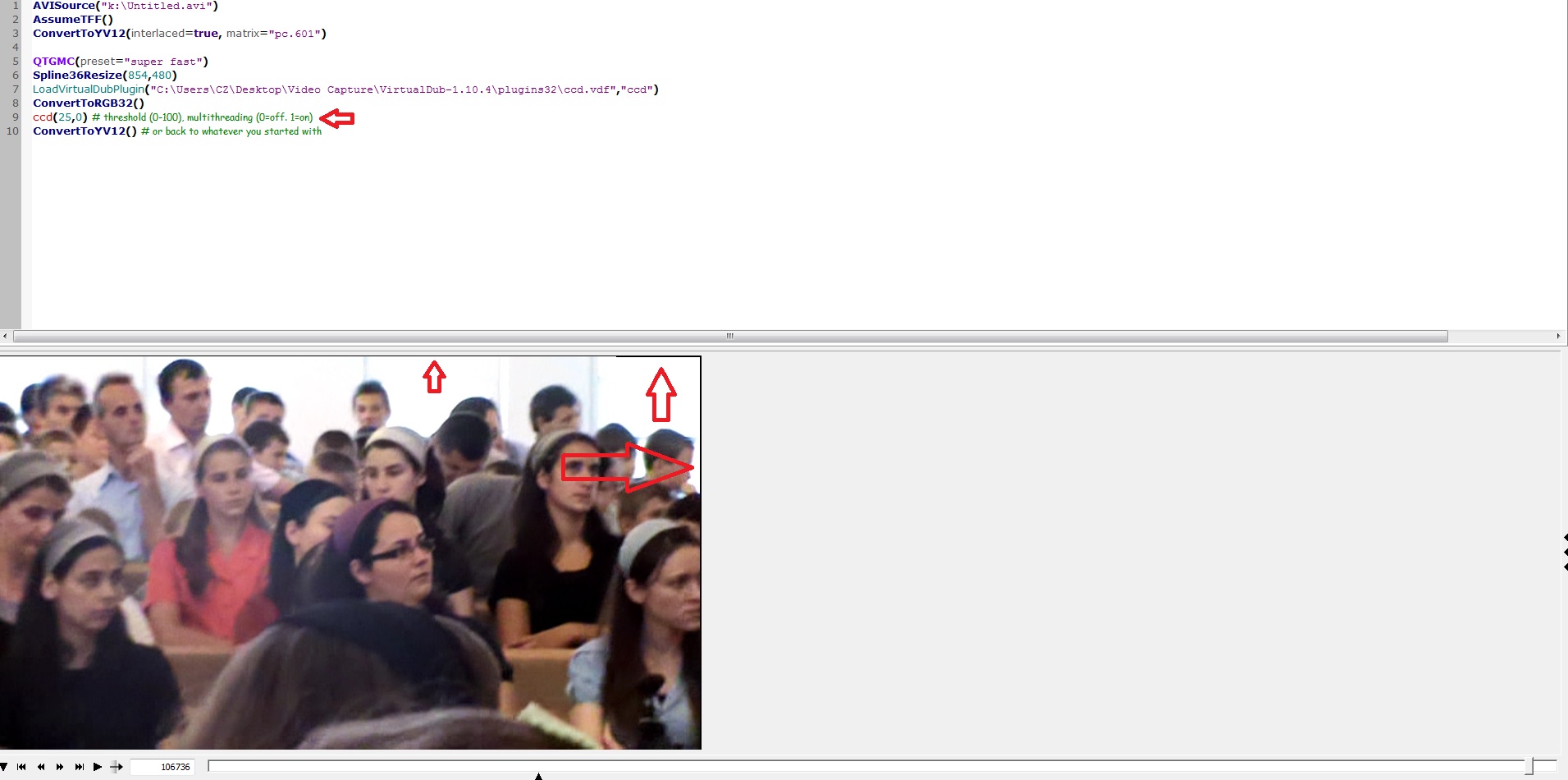

  10. Hello PDR, was hoping you could help me out with a similar problem like this thread first began on, but now having to do with ccd.vdf and Avisynth. I don't remember if it was you that first pointed me to using ccd.vdf over here to get rid of my blue/yellow spots.
    I'm frameserving out of Vegas into Avisynth, and when I add an instance of ccd.vdf that I need, it adds these black little inside borders on half the picture. Regardless of the value(s) entered. I went to a frame with a white background so it would be viewed more easily.
    Original:
    ccd.vdf added:
    I don't understand why this is happening and it doesn't make any sense. As you can see, a thin black inside border is added along the top of the picture. Then overlapping it on the right hand side is an upside down L shape thicker black line. I don't even know what could cause this. And yes, they are present in the final exported files as well exactly as displayed.
    Neat Video would be another learning stone for me and I just want to get the effect that ccd.vdf's "25" percent value gives me, exactly that, and now it's all here and perfect but these black borders appear from out of nowhere. Ever seen anything like this?
  11. Not sure, I don't really use ccd .
    But here are some observations:
    But if I take a random 854x480 video, it pads to 856x480 afterwards if you notice the dimensions. Some filters require mod 8 or mod 16 dimensions, but usually not ones that work in RGB, usually only ones that work in 4:2:0 subsampled YUV . But I can replicate what you are seeing with a 854x480 input. A 848x480 (mod16) input doesn't exhibit that issue . So you might move the Spline36Resize(854,480) step later, after ccd , since you were starting with a mod16 video from vegas IIRC
  12. ccd messes up with mod 2 frame sizes. Change it to 852x480 (mod 4) or 856x480 (mod 8) and the problem goes away.

  14. But if I take a random 854x480 video, it pads to 856x480 afterwards if you notice the dimensions. Some filters require mod 8 or mod 16 dimensions, but usually not ones that work in RGB, usually only ones that work in 4:2:0 subsampled YUV . But I can replicate what you are seeing with a 854x480 input. A 848x480 (mod16) input doesn't exhibit that issue . So you might move the Spline36Resize(854,480) step later, after ccd , since you were starting with a mod16 video from vegas IIRC
    Thanks, it's now the last step in my script and that fixed it, hopefully it'll come out alright.
    Thanks, if PDR's fix doesn't work in the final export then I'll do this. I'll stick with 854x480 because that was the direct resize I ended up needing in this thread for these videos.

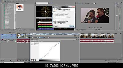

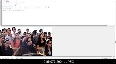

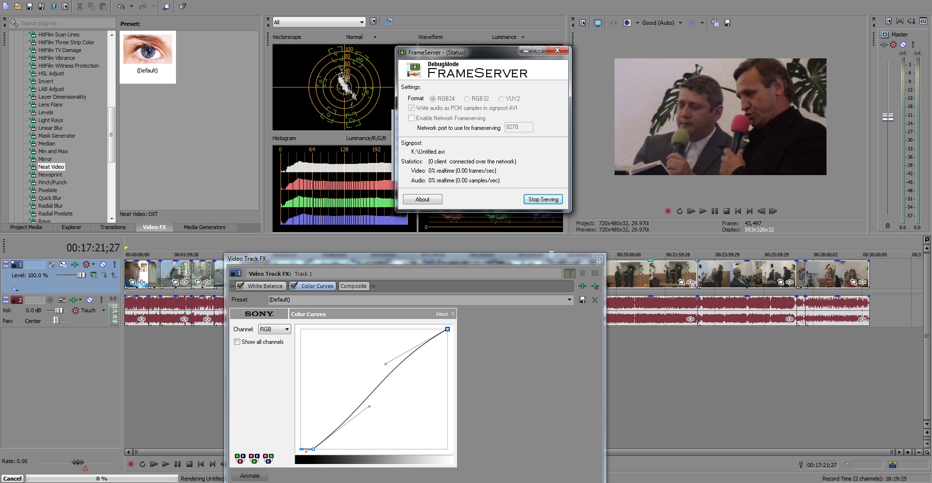

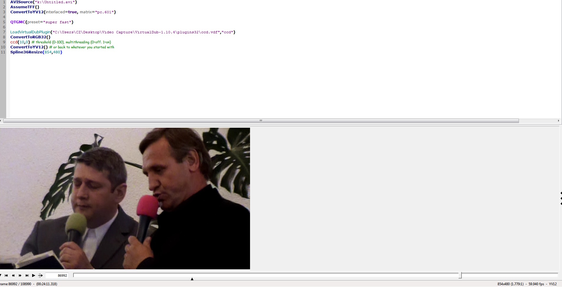

  15. Sorry for the quick post back, but I just discovered another problem that comes out of using Avisynth (or in this case, AvsPmod). When I frameserve into it, it makes the picture overall darker and/or crushes blacks in some instances beyond belief. I took out every step besides the basics one by one and none of them changed the fact. I haven't noticed this til now when I decided to give a recent final video a watch all the way through.
    What you see in Vegas, can clearly see the details in the suit:

    Inserted into the script, everything in the suit is now one big black shape:

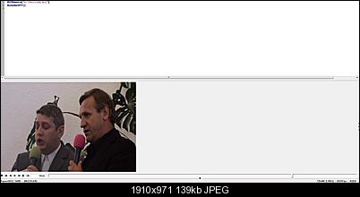

    Now if I erase everything from ConvertToYV12(interlaced=true, matrix="pc.601") and on, the colors are back to normal and the suit isn't crushed...so I'm assuming it's something to do with this code being wrong. What's wrong with this part over here..? Anyone have any idea? I was only using this instance of the code because someone recommend it to me, but it looks like there's something it does wrong to my videos in the end.

  16. You can use Rec601
    ConvertToYV12(interlaced=true, matrix="rec601")
    But that shouldn't be right if you had 8 bit project in vegas with studio RGB sources like native camera clips. For those projects, PC.601 is correct . I don't know how you have vegas setup
  17. Woah, well that actually fixed it, you did it! Can you explain why this was the case? I mean they are native camera files and I never changed any of the Vegas defaults for things like this, I wouldn't even know where to look to be honest. But everything should be fine now I suppose from what it looks like.
  18. Did you have something like a levels studioRGB to computerRGB filter or vice versa applied anywhere in the project ?
  19. The only other things added to it other than what you see in the AvsPmod screen are what you see in the Vegas screen, White Balance and Color Curves (where you see it say Channel: RGB in it's setting..?) applied to the entire video track as 1 instance rather than to each individual clip.
