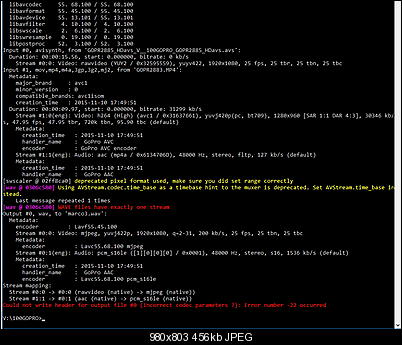

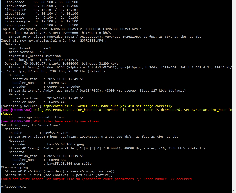

  9. Code:
    ffmpeg.exe  -y -i  VIDEOsource.MP4 -i AUDIOsourceX.MP4 -map 0:v -map 1:a -vcodec mjpeg -shortest -af apad -c:a pcm_s16le marco3.wav
    don't work because of this
