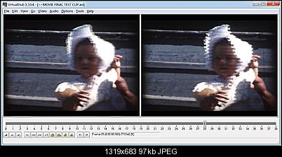

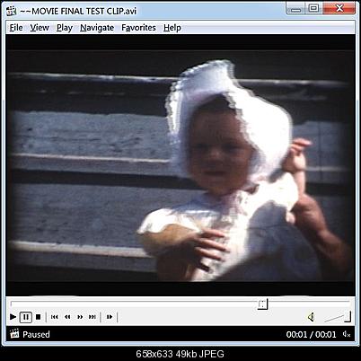

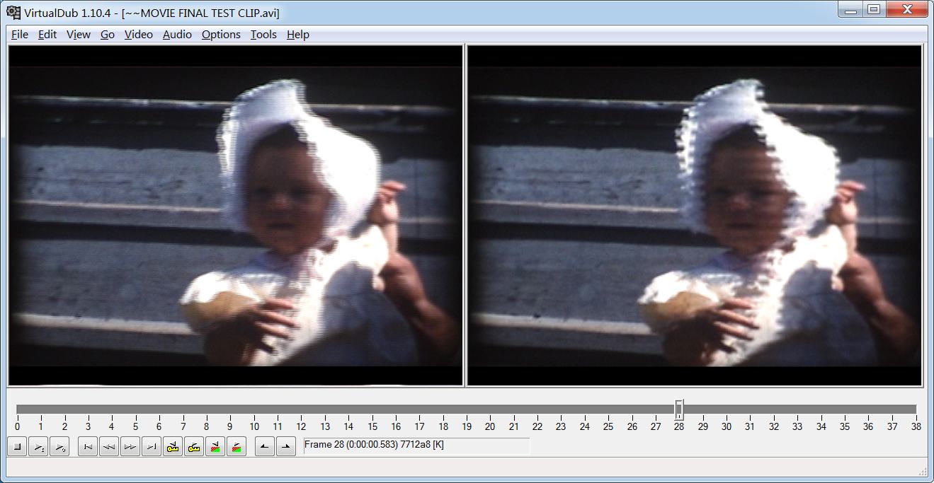

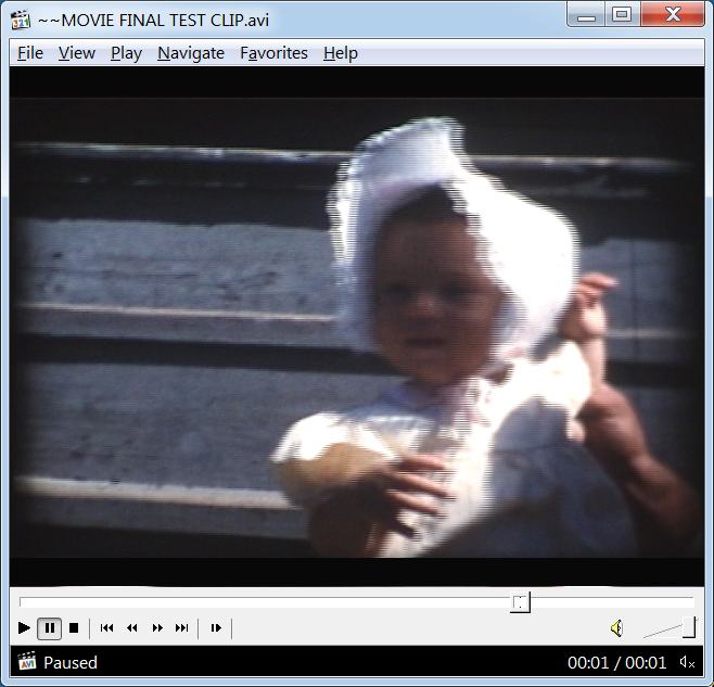

    Not it's not. Pause the video while it's playing and you'll see artifacts like:
    Those are different than the artifacts in your first post (because of further processing by Nero) but they are the root of your problem. The fact that opening your AVI in VirtualDub and applying the bob doubler filter shows the same artifacts as your first post proves the above artifacts are in you AVI file.
    Use a screen magnifier if you have to. Or use VirtualDub's zoom option on the source pane.

    That film was projected at about 20 frames per second then recorded by the camcorder as 29.97 interlaced frames per second.
    You could simply encode that video as interlaced MPEG 2 and burn it directly to DVD. My guess is if you import the AVI into Nero it will handle it correctly when it makes a DVD. Almost all editors know how to handle DV AVI.
    If you want to convert it to all progressive video in AviSynth you need something like:
    AviSource("OrigClip.avi")
    ConvertToYV12(interlaced=true)
    QTGMC(preset="fast") # or the faster, not as accurate Yadif(mode=1, order=0)
    SRestore(frate=19.98) # eliminate blended and duplicate frames
    That will leave you with progressive frames which can be encoded with 3:3 pulldown flags for DVD. But I think the video needs to be slowed to 16 or 18 fps to get natural motion. Rates that low can't be burnt to DVD with soft pulldown, they'll need hard pulldown, or duplicate frames.
    There are also some aliasing problems and other issues that you might consider fixing. Once the video has been restored to progressive frames (ie, after SRestore()) you can address those if you want. For example
    QTGMC(preset="fast") # or the faster but less accurate Yadif(mode=1, order=0)
    Spline36Resize(width/2, height)
    Spline36Resize(width*2, height)
    Gets rid of most of the aliasing.
