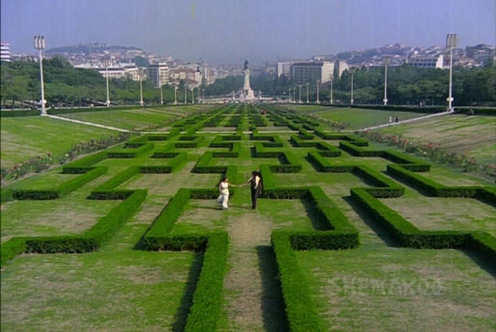

    Hello!
    I'd like to ask if there's any possibility to remove the transparent logo like below
    because I tried virtualdub then rm_logo avisynth but didn't work, thanks in advance!

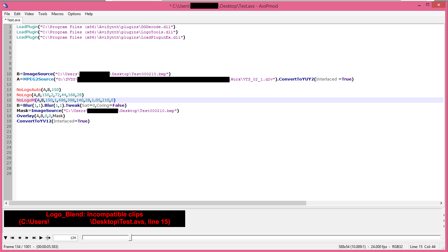

  12. I don't use AvsPMod and just saying it crashes tells no one anything. Is there an error message? Have you tried opening the script in VDub? And always post the complete script. If you didn't get the RAR file of all needed DLLs I recently posted in a different thread, I'll enclose it here.
  13. Member TeNSoR's Avatar
    Mar 2014
    Hungary, Debrecen
    Yes, I tried to open it in VDub but gave me error message like this :
  14. Your BMP also has to be converted to YUY2. You shouldn't run three different instances of NoLogo at the same time. Use one at a time and put a '#' in front of the other two so they are disabled. I would temporarily also disable all the other lines below the delogo line you're using, at least until you get a working delogo line. Also, you might have to use the LoadPluginEx2.dll, instead of the LoadPluginEx.dll. Once you get the other problems sorted out and the script still doesn't work, try switching to the other DLL.
    Study the sample script I included in the package. I hope 150 is the frame number used for the BMP and that the logo is surrounded by black. If you use one of the other two at some point (NoLogoM, used correctly, will produce the best results), you'll have to adjust the crops for your logo, and the other settings as well.

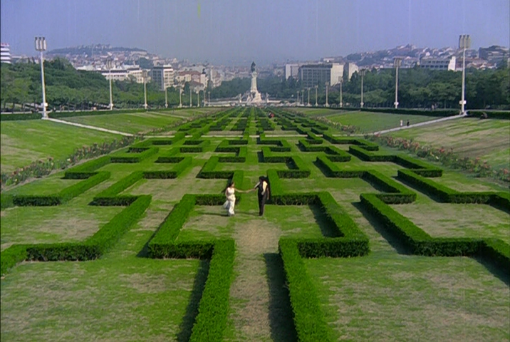

    Before and after :

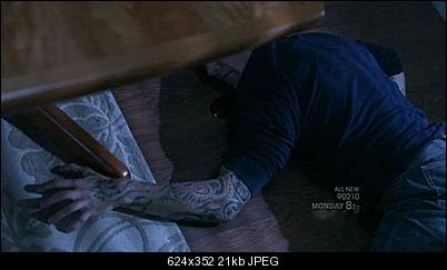

    Original:

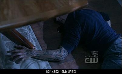

    InPaintFunc(mask="D:\logo.bmp", loc="420,276,-104,-16", speed=20, mode="InPaint", ppmode=3)
    InPaintFunc(mask="D:\logo.bmp", loc="420,276,-104,-16", speed=20, mode="InPaint", ppmode=2, pp=0)
    rm_logo(logomask="D:\logo.bmp", loc="br", cutwidth=420, cutheight=276, mode="InPaint", percent=100, AlphaToRepair=190, pp=1)

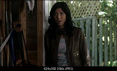

    Same scripts as above. There's text above the main logo but for this video it only appears for a few of minutes in a couple of places, so I didn't bother trying to remove it. If you look at the InPaintFunc screenshot the text was apparently used for painting the logo area, but for the RM_Logo screenshot it wasn't. That's a good thing.... but I don't quite understand why.
    Original:

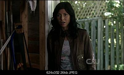

    InPaintFunc(mask="D:\logo.bmp", loc="420,276,-104,-16", speed=20, mode="Inpaint", ppmode=3)

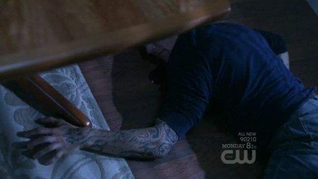

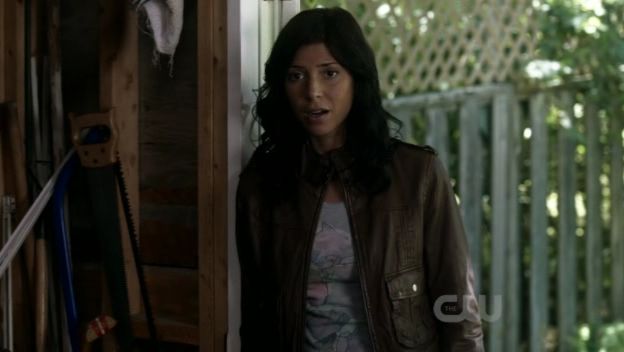

  23. I've been using InPaintFunc a bit myself, but it's RM Logo I've been playing with the last few days and now I've managed to get it to work, I think I'm preferring it. There'll be times when InPaintFunct will probably be easier to set up, but when it comes to movement behind the logo, Rm Logo seems to do a little better in the "don't put wobbly stuff where the logo used to be" department.
    It's still there. It just doesn't stand out as much.
    InPaintFunc(mask="D:\0601.bmp", loc="420,276,-104,-16", mode="InPaint", Speed=20, ppmode=0)
    rm_logo(logomask="D:\0601.bmp", loc="br", cutwidth=420, cutheight=276, mode="InPaint", percent=100, AlphaToRepair=185, pp=1)

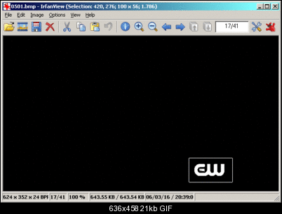

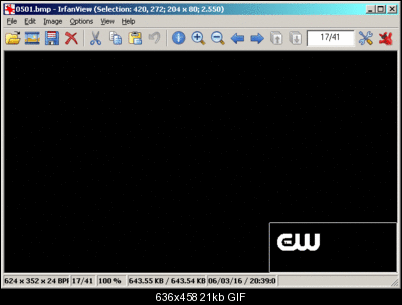

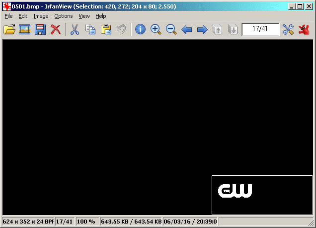

  25. It seems cutwidth=420 and cutheight=276 from my previous RM Logo scripts wouldn't have been what I used for those samples. Not that it makes a difference to the outcome. I guess that's what I get for copying and pasting.
    I'm pretty sure if you set loc="br" the width is from the right side and the height is from the bottom. I just draw a square around the logo down to the bottom left corner using Irfanview and it displays the dimensions in the title bar.
    Like this..... so I think cutwidth=204 and cutheight=80 would do it. If you add Debug=True to RM Logo's options and open the script in a media player you'll be able to check the logo isn't being cut off, and it's also useful for adjusting the AlphaToRepair setting after RM Logo has run an analysis. InPaintFunc has a similar option, Show=True

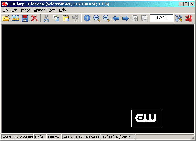

    For InPaintFunc you can specify the logo area more exactly, but it's in a format where it's the distance from the left, top, right and bottom, and the area specified must be mod4 (100x56 in the example below). I'm not sure if the mod4 limitation applies to RM Logo. There may be an easier way to work it out, but I just draw a square around the logo and use a calculator.
    The image is 624x352.
    624 - 420 - 100 = 104
    352 - 276 - 56 = 20
    So you end up with:
    loc="420,276,-104,-20"
    Every time I have to work it out I think I should try to find an easier way.
