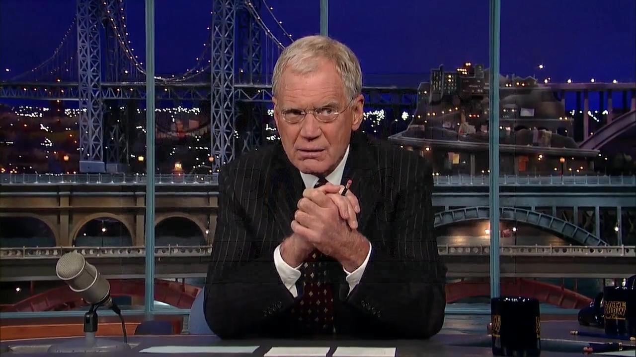

    Original screenshot: [IMG]i.imgur.com/KSHlwQn.jpg[/IMG]
    First I replaced transparent(low opacity) logo part to red [IMG]i.imgur.com/OdRYNR7.png[/IMG]
    Outcome : [IMG]i.imgur.com/WrWfiZR.jpg[/IMG]
    But still, it doesn't look like it's supposed to look, it should have barely see-able edges of the logo, but this method just blurred the logo.

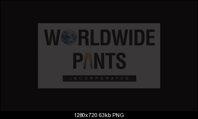

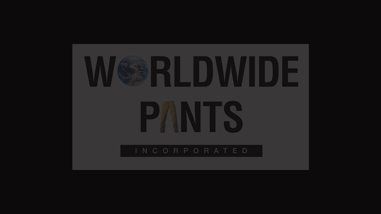

    Maybe. Can you provide a sample where the watermark is over a black background?

  7. Here is the logo on a black background
Name:	July 19 2011.mp4_snapshot_00.20.05_[2015.06.23_13.55.14].png
    I read some DeLogo removal guides. I painted the logo (opacity 50%) parts red and removed everything else that didn't had any parts of the logo over it, saved as transparent PNG, but it didn't work.. Also tried to paint logo white with opacity 60% this kinda worked on Sony Vegas with some blending modes and 'Sony Levels' effect on main video, but still wasn't as good as in the tutorials..

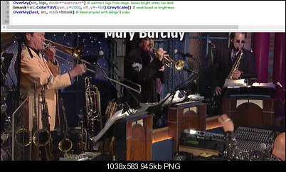

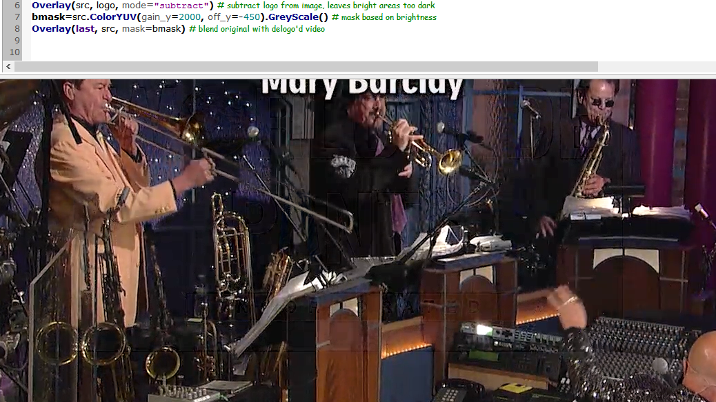

  8. Script using only built in AviSynth functions:
    logo = ImageSource("logo.png").ConvertToYV12()
    src=ImageSource("pic.jpg").ConvertToYV12()
    logo=logo.ColorYUV(gain_y=-50, off_y=-20) # adjust logo levels
    Overlay(src, logo, mode="subtract") # subtract logo from image, leaves bright areas too dark
    bmask=src.ColorYUV(gain_y=2000, off_y=-450).GreyScale() # mask based on brightness
    Overlay(last, src, mask=bmask) # blend original with delogo'd video
    The script needs to be adjusted for a wider range of the source video.

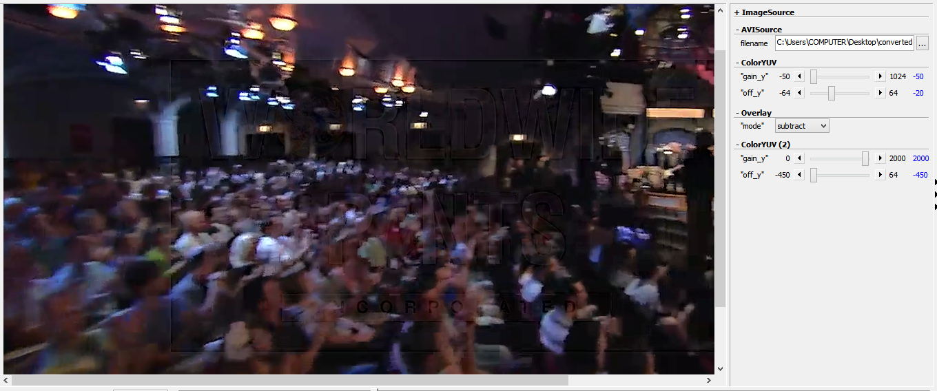

    wow that is perfect.. I have never used AviSynth, I'm gonna try it now..
    I replaced src=ImageSource() with AVISource() and the video is green with logo over it..

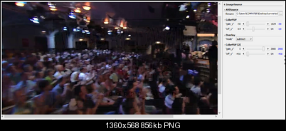

    I also had to convert audio from quicktime's AAC to MP3 otherwise AviSynth shows:
    No compatible ACM codec to decode 0x00FF audio stream to PCM.
    Finally it's kinda working after converting everything, but on darker backgrounds there are visible parts of the logo, maybe because of the heavy conversion that was done.. Is there any more parameters that I can use for removing the logo completely ?

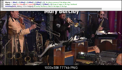

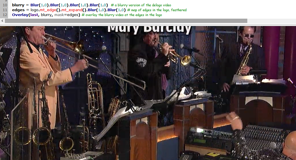

  14. Originally Posted by aquax View Post
    You can play around with gamma_y in ColorYUV() for the bmask. I don't think that will help much because the problem appears to be more around the logo letters, not within them.
    You could try blurring those areas but I think the blurring will be too obvious. Add this to the end of my previous script:
    blurry = Blur(1.0).Blur(1.0).Blur(1.0).Blur(1.0)  # a blurry version of the delogo video
    edges = logo.mt_edge().mt_expand().Blur(1.0).Blur(1.0) # map of edges in the logo, feathered
    Overlay(last, blurry, mask=edges) # overlay the blurry video at the edges in the logo
    You'll need masktools2 for AviSynth.

    Thanks for this too, a little improvement is noticeable..
ID:	32294Click image for larger version

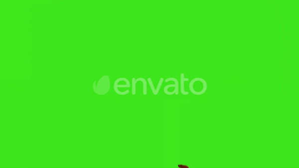

  21. Is there any newer solution to this issue?

    Seems interesting but I don't know the first thing about using AviSynth, I tried it earlier on with LogoTools and it wouldn't work because I had certain missing dll files. I then tried VirtualDub with both logoaway and MSU logo removal but neither of those solutions worked, they just created a very blurry gif. For reference, ill link what I'm trying to edit the logo out of. Any solutions for my specific issue?Image
    [Attachment 61494 - Click to enlarge]

    Originally Posted by Super7077 View Post
    Should be easily removable with InpaintDelogo, I guess on that website you can find various images with same logo, if you'll find same logo on black background then it should go away without a trace.
