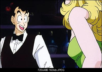

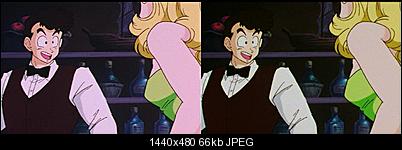

    I tried some quick white balance adjustments in AviSynth:
    ConvertToRGB().RGBAdjust(r=0.85, b=0.88, rb=3, bb=-8).ConvertToYV12() # reduce pink cast
    Tweak(sat=1.2) # increase saturation
    ColorYUV(cont_y=20) # increase contrast
    That worked pretty well for many shots (before/after):
    Note how the guy's shirt and eyes are now white. Skin tones look batter. The girl's hair looks a little too greenish. Leaving a little more red in the picture would make the shirt a little off white but the hair would look more yellow.

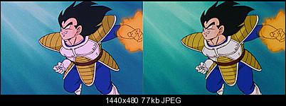

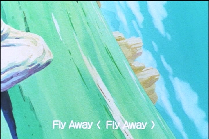

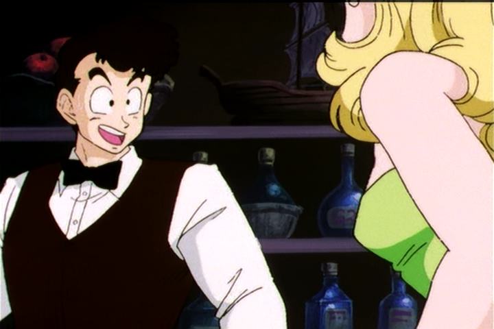

    The sky in later shots turns greenish rather than blue:
    Maybe it's supposed to be greenish.

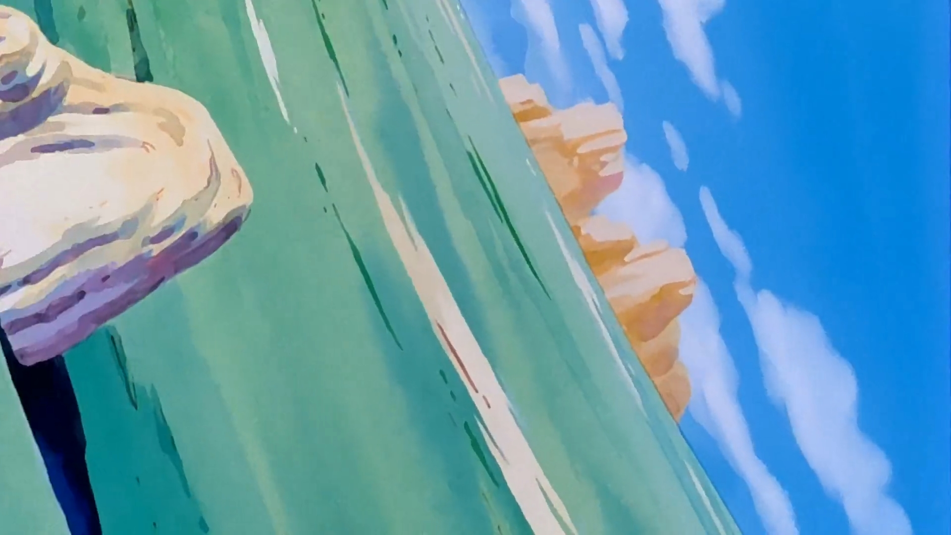

    Though, for the second screenshots, I don't think it's supposed to be greenish.
    I just encoded the same episode from the Orange Bricks (these are 16:9 and I don't think they have the same color problems as the Dragon Box)
    Goku vs. Vegeta (CRF 22, None) - orangebrick: http://files.videohelp.com/u/246075/30%20-%20Goku%20vs%20%20Vegeta%20(CRF%2022_%20None...rangebrick.mkv
Name:	CRF22. None - orangebrick.jpg
Name:	CRF 22 None orangebrick2.jpg

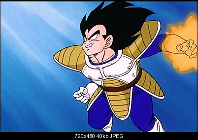

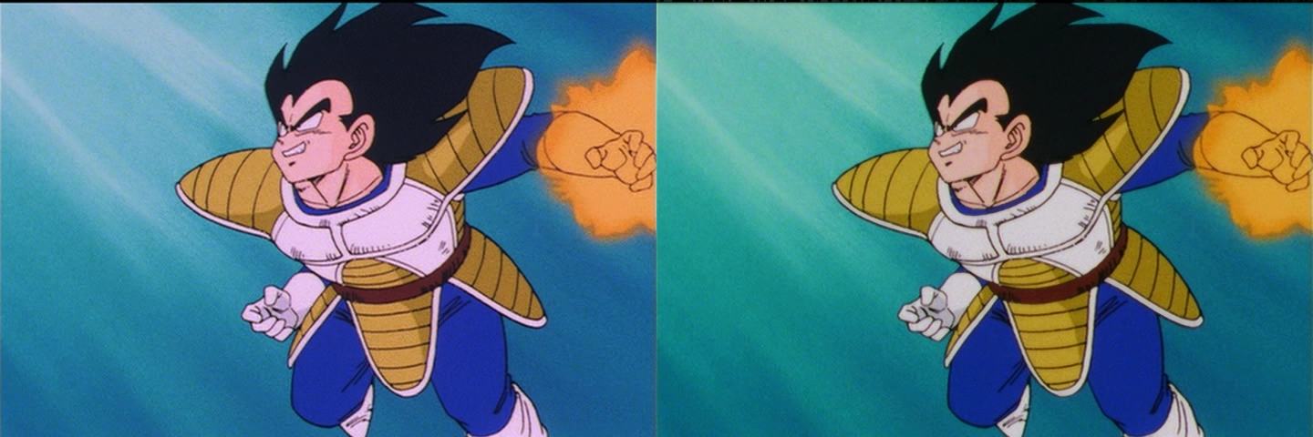

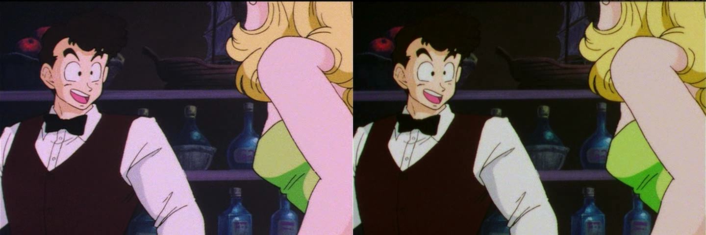

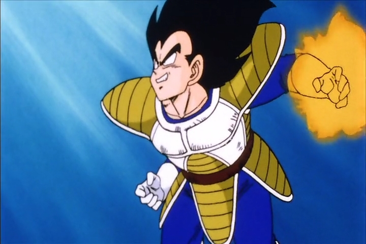

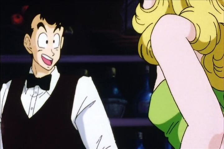

  9. Here's something that more closely matches your latest images:
    LWLibavVideoSource("Goku vs. Vegeta (Source).mkv")
    src=last
    blues = ColorYUV(cont_y=0, off_y=-10).Tweak(hue=-15, sat=1.2)
    uvmask = Overlay(UtoY().ColorYUV(off_y=-128).ColorYUV(gain_y=256), VtoY().Invert().ColorYUV(off_y=-128).ColorYUV(gain_y=256), mode="multiply").ColorYUV(gain_y=15000).Blur(1.0).Spline36Resize(width,height)
    ConvertToRGB().RGBAdjust(r=0.88, g=0.98, b=0.90, rb=3, bb=-8).ConvertToYV12()
    Tweak(sat=1.1)
    Overlay(last, blues, mask=uvmask)
    ColorYUV(cont_y=105, off_y=24)
    dehalo_alpha(rx=1, ry=3)
    TemporalDegrain(SAD1=200, SAD2=150, sigma=8)
    I added a hack to keep blues rather than shifting them to green. Purples are still off in some other scenes.

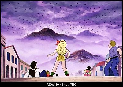

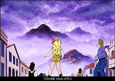

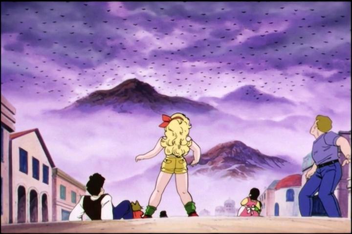

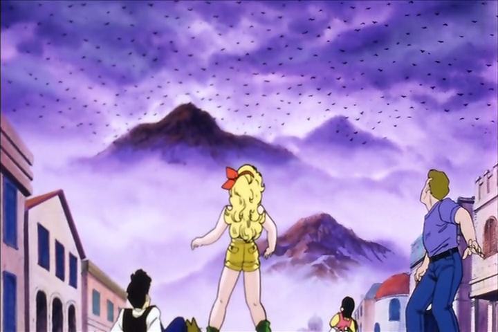

  14. Here's an example where purples are still off:
    orangebrick:
    off:

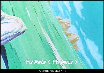

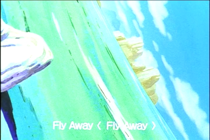

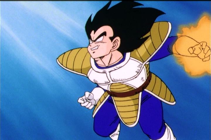

  15. Is there a way to simply color match the two sources?
    It looks noticeably worse here:

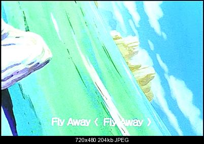

    After applying your script
Name:	CC CRF 22.jpg
    I also have the DragonBall Z bluray collection and this is the source I would like to color match with the Dragon Box:
  16. Yes, I know there would be some problem shots where colors similar to the sky colors wouldn't turn out right. This type of color correction is very hard to do in AviSynth. You would be much better off with a good video editor.
  17. What video editor would you recommend for this?
    I'm thinking about using Avid Media Composer (there's a 30 day free trial), and there's a lot of tutorials on YouTube.
