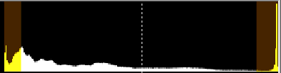

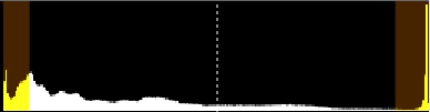

  11. It looks like the problem lies with PP interpreting the file correctly. Using the Histogram tool in Avisynth (thanks, jagabo for the tip), this is the input video using the following code:
    Coring=false
    AVISource(V,false).AssumeFPS(30000,1001).AssumeBFF()
    [Attachment 35991 - Click to enlarge]
    As can be seen there are lots of superblacks and superwhites in the the video. Now, if I transcode the above using ffmpeg:
    ffmpeg -i in.avs -c:v copy -an out.avi
    And load the out.avi using the exact same avs script above, I get the following histogram which is still full range.
    [Attachment 35992 - Click to enlarge]
    However, when I load out.avi into PP, the vectorscope in PP is clamped at 7.5 IRE. I did notice that PP has trouble interpreting the video correctly and thinks it is progressive for some reason.
    I need to run some additional tests, but I am fairly confident at this point that PP is the problem.

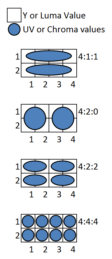

  17. FWIW, I made the following to help me visualize what is going on with the different YUV colorspaces.
    [Attachment 35994 - Click to enlarge]
