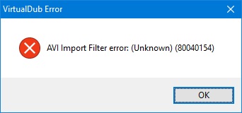

    This is what I get when I try to open an AVS file in VirtualDub:
    :S

  19. Originally Posted by LifeDream777 View Post
    [Attachment 36088 - Click to enlarge]
    :S
    Did you install Cedocida like I mentioned? Loading a DV AVI in Avisynth using AviSource() is easy if you have a suitable VfW decoder installed on your system.

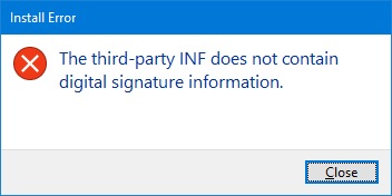

  21. Anon45
    Guest
    I did, and I get this error:

  25. Originally Posted by LifeDream777 View Post
    [Attachment 36089 - Click to enlarge]
    Sounds like a Windows 8 problem. What OS are you using? Search the web as there are workarounds.
    Windows 10.

  30. Originally Posted by LifeDream777 View Post
    Windows 10.
    Uh oh. I have avoided the nagging Windows 10 upgrade message for this very reason. Hopefully, someone on this forum has resolved this issue on Windows 10. But if you have the ability to roll back to Windows 7, you'll find that you will be able to get much better answers to your questions, as that is what most of us still use for the very reason you cite above.
    Alternatively, try avspmod instead of Virtualdub. I find avspmod tends to work when vdub fails.
