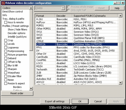

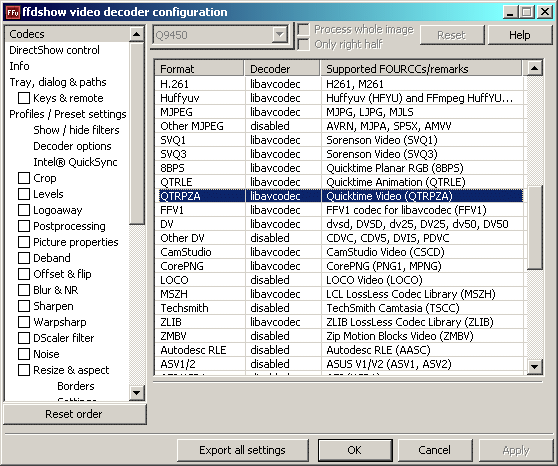

    LAV Filters and ffdshow are capable of decoding multiple video and audio types and each type can be enabled or disabled individually. ffdshow can decode Quicktime video. I don't know if LAV Filters can.
    MPC-HC, MPC-BE, SMPlayer, Potplayer, VLC etc all have "internal" codecs and don't rely on installed "system" codecs, although some can use either.
    I don't use Windows 7 but you might need this for some 3rd party codecs:
    https://www.videohelp.com/software/Preferred-Filter-Tweaker
    I use MPC-HC and I also have ffdshow installed because I use it's audio decoder instead of LAV Filters (so I can run a compressor DSP). In the case of MPC-HC if you disable an internal filter (ie a particular audio or video type) it'll look for a DirectShow codec instead (in my case ffdshow). Re-enable the internal filter and it'll stop using the DirectShow codec.
