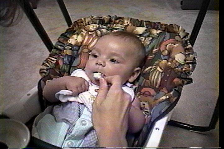

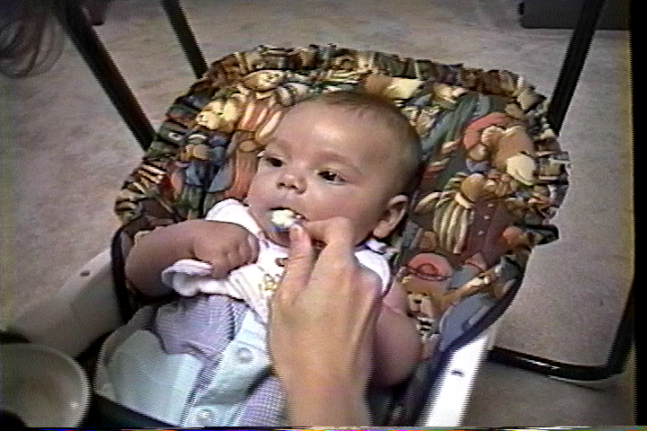

  1. This post is a follow-up to my recent attempt to optimize digitizing a collection of Hi8 home videos. See https://forum.videohelp.com/threads/376934-Requesting-Feedback-on-3-Hi8-Video-Capture-Samples. I decided to make a comparison between lossless and DV AVI capture. For lossless capture, I am using a Hauppauge USB-Live 2. For DV AVI, I have a Sony MiniDV (DCR-TRV38) being used in pass through mode and a Canopus ADVC100. Based on the recommendations made to responses from my previous post, I acquired a Hi8 camcorder with S-video out and line TBC (Sony CCD-TRV608). I am using VirtualDub for the capture software. For lossless, I am using the HuffyYUV codec. I have attached a short video clip making a comparison of lossless with TBC Off, lossless with TBC On, DV AVI MiniDV pass through and DV AVI Canopus ADVC100. The Sony CCD-TRV608 has a DNR setting which I left off. The TBC was also turned off for DV AVI capture.
    Lossless TBC Off:
    https://forum.videohelp.com/attachment.php?attachmentid=35812&stc=1&d=1456102414
    Lossless TBC On:
    https://forum.videohelp.com/attachment.php?attachmentid=35813&stc=1&d=1456102414
    MiniDV pass through:
    https://forum.videohelp.com/attachment.php?attachmentid=35814&stc=1&d=1456103112
    Canopus ADVC100:
    https://forum.videohelp.com/attachment.php?attachmentid=35815&stc=1&d=1456103112

    Originally Posted by VideoDoc View Post
    I do not appreciate any difference with line TBC
    There is a big difference.
Name:	VideoDoc CCD-TRV608 -TBC, USB-Live2.png
ID:	35867 Click image for larger version
Name:	VideoDoc CCD-TRV608 +TBC, USB-Live2.png
    Having said that, the CCD-TRV608 is oversharpening. Its output here looks a lot less natural than your CCD-TRV32 captures. Knightmessenger in your other thread pointed out that your other camcorder is actually Video8, not Hi8. Were all your tapes recorded using this Video8 camcorder?
    I have found that my Digital8 model oversharpens my Video8 recordings, too.
    In particular, I find the horizontal lines with motion much more visible with the lossless capture. Line TBC did not seem to improve this which I was most trying to accomplish.
    What are you using to view the captures? If you're using a typical PC video player, the DV captures will be deinterlaced for display and the lossless captures won't be. Obviously you will see more interlacing in the lossless captures, then.

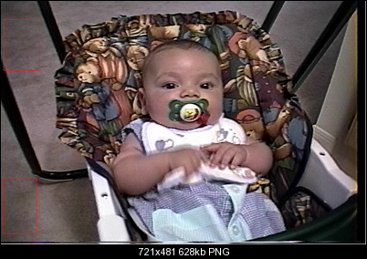

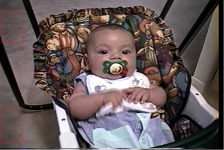

    Thank you very much for taking a look at the additional clips I provided. To start with, I stand corrected. The CCD-TRV32 is Video8 and not Hi8. This is an embarrassing mistake on my part. I appreciate Knightmessenger for bringing it to my attention. The 8mm tapes I am trying to convert are a collection from several family members. One used a Hi8 cam which apparently has been lost. Mine is the Sony CCD-TRV32. My in-laws used a Canon ES400VA which is also Video8. After doing some research, I have concluded that the video clip I have provided is from the Canon. I still have access to this cam but it does not have S-video out or line TBC. I agree, I much prefer the color and sharpness produced by my Sony Video8. Unfortunately, it also does not have S-video out or line TBC
    I am actually viewing my video on a Samsung plasma set but streaming through a HTPC I recently built and using a program called OpenELEC. I am just now starting to learn the settings on this program. I assumed it was automatically de-interlacing but discovered I was wrong. When I set the de-interlace setting from AUTO to ON, I immediately appreciated the big difference with TBC that you demonstrate in your captured pic. I have now fixed my interlace artefact problem and my line TBC seems to be working.
    Yesterday I sat my family down and showed them extended clips of the three capture approaches I am analyzing (now properly de-interlaced). So far, everyone (including myself), picked the Sony MiniDV pass through capture approach. When I asked why, most felt that the lossless capture looked too "grainy". Exploring this at higher zoom, my lossless capture seems to definitely have more "noise". A lot of this "noise" seems to be due to rapidly oscillating vertical wavy lines. Although this is best appreciated in real time, I have tried to demonstrate it in the picture below.
    By comparison, my Sony miniDV seems to be doing a pretty good job of suppressing a lot of this noise. Any suggestions on how I can improve on this with my lossless capture?

    It's a small gripe, but I would prefer if you didn't quote entire posts, particularly those that include images.
    For what it's worth, the spatial field placement of the second Sony capture is "wrong". One line is cropped from the top, and a bottom black line has been added. To maintain bottom-field-first, the temporal placement has also been changed (each frame starts one field "earlier"). This inconsistency seems to be common across Sony's Digital8 line, and I guess it happens with their MiniDV products too.

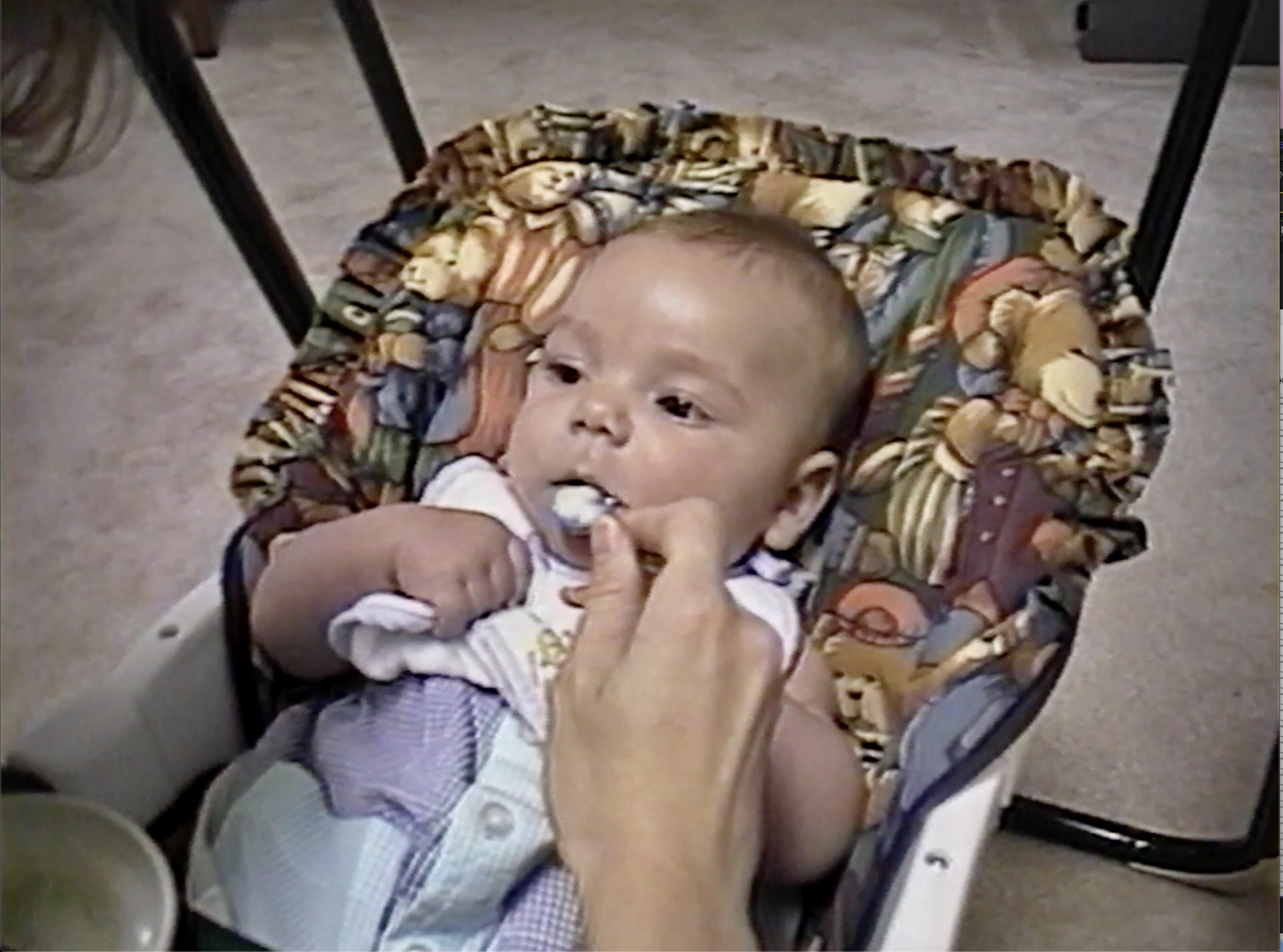

    One way to improve on it with post-processing is simply by downsizing the width and then upsizing back to the original. (Do not resize the height.) No consumer analog tape format actually contains 720 "pixels worth" of detail, and the high-frequency noise is what's most visible.
    AVISource("Sony CCD-TRV608 to Hauppauge TBC-ON DNR-OFF.avi")
    LanczosResize(400,height).LanczosResize(width,height) # Arbitrarily-chosen downsize width. A different resizer may be preferable.
    This is the same frame as above but with the resize script, so compare:
Name:	VideoDoc CCD-TRV608 +TBC, USB-Live2 + resize-400w.png
    You could also try lowering the Sharpness control of the USB-Live2. I have no idea whether it's at neutral by default. I wouldn't necessarily suggest using it to add blur, though. It probably isn't limited to the horizontal direction.
    Last edited by Brad; 25th Feb 2016 at 23:37. Reason: Ninja edit to remove typo removed by VideoDoc's edit!

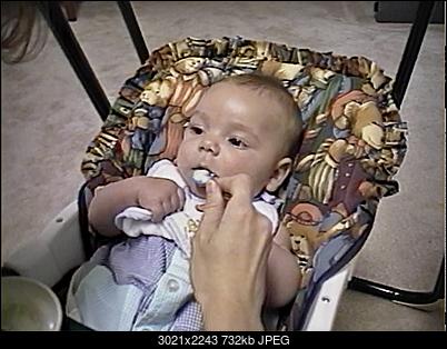

    So this is really interesting. Old thread and you are probably done your project by now but am attempting the same thing with my Sony TRV608.
    So unfortunately when you share files through the internet it's a lossy transfer obviously on my end so you get noticeable pixelation. I usually get way better result if the capture was made in high definition as this is at 480 resolution so I have more to play with. However believe it or not, the video you are looking at is the Sony CCD-TRV608 to Hauppauge TBC-ON DNR-OFF. For some reason when I put the file into UniConverter and convert to an MP4, the lines completely disappear. I then changed the aspect ratio to standard 3:4, and brought up the saturation a lot, and fiddled around with the brightness and contrast until it looked good to my eyes but of course that is also subjective and that could be changed further in post process to your liking.
    It would have looked a lot better if the original file was higher resolution as I upscaled it to 1080P for editing purposes which pixelates it if it's not the same resolution. So to make an accurate representation of what it could look like shrink the window size down really small. Also as you can tell the exposure on the original video was too dark so it's obviously a dark video. I didn't want to try and correct that because it starts to blow out the whites as you can see. Also ignore that screen shot is pixelated. Anyways just thought it was an interesting observation. My favorite is the raw s-video capture as I can visualize more detail. Honestly that is why I am a big believer in using the source that captures the most detail and not worrying about gamma, contrast, and ratio which can be altered later in post process.
    Sony CCD-TRV608 to Hauppauge TBC-ON DNR-OFF Edited.mov
