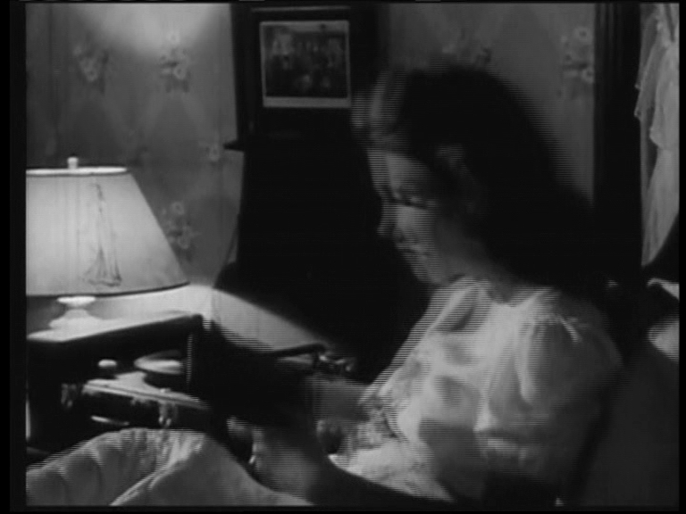

I have a PAL DVD (25 FPS) with interlacing problems. I don't know what the real problem is. Frame blending? Ghosting? We can see the effect in the capture when the girl moves.
[Attachment 35760 - Click to enlarge]
I want to know how to deinterlace the video with an Avisynth script (maybe with plugin Srestore, but I don't know how to use it)
Any help would be appreciated

Yadif(Mode=1)###or the better QTGMC
Srestore()
But it doesn't do all that good of a job as there's just a massive amount of field-blending in it. -

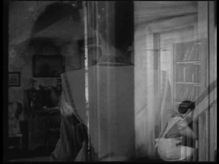

Let's go with another situation, a transition.
On the image we can see two shots at the same time (due to the interlace, this is not a dissolve. You can see
it on the original "video3", frame by frame):
[Attachment 36082 - Click to enlarge]

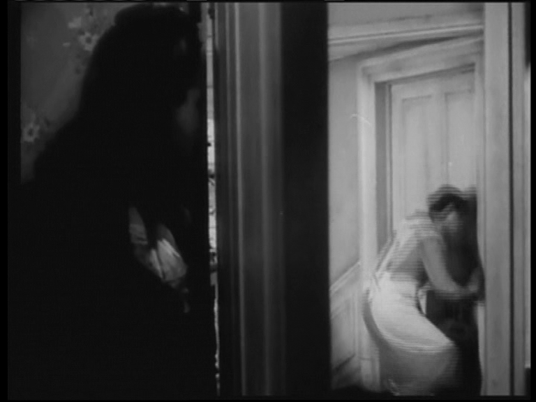

And, of course, there is a massive amount of ghosting when the woman moves:
[Attachment 36083 - Click to enlarge]
We can see "the double woman" better here:
[Attachment 36084 - Click to enlarge]
With the other situation, the girl on the bed, the script I used is almost good:
But now is almost useless. Do you have any other ideas on how I could improve it? (of course, I know it is probably impossible to remove the ghosting effect 100%)Code:Mpeg2Source("C:\VIDEO\VIDEO3.d2v", CPU=6, Info=3) Load_Stdcall_plugin("c:\AviSynth\plugins\yadif.dll") Yadif(mode=1, order=1) SRestore(frate=23.976, thresh=35) McTemporalDenoise(settings="very high") -
You'll get blending at scene changes even if the script otherwise works pretty well.
Something like this added after the SRestore line:
A=Last
prev = A.selectevery(1,-1)
next = A.selectevery(1,1)
SCclean = A.SCSelect(next,prev,A,dfactor=2.0) # 2.0 ~ 5.0
return(SCclean)
Works to FreezeFrame the blending, but it will do it on both sides of the scene change, whether it's blended or not. And it might do it from time to time elsewhere as well. Unless you're willing to go through the video frame-by-frame (as I do), you may as well not even worry about it.
To work, the code above needs the RemoveDirt.dll.
Your source has way too much blending for any unblender to remove it all. About all you can hope for is that it plays smoothly.
