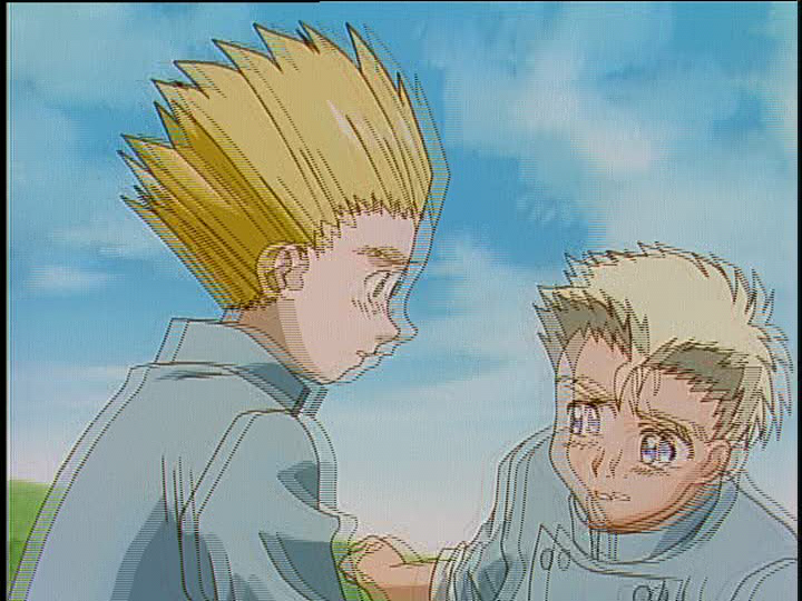

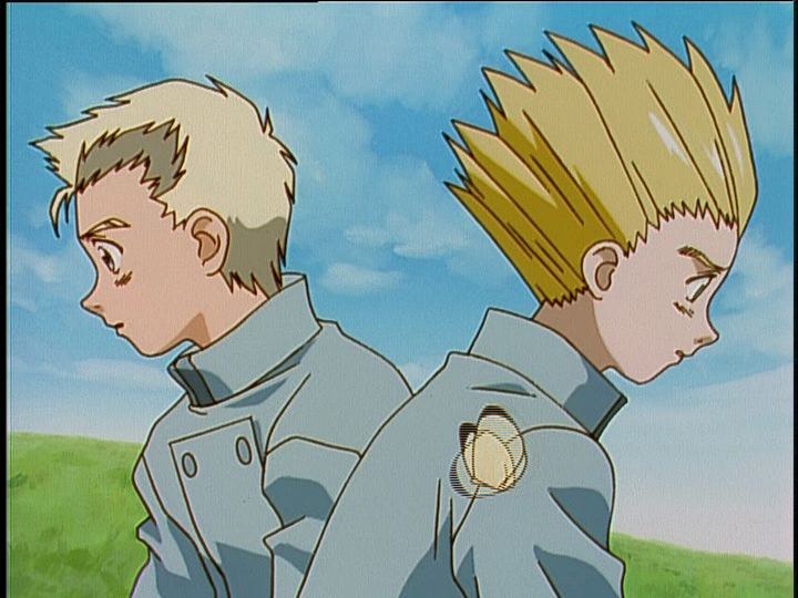

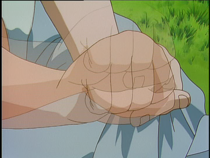

    Here's a few pictures of what I'm talking about:
    Both of them
    The Fist
    The Butterfly
    I thought it was interlacing at first. I spoke to a friend and he said it seemed to be frame blending, but he said you normally get that on badly converted PAL DVDs. He didn't know what to do to the footage, but suggested to come to this wonderful forum and ask here.

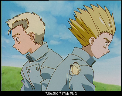

  5. Image
    [Attachment 22452 - Click to enlarge]
    Not using AviSynth here.
    Reply if you are happy with this output.
