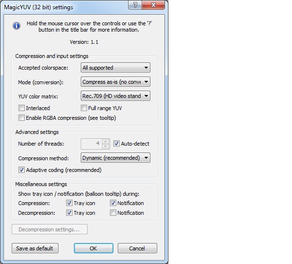

    In VD looked at MagicYUV settings and it gives option to use Rec601 SD or Rec709 HD
    Can I leave it set to rec 709 without impacting my 'set levels', or do I need to set to Rec601 to maintain that.
    Leave everything set to auto. It will actually be RGB if you 're exporting from vdub and deshaker. Rec709/601 don't apply when everything is in RGB. It only applies to YUV<=>RGB conversions. It will hand off RGB to vegas , and vegas works in RGB internally as well. Ideally you would export an RGB format too, but most final distribution formats are YUV and 4:2:0 (YV12) . It those steps in between where RGB<=>YUV conversions occur that potentially bad things happen, like levels shifts, color shifts etc.. so you want to keep conversions to minimal

    There is no Auto stetting ... only option to select Rec.601 or Rec.709.

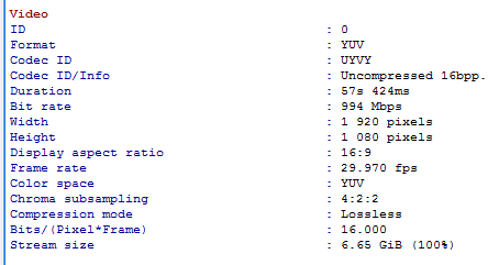

    Current files are in YUY2 at the end of Deshaker process.
    A typical mediainfo for one of them is attached.
    I could leave it in YUY2 and not do the change to YV12 .... was only doing that as end file will be in YVY12.
    So based on where I am now ... want to save in MagicYUV .... any steps I should take, and do I set Rec.610 (sort of assumed this would be the case)

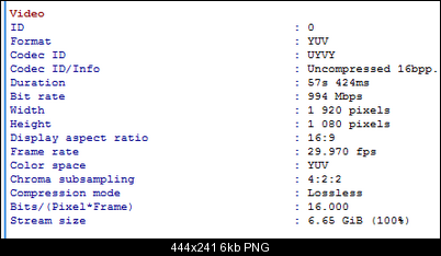

  11. aBigMeanie aedipuss's Avatar
    Oct 2005
    666th portal
    not sure which one you've used but the sony yuv i use in vegas is 4:2:2 lossless

    I could use MagicYUV ........... if so do I set it to Rec601 SD or Rec709 HD ... I know the comment was leave everything set to auto ... but there is no 'auto' setting for color matrix. assuming it should be Rec601 but wanted to check.
    Here is pic of the settings:
    [Attachment 35764 - Click to enlarge]
  26. You're supposed to use 709 for HD. But the setting is irrelevant coming from canpous YUY2 - there is no matrix used because your output is going to be YUY2 and your input is YUY2. It only applies for YUV<=>RGB conversions. Mouse over the option and the tool tip pretty much says the same thing. Unlike UTVideo, Magic YUV does not have a separate fourcc distinguishing 601 or 709 . But even in the case of UT Video, most of the time it's ignored anyways - the host application just does whatever the hell it wants to do (sometimes they use 601, sometimes 709, sometimes something else). So again, the recommendation is to do a quick test for colors because vegas doesn't treat lossless YUV codecs as YUV
