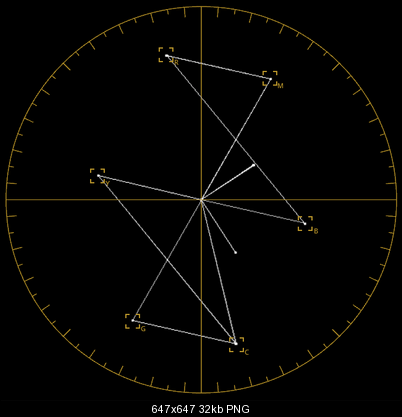

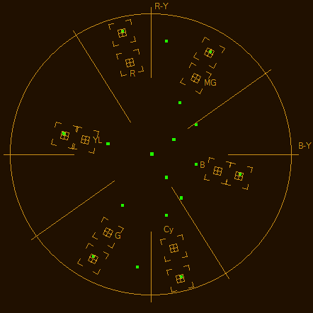

    5. Import in PP. Now, be advised that PP doesn't interpret the UYVY footage encoded from either vdub or ffmpeg correctly. In my case, I have to force PP to interpret the footage as progressive. When you look at the vectorscope of your UYVY bars, you should see the following:
    [Attachment 37361 - Click to enlarge]
    Now you may say, "Wait a minute. What are all those extra dots on my scope?" Well, let's look closely starting with the Red and Magenta dots. If you draw a line between them, you will see that there is a dot exactly in the middle of that line. That dot represents PP's chroma resampling from YUV 4:2:2 to RGB 4:4:4 for display. Since there is only resampling in the horizontal direction, only the vertical boundaries are effected by the rescaling. If you go through the exercise of drawing lines on the scope between each color pair that border one another vertically, you will find a dot at each mid point. This also explains why there is no dot between Yellow and Green, Red and Yellow, and so on: because those borders don't exist. Also, these chroma resampling artifacts only exist for display purposes. Internally, PP will not resample unless it is required when exporting. Which brings us to our final step for a lossless pathway through PP.

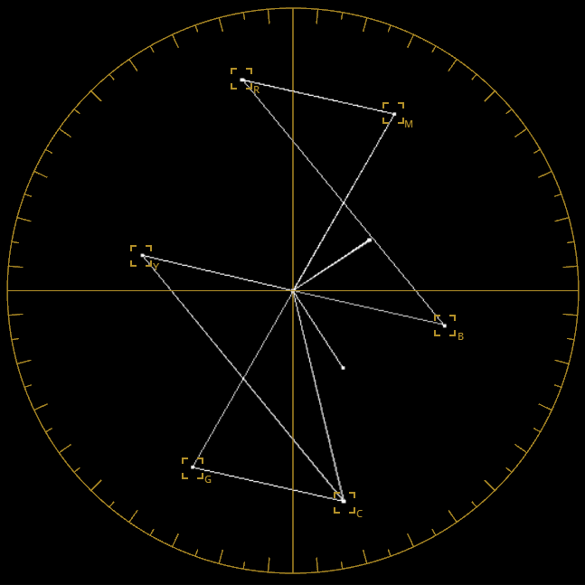

  19. I am posting a workflow for transcoding to ProRes using ffmbc. Turns out that ffmpeg/ffmbc have a persistent bug related to swscale that hard codes the RGB->YUV conversion to the Rec.601 colorspace even for HD content. This results in a huge color shift. Additionally, ffmbc 0.7rc8 has some precision/performance issues while 0.7rc7 32-bit uses a much more precise conversion. The result is a very clean vectorscope especially since there is no chroma subsampling (see below).
    Workflow:
    1. Start with the ColorBarsRGB.avi attached in post #121
    2. Using ffmbc 0.7rc7 32-bit
    >ffmbc -i ColorBarsRGB.avi -threads 16 -color_primaries bt470bg -vcodec prores -profile hq -b 220000k -pix_fmt yuv444p10 -an ColorBars444.mov
    Comments:
    The -color_primaries flag somehow bypasses the Rec.601 encoding. For some reason, encoding to yuv422p10le, even with the -color_primaries flag, results in a color shift, even if I use the ProRes444 transcode as input. So, I haven't yet figured our a way to transcode to a ProRes 422 format without incurring a color shift.
    I have attached below my ProRes 444 colorbars for anyone who might need them.

  30. This is what AE says the dynamically linked PP generated SMPTE tone and bars RGB values are:
    Grey: [191,191,191]
    Yl: [191,190,0]
    Cy: [0,191,190]
    G: [0,191,0]
    Mg: [191,0,192]
    R: [191,0,1]
    B: [0,1,192]
    -I: [0,63,105]
    +Q: [65,0,119]
    W: [255,255,255]
    Bl: [0,0,0]
    Left pluge: [0,0,0]
    Center pluge: [0,0,0]
    Right pluge: [10,10,10]
    Technically, the pluge is supposed to be -4,0,4 IRE, but -4 gets clipped in RGB space. Also, don't worry that the colors don't appear exactly right, for example, that R is not [191,0,0], because both collapse to the same 8-bit YUV value as do the others.
    So, yes, they are 75% saturation (191/255 = 75%); otherwise the vectorscope will look wrong.
