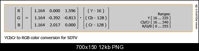

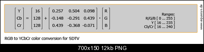

  7. The equations used for the RGB -> YUV conversion are not the source of the lossiness. If you use floating point arithmetic throughout, you can always recover the original RGB values no matter what equations you use. This implies (from a mathematical proof concept) that the source of the lossiness is the 8-bit rounding applied in YUV space. Do I actually need a full 32/64 bits (even floating point arithmetic is not infinite precision)? Of course not. But a rigorous mathematical proof is not necessary here and neither is a Matlab demo. Most who closely study the example I provided will easily prove to themselves what is going on and not require a Matlab demo. Mathematical proofs are so mathematicians can talk to each other. Conceptual examples are much more useful for a forum.
    Since the equations are of such interest I will post the link that I used.
    http://www.equasys.de/colorconversion.html
    But few programs do any matrix math as shown in the link (Avisynth may be the rare exception from what I have seen). Rather they employ LUTs which are far faster computationally. My guess is all the trickiness lies in the LUT used. For example, 10 bit LUTs that are not truly 10 bits.
    I remain open to correction should anyone produce a set RGB values that cannot be recovered. But at the end of the day, this will just imply one needs to move up to 11 or 12 bits. TBH, I am not sure what all the controversy is.

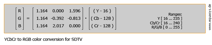

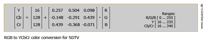

    I already said that was the problem with the low precision matrices given at http://www.equasys.de/colorconversion.html. And as I indicated, with the higher precision code I posted all 16 million colors survived the round trip intact.
  25. But I was trying to point out that I don't think the problem is due to low precision in the initial matrix. I recover all RGB values, using only the 3 sig figs from the link for the initial matrix coefficients. This is why I stated earlier that it doesn't matter what coefficients you use in the initial matrix. It all comes down to how much precision you retain in the intermediate calcs i.e. the inverse matrix. Maybe this wasn't obvious before. Also, it goes without saying that if you truncate versus round to 8-bit values, you will have problems. And as pdr stated above, the valid range of 10-bit YUV doesn't extend all the way to 1,023. So multiplying by some number >4 to fully utilize the 10-bit YUV range is moot. But I did check to truncate to inside the valid range if a YUV value went outside it. But apparently none did because I didn't have any problems.
  26. Once again, I used the low precision values from equasys:

    Otherwise the code was the same as the code I posted. About 5500 colors did not survive the round trip. I just checked the values in the code, they all matched, there were no typos. I've tested with two different x86 compilers.
  27. Great! We are finally on the same page. I was able to mimic your workflow in Rec.601 space, and similarly, I did not recover about 5000 RGB triads from 10-bit space. But, here is the problem. As I have been saying, the YCbCr to RGB (bottom) matrix is not precise enough and slightly sparse. Maybe that is OK in 8-bit space. But, if you invert the RGB to YCbCr (top) matrix by hand and retain enough precision, you will recover all RGB values from 10-bit space. Try using these coefficients (mine are double precision and go out a little farther). As you can see, the zero elements are not truly zero even, hence the problems.
    1.164144354	-0.001788898	 1.595786205
    1.164144354	-0.391442764	-0.813482069
    1.164144354	 2.017825510	-0.001245839
    In summary, there is nothing wrong with using only 3 sig figs in the top matrix (assuming you don't have out-of-gamut problems). The key is retaining enough precision in the intermediate calcs including the inversion matrix.
  28. I did a little more research, and here is the deal. The RGB to YCbCr matrix should be built from defined Kr and Kb constants. These constants are specified to a max of 4 sig figs (I have never seen values with more precision). Referencing the matrix values is confusing. I initially built my matrix off of Kr and Kb but got twisted off from them thinking they weren't right. Time to get back on track.
    It is only when you maintain floating point precision in the initial matrix that some inversion matrix elements collapse to zero. If you round the initial matrix elements to three or four sig figs, the inversion matrix elements no longer collapse to zero (as shown in my post above). But, that is not a problem necessarily because, at this point, the initial matrix is still only functioning as defined constants. Constants can contain any number of sig figs without affecting precision (accuracy may suffer but don't confuse this with precision). Therefore, whether you maintain full precision in the initial matrix or round the values, the inversion matrix should always be full precision, or you will lose precision and potentially not recover some RGB values even in 10-bit space. So, while the link I posted was useful, it is clearly for reference only and not meant for programmatic calcs.
    In the future, all this discussion can be avoided by just referencing the Kr and Kb values. Those are fairly well known for Rec.601, 709 and even 2020.
  29. But if you use more precise values in the RGB to YUV conversion you get more accurate YUV values. So it's best to use more precise values for both. Or course it doesn't matter if all your going to do is convert RGB to YUV and back to RGB.
  30. But what does "more accurate YUV values" even mean? Recall that the RGB block in 10-bit YUV space has a volume of ~180 million colors. Therefore, only about 1/10th of the possible values will be used. As long as I can generate unique YUV values for every RGB, then why should I care if I generate YUV[75,512,514] vs YUV[75,513,514] for a given RGB value? I am not convinced accuracy is necessary which was my point above. We are not expanding out the YUV space to 10-bit based on some ITU-R spec. Is there even an "official" mapping defined for RGB24 to 10-bit YCbCr?
