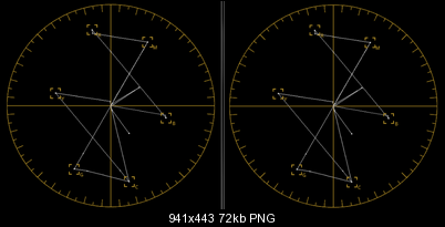

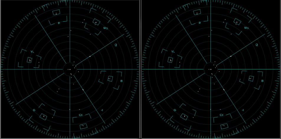

  1. Yes, I put the adjustment layer and level with gamma of 4 or 5 and no visible differences. I also tried clearing the Media Cache in PP, deleting everything out of the project, closing, timelines from scratch, no luck, I can still see the differences. So I am going to chalk this up to a CS6 bug that must not be present in CC, since that is what you are using.
    To be certain, I scoped up the UYVY_INPUT and ffmpeg AVIs in two other applications and could see no differences, although I trust the top scopes more than the bottom scopes. The scope on the left is the INPUT and the right is the ffmpeg.

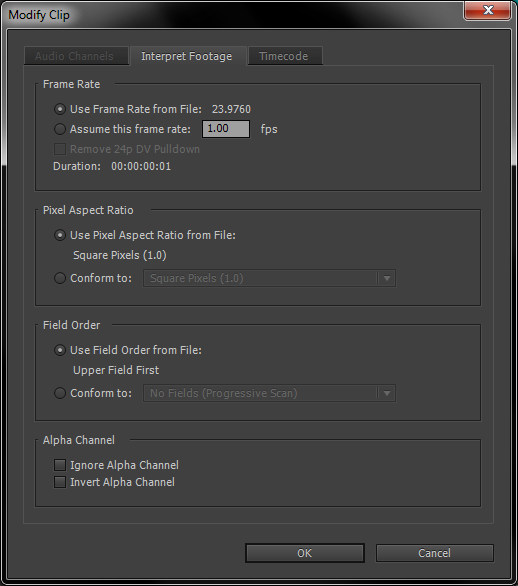

  2. Do you have the file interpretation setup correctly for ffmpeg.avi ? Sometimes PP will "guess" something wrong. It might "think" it's TFF interlaced for example. Just check to make sure it looks right in the file interpretation dialog , progressive, square pixels etc...
    If you've used UYVY_Input and exported using UYVY, then re-imported that export, does it still match (ie. all Adobe) ? If yes, then there is something different in the ffmpeg UYVY version that your version doesn't "like" . Maybe metadata or something. It doesn't make sense that your AE version "sees" them as the same ; if some codec or something installed was interfering, it should affect both. UYVY is the "special sauce" for all windows NLE's in terms of 8bit 422 - it should get that treatment across the board
  3. I AM IN AWE POISONDEATHRAY!!!!! If this site had upvotes or thanks for profiles, I would overload yours with them.
    I went to bed last night dejected and convinced my install was broke, or worse, CS6 was broke. Woke up this morning, still convinced there was no solution. Then I saw your post. I thought, hmm, doubtful, nothing else has worked. Let me check. I clicked on the file interpretation dialog for the ffmpeg.avi. This is what I saw:
    Guess what happened when I changed field order to progressive? You guessed it! All the problems went away!!! I had to change it back and forth several times just to make sure I wasn't dreaming.
    All Hail Poisondeathray! The King of Video!

  5. I don't know why PP doesn't interpret ffmpeg UYVY avi's correctly. Possibly something is embedded in the code on how to handle what might be considered a "legacy" format for video. IOW, the defaults were never updated to include progressive video. The 2 GB file size should not have been an issue because none of my files were ever that large.
    I downloaded v3 above and tried it and the same result: PP interprets the footage as Upper Field First for field order. So setfield=prog doesn't do the trick.
    What I find interesting is that PP CC interprets footage correctly. That leads me to believe it is a bug on Adobe's end. I need to also check that I have the latest update to CS6.
  6. What I meant was Adobe used AVI 2.0 , even for the 1 frame test. So if you tried ffmpeg to generate a >2GB file, it should switch over to AVI 2.0 (not sure if it does, but some software does). Or you can direct stream copy in vdub and it will re-wrap it to AVI 2.0 . Just to test if that is the culprit
    Also maybe try uninstalling Drastic codecs , in case that is interfering somehow (do 1 thing at time, test AVI 2.0 first)

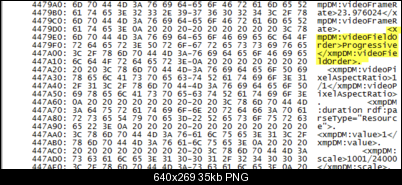

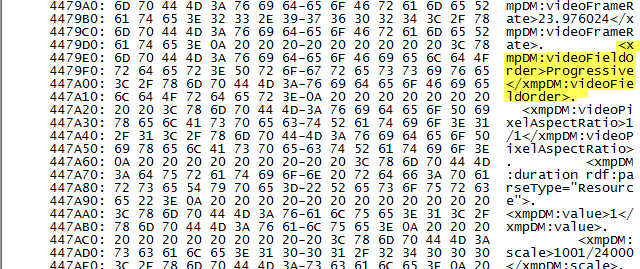

  24. I found the progressive signalling metadata with a hex editor. Adobe uses XMP. No easy way to implement that in ffmpeg or vdub
  25. Good stuf, pdr, as always, You are the king. I hadn't forgotten about this thread. I just got busy trying to get L-SMASH to work and decided to rebuild my system from scratch. I finally got things working again, and I can report that loading the ffmpeg.avi UYVY into Avisynth using LWLibavVideoSource("ffmpeg.avi", format="YUV422P8") vs AVISource() or RAWSource(), then opening that in vdub and saving as an AVI with the Color Depth output set to UYVY, is INDEED lossless and Adobe interprets the file correctly.
