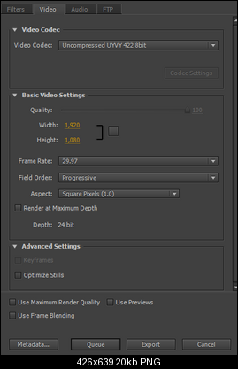

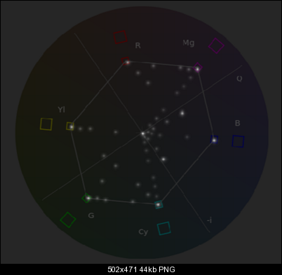

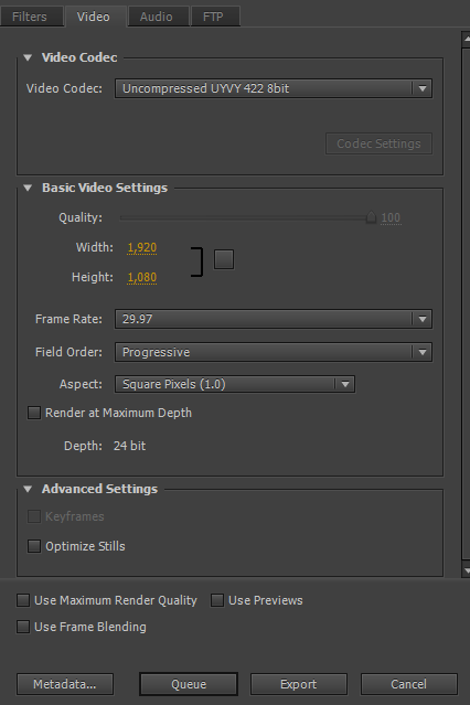

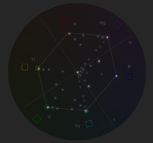

  21. Thanks, yes, I think I have it sorted out now. For the video color depth, I chose 4:2:2 YCbCr (UYVY) for both Decompression and Output and ran the following code:
    ColorBars(1920,1080,pixel_type="YV24")
    ConvertToYV16(chromaresample="point")
    Trim(0,149)
    Exported this from vdub as an AVI, brought it into PP, and it is the cleanest vectorscope I have seen so far. So that is progress. However, if I export this from PP as UYVY, the borders smear although the colors are stationary. Exporting as V210 is even messier. But here is the strange part, Mediainfo looks identical for the YUV422 source and UYVY export. Are you able to find a lossless path that I am missing?

  22. borders smear? make sure you setup the sequence settings and export settings properly (1920x1080, progressive , square pixel etc...)
    BTW You only need 1 frame to test ( trim(0,-1) would have sufficed)
  23. Originally Posted by jagabo View Post
    ColorBars(1920,1080, pixel_type="YV24")
    PointResize(width/2, height/2).PointResize(width,height) # force all transitions to even boundaries
    ConvertToYV12(chromaresample="point")
    Using ConrtToYV16 now. I tried inserting the PointResize line and compared it to the one without the PointResize line and there is a strange and rather large colorshift.
  24. Originally Posted by poisondeathray View Post
    Yes, borders smear. Sadly, as far as I can see, I have everything set properly in my sequence setting and export settings (1920x1080, progressive, square pixel). Here is a screenshot:

  25. Also check your sequence settings. I don't have CS6 installed right now but there are several places where UYVY can be found. It shouldn't matter but check under "uncompressed AVI", there should be another UYVY version.
    Just so we are on the same page, here are 3 videos
    UYVY_INPUT.avi was generated from internal PP colorbars, UYVY as output. This is the "source video" now. You could have used the avs script to generate the UYVY source, but it's unclear from me what pathway you used in vdub, so I'll take vdub out of the equation for now . I want you to use this as your input video
    ffmpeg.avi was generated from UYVY_INPUT.avi with
    ffmpeg -i UYVY_input.avi -pix_fmt uyvy422 -c:v rawvideo -an -vtag "UYVY" ffmpeg.avi
    UYVY_OUTPUT.avi was generated from either re-importing UYVY_INPUT.avi or ffmpeg.avi and exporting UYVY again .
    You can do this a million times and get the same thing . It's not a version issue, because UYVY pass through worked since at least CS4 - I've posted about this many years ago
  26. Thanks for those. OK, I switch over to AVI (Uncompressed) and chose UYVY from there. Not sure if it makes any difference though. And yes, I am able to find lossless pathways through UYVY exports from PP. In fact I can generate the exact same vectorscope as your included files. However, you do realize that the ffmpeg.avi file that you included is not exactly the same as the UYVY_INPUT and UYVY_OUTPUT right? In fact, I was able to replicate all your videos precisely. According to my vectorscope, the ffmpeg pathway is not lossless. It is close, no color shifting, but the boundaries shift. Now, if I take the ffmpeg video and push it through ffmpeg again, that is a lossless path. But starting with either UYVY_INPUT or UYVY_OUTPUT is not.
  27. Originally Posted by SameSelf View Post
    ffmpeg.avi is the same . You can test and verify with the other methods. Maybe something is corrupted with your install ?
    If you put both videos in after effects, set the top layer to "difference". Add an adjustment layer, add levels effect, set the gamma to 2 or something high, what do you see ?
    UYVY_INPUT.avi
    ffmpeg.avi
  28. Hmm, well now I am even more baffled. You are correct. When I bring the footage into AE and do as you said, I see pure black. But in PP the borders clearly move. I don't even need the vectorscope to tell me something changed. This is baffling beyond comprehension.
  29. Did you do the adjustment layer, with levels in AE ? Because tiny differences won't be seen with just plain differences. You need to amplify the differences.
    Try clearing the media cache and do the comparison again in PP, starting from re-importing (sometimes when "weirdness" happens, Adobe can mix up cached versions of files)
  30. But you said the Adobe exported UYVY version worked ? Ie. you can import/export with Adobe all day long no problems and get the same vectorscope result? Sometimes there are incompatibility versions with ffmpeg/ffmbc with some software - sometimes it's the header or AVI container differences. For example Resolve is very picky about those types of things
