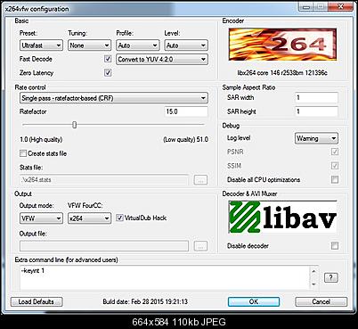

    Have installed x264vfw in VD - never used it before .. and there are a lot of options ….
    I have seen that I should aim for
    • High Profile
    • 2 consecutive B frames
    • Closed GOP. GOP of half the frame rate.
    • CABAC
    • Variable bitrate.
    • Chroma subsampling: 4:2:0
    I have set as per the following (found a youtube video on this codec)
Name:	x264vfw settings.jpg
    Couple of questions …….
    Files will be going into Vegas .. eventually to be rendered out with Sony AVC/MVC which I’m advised is the best H264 option in Vegas.
    # Vegas is happy to accept x264vfw files onto timeline, is there any benefit to converting wrap to mp4 first ?
    # The mention of B frames & GOP … where/how do I set these ?
    # And in general what is the difference on the settings :
    Preset , Tuning, Profile & levels drop down options ?
    Or is there a configuration guide somewhere to explain this ?
  2. Originally Posted by Tafflad View Post
    Click on the "?" symbol in the bottom right hand corner of the configuration window to check the settings you have selected, and then refer them to a parameter list like this:
    http://www.afterdawn.com/guides/archive/x264_options_explained_page_2.cfm
    ....to check out what does what.
    (You don't need to set your CRF setting as low as 15 - you'll simply make the files bigger for no extra visual quality. You're unlikely to need less than 18 - probably slightly higher- for encoding standard def footage..)
