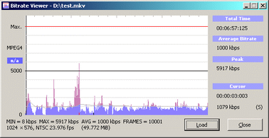

    BTW, I'd tend to disagree with the earlier accuracy claims regarding the encoder hitting the target bitrate. It's rarely 100% exact, but in my experience it's generally pretty accurate. Maybe it depends on the encoder. Some versions of Xvid were broken in that respect, but the internet wasn't littered with 350MB AVIs by accident. AutoGK gave me the requested file size countless times. If it missed, it was generally only by a megabyte or three.
    As a quick test (I do very little 2 pass encoding these days) I encoded the first 1000 frames of a video I had handy (1024x576) with x264 while specifying a bitrate of 1000kbps. According to Bitrate Viewer I got exactly 1000 kbps. I'll confess though, if I wanted to burn an encode to disc, I'd allow a few MBs for a margin of error.
