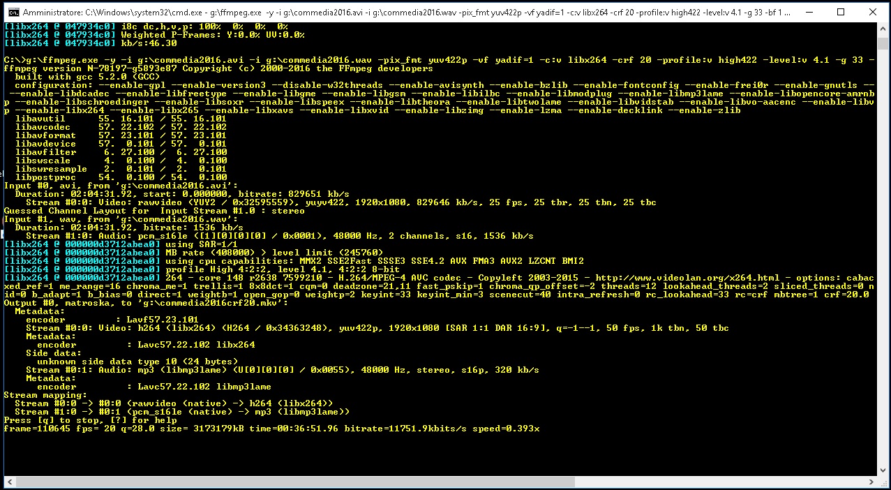

at the moment I use this commandline to encode 2 hours of HD video, but the speed of encoding appear too slow.
Is there a way to get more speed of encoding? thanks
Code:ffmpeg.exe -y -i g:\commedia2016.avi -i g:\commedia2016.wav -pix_fmt yuv422p -vf yadif=1 -c:v libx264 -crf 20 -profile:v high422 -level:v 4.1 -g 33 -bf 1 -c:a libmp3lame -b:a 320k -aspect 16:9 g:\commedia2016crf20.mkv
