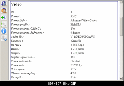

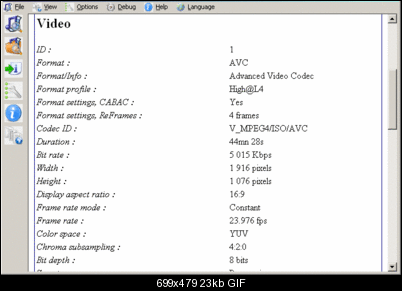

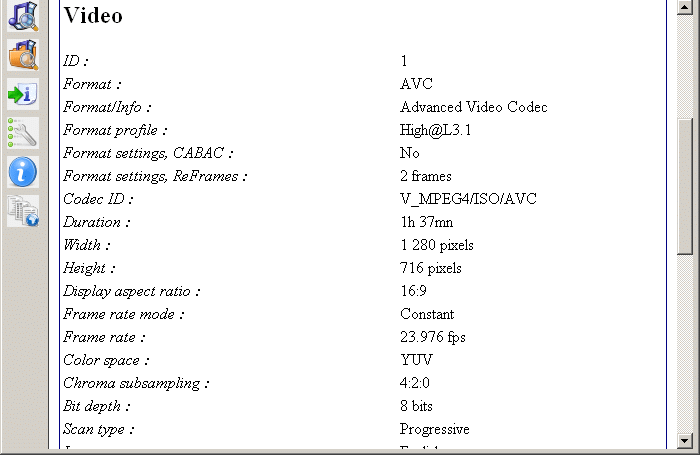

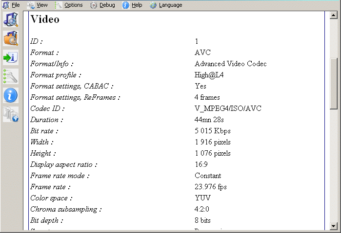

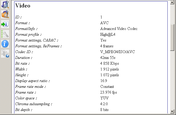

    If it helps, I think more iTunes video is mod4 than mod16, and if it was likely to cause playback problems, I suspect it wouldn't be. iTunes 720p video still caters to ancient Apple TV devices which means a maximum 24fps frame rate at the maximum resolution of 720p, and no CABAC as apparently they can't decode it, but mod4..... no problem.
    I don't know why so much iTunes video has "odd" resolutions. Mod2..... I've thought about it and I think Apple may draw the line there. I'm sure I remember seeing mod2 iTunes video now and then but I couldn't find any when I went looking so maybe my brain invented that memory to help me get through the day.
    No way could I encode at 1280x716. I can encode at all sorts of weird and wonderful resolutions but not something so close to being 16:9 and 720p without actually being 16:9 and 720p. My OCD tenancies would kick in and prevent it.
