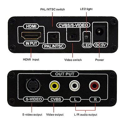

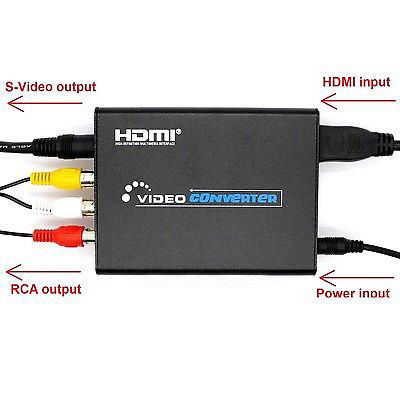

    There are tons of "HDMI>Composite/S-Video" converters available from web dealers, eBay and Amazon. But unpredictable performance and sample variation is the norm. You either get flawless video, but the thing self destructs within weeks, or you get a reliable box with mediocre (barely acceptable) output quality, or you get something in-between. The exact configuration of converter seems to change year to year: the most widespread current version is a plastic "mini" about the size of a matchbox, powered via external USB connection (PC, TV, or phone charger/USB wall wart). Some of these reputedly have the best output quality yet seen from such a converter, very clean, unfortunately they tend to brick themselves fairly quickly. They appear to last longer and perform better if powered from a direct AC/USB adapter.
    The older model had a metal casing about the size of a cigarette pack, and came with a traditional wall wart power supply. HDMI and power connected to one end, analog outputs to the other. This version has proved itself reliable for those of us who bought it around four years ago, but output quality is blah (slightly darker than input IRE, somewhat muddy highlights and murky/tinted shadow areas). Adequate when there is no other option than to convert HDMI to analog (as a workaround for other issues), but you wouldn't want to use it for everyday recording unless you're OK with VHS-level PQ. I own three purchased from Monoprice (which no longer sells them), all perform at the same mediocre level. Other owner reports skew 70% similar to mine, with 30% saying theirs is significantly better. Given the two dozen suppliers selling rebranded and generic versions, theres no way to be sure what you'll get beyond "adequate". Note they tend to come preset to PAL, which results in black & white or no video: flip the switch to NTSC if necessary. There is another switch that toggles between composite vs S-video output, which can also cause video loss if not set properly.
    For short-term critical use, the "mini" versions seem to offer dramatically better PQ. For long-term occasional use, I'd suggest the larger older "Monoprice" type - look for one that matches these pics:
