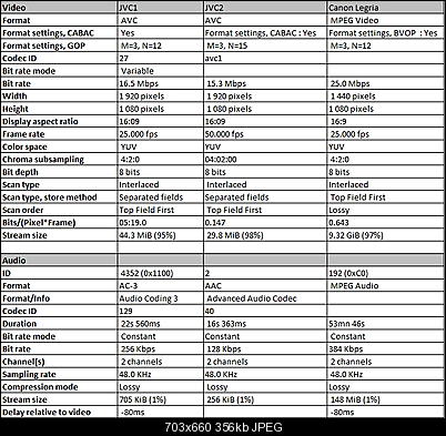

    I am editing a function, where the video recording was done with 3 video cameras. My idea is to render the video as a DVD and create a disk and to render another copy with BluRay settings, although I do not have a BluRay writer or player, but might get one in future.
    The info of the 3 videos differ (analysed by MediaInfo). I am therefore unsure what settings I should use to get the best quality DVD and BluRay disk (Isuppose one will be able to play the BD video by using a memory stick?)
    Info from the 3 videos:
    Thanks for any input

    looks like at least they are all pal 1920x1080 even the one that says 1440x1080 is most likely HDV which uses non-square pixels but converts to normal 16/9 for viewing. the HDV may even be progressive separated fields like the others appear to be, no way to tell as their is no flag in the stream for that. you just need to watch it closely and decide if it's interlaced or progressive.
    if it were me i'd render all of them to a single format of lossless YUV avi. 1920x1080p25 would be my choice with pcm audio. since i edit in vegas i use the sony yuv codec, but huffyuv, lagarith, or any of the others would work also.
  3. Never mind your DVD or Blu Ray outputs yet. What editing software are you using?
    Generically, you should create lightweight i-frame codec proxies, do your editing and then link back or replace the proxies with your original footage -- then render out to DVD and Blu Ray compliant files.
    I agree with aedipuss you should convert your audio to PCM and leave it that way until final output.

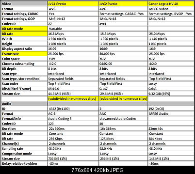

    Looking at the 3 cameras, I have highlighted a few areas. The 2 JVC cameras appeared similar and are Everios. My Canon is a Legria HV40, which has since broken.
