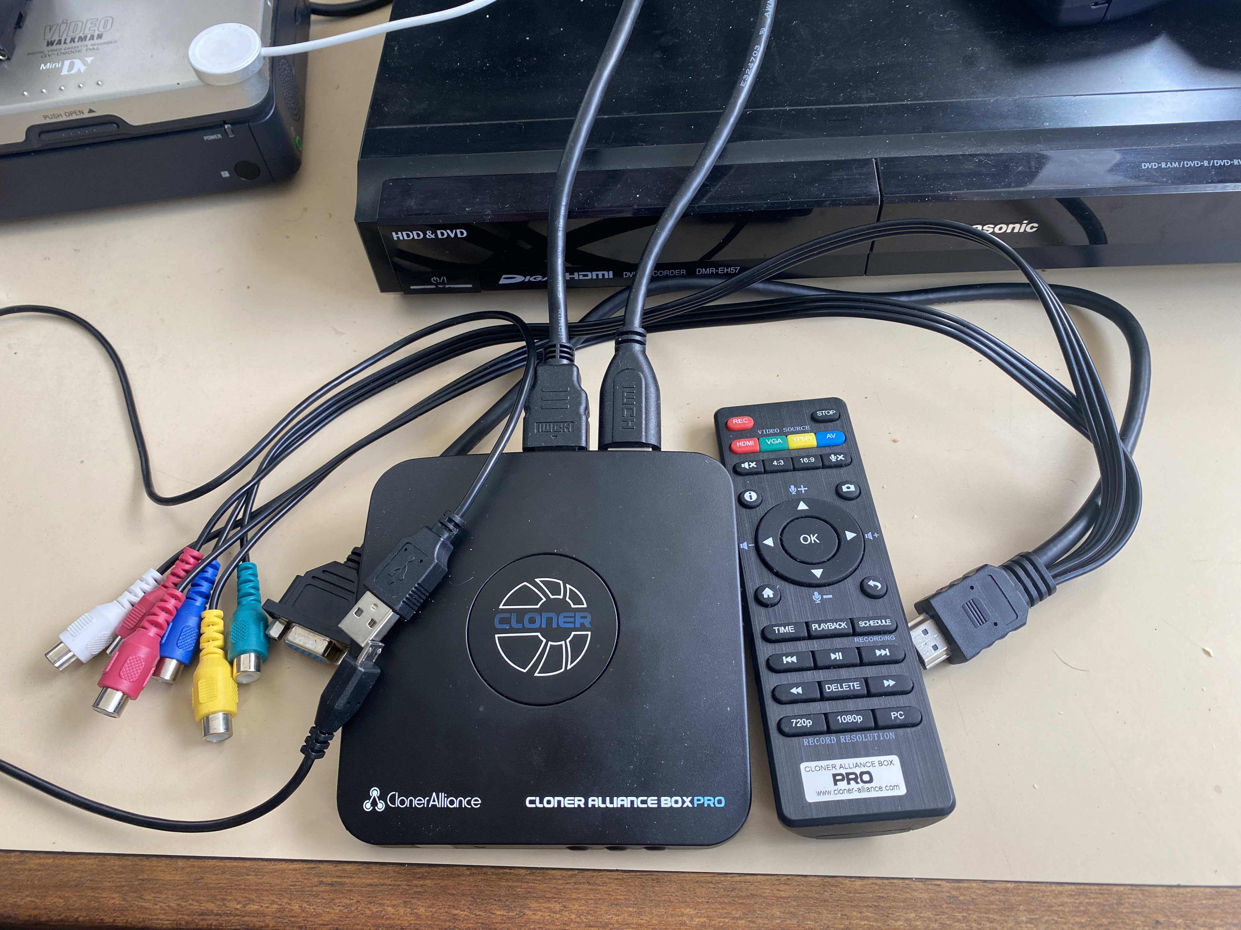

    I wonder why do you capture DV through a DVD recorder into HDMI onto the Cloner AP?
    You computer does not have a Firewire card? They are as cheap as $10.
    Your computer is a laptop? Well, a refurbished Win7 PC costs about $150, the Cloner AP costs about $180, but then again maybe you don't want to buy a huge desktop PC.
    Still, I am curious how have you decided on this particular capture chain. @12voltvids explained that for him Cloner AP is good enough as he is doing this for his customers, the box is standalone and self-sufficient, and the moment the tape stops playing, the conversion is done - easy. No need to think about resolutions and bitrates either.

    You are converting, as far as I understand, 25i into 60p - is this correct? To me, this is the biggest problem.
    You are converting 4:3 into 16:9 with 4:3 pillarboxed inside it - at least it looks ok on a widescreen TV, and many people find this acceptable.
    You are converting 1.36 AR into 1.33 AR - a minor issue.
    I personally don't care about it being AVC at low bitrate, I think it is good enough, others take issue with this but not me.

    [Attachment 75915 - Click to enlarge]
    Thank you @Bwaak for your considered responses.
    I believe you are correct and that the Cloner AP does 60P capture by default and therefore is not perfect for PAL users but as far as clarity, colour and stability the result is the best I have had with my poor quality (V8 out of focus) aging tapes.
    Your analysis & responses prompted me to do further research - to find if I used the computer via the Cloner AP I could set for PAL - but apparently the Cloner manipulates the frames to achieve this (by adding or removing frames I forget which but you will know) which can be problematic to the "workflow".
    For an average PAL (lay person) user the Cloner AP gives a great result in an all in one capture to flash drive, with the ability to use the remote to pause/stop the capture lessening the need to edit the container or codec later, but if required the supplied software can trim, combine, or convert and doesn't seem to lessen quality. I might be wrong but the software is specific to the device.
    In the past I have captured to a card (reasonable quality card on W7) but was quietly disappointed by the result and it lacked colour, it was grainy and a little unstable. Burning to DVD may have reduced the quality further - then eventually the worn DVD's became unplayable, just when we wanted to spend time re-watching the DVD's to augment 35 year old memories of kids and travels.
    The resulting play back on a widescreen TV is 4:3 aspect ratio which looks best in my opinion for these old videos.
    It does have "gunk" at the base (ever so slight rolling "noise") but it doesn't bother me that it is not perfect, and I don't crop it out, rather it adds to the antiquity of the video.

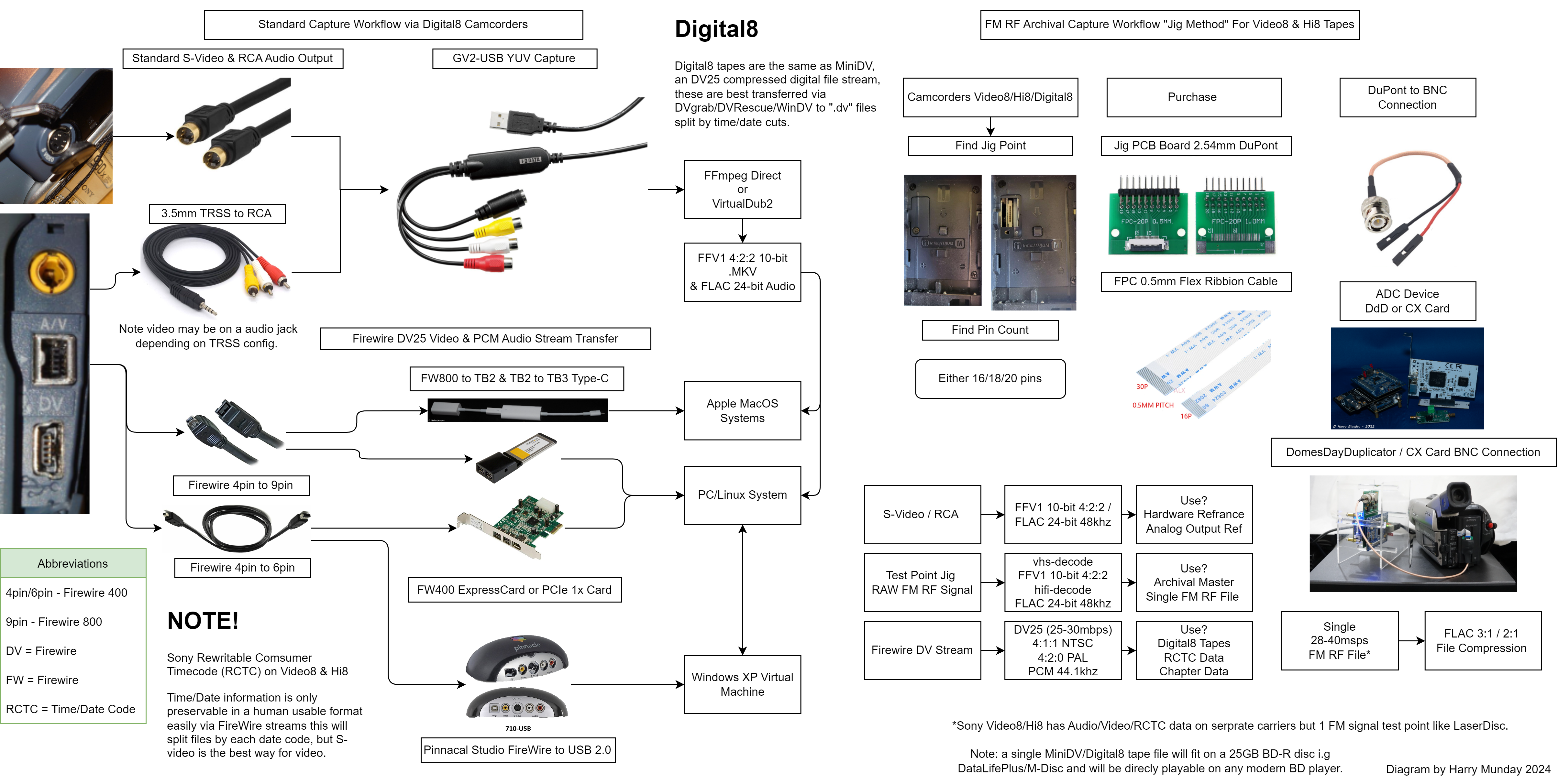

  14. Image
    [Attachment 76075 - Click to enlarge]
    We really have hit the peak Sony 8mm format digitastion, here is it all summed up in 1 workflow image.
    Its also worth nothing that there is USB adapters for both of Sonys camcorder type connectors, and the NP-F battery system to 5V 3A & 9V PD if you dont want to use AC power bricks widly avalible of AliExpress/Alibaba using regulated buck boost converters camcorders are so low wattage any proper powerbank can now power them.
    I don't think that there is a consumer-grade dongle that outputs 10-bit video, so encoding it into 10-bit codec seems excessive.
    Also, capturing audio into 24-bit 192 kHz FLAC is insane. AFM audio is CD quality at best, while digital PCM audio is even worse.
    S-Video is not the "best" way; it only results in comparable-quality video to PAL DV (I haven't tested NTSC DV).
    SVideo is the best for Video8 and Hi8 if one has a decent A/D converter and knows what he is doing. Firewire is the best for Digital8.
    There is a mistake in that diagram, DV PAL is 4:2:0 not 4:2:2. Also iOS can capture analog from S-Video/composite, although it's a pain in the a$$.

  23. Originally Posted by Bwaak View Post
    Firstly the GV2-USB is well established YUV2 4:2:2 10-bit feeds its the easycrap killer of plug and play. (its not a MISRC but its pretty good)
    Digital8 is a DV file on tape same as MiniDV, you have to read the context of the whole workflow its about Video8 & Hi8, so I fixed that on the new version.
    This diagram is going over Video8/Hi8 via a Digital8 camcorder which is the best hardware based S-Video output with its last gen ADC/DAC systems, alongside a DV25 converted firewire stream for preserving the RCTC timecode data from Hi8 tapes as ancillary stream data and also most of these digital8 camcorders have FM RF output suitable for archival and later decoding with vhs-decode/hifi-decode via the single RF signal on a plug and play jig board via FPC cable as its 1 FM RF signal point its very streamlined to get good captures and decodes.
    192khz 24-bit FLAC was the only mode HiFi-Decode could decode the FM carrier to at the time of diagram creation, now you can just set it to output to whatever you want from 44.1/48/92/192 etc 48khz 24-bit is the defacto in the standard workflow now.
    I will also note the FireWire control (also LANC too can I suppose to some degreee) can tell the camcorder to rewind and start playback making remote capture quite nice and it also allows for automated scripting to capture S-Video/FM RF/DV25 at the same time, I really like the DVgrab commands for doing this.
    OBS Studio is not usable for analog digtisation, it cant encode native interlaced feeds and its real-time de-interlacers are piss poor compared to QTGMC/W3DIF etc its ment for and intended for progressive locked or local system source production not "broadcast" production, if they cared about that its FFmpeg libarys would have interlacing enabled to natively encode it and send out interlaced feeds, hence why its blanket banned as a recommended ingest tool, if your a Mac/Linux user then you can just go pickup blackmagic TB3 or SDI kit and deploy v-record or the desktop app (Media Express) with ease plug and play straight to v210 or FFV1 files.
    But anyways with the last updates to vhs-decode this month, there is no point in S-Video/FireWire outside of refrance and getting that RCTC data, the S-Video TBC files created by vhs-decode from the RF is better SNR then the DACs on the S-Video ports on the physical hardware could produce, and as its 1 FM signal post sync is easy for audio.
    And yeah only DVCPro was 4:2:2 8-bit that was a typo DV PAL is not 4:2:2 but 4:2:0 8-bit.
    I have attached a updated version with some better workflow context added, as this year all diagrams are getting updated anyways.
    [Attachment 77159 - Click to enlarge]
