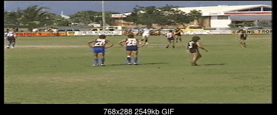

    Here you go, peeps. 768 was deliberate.
  6. Banned
    Nov 2022
    Looks pretty good!
  7. Thanks Alwyn. Looks ok. It's what I was looking for.
    It can certainly be done without the deliberate horizontal rescaling, I assume.
    (With the side borders still in place it should be 786 wide for square pixels, rather than 768, but it doesn't matter for now).

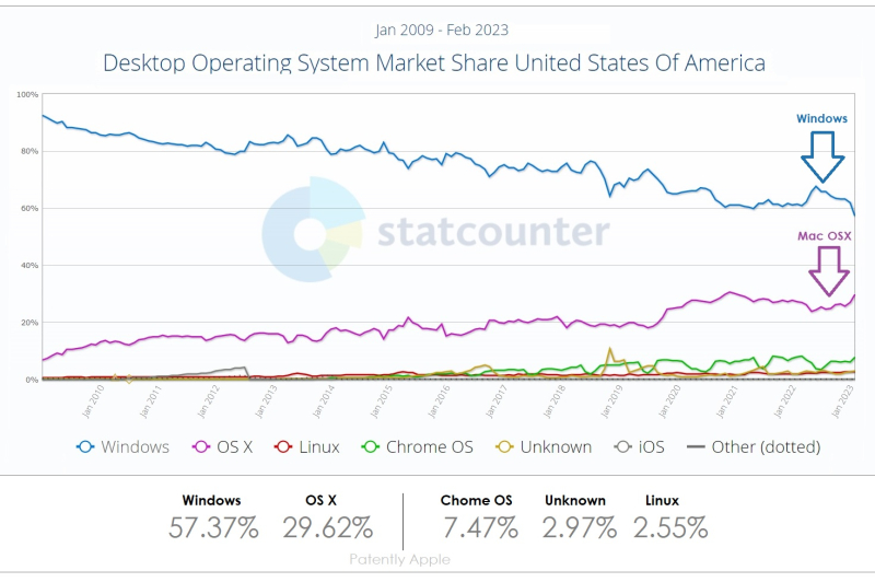

  9. Banned
    Nov 2022
    I'm talking about people using vdub and AmarecTV and similar programs on Win10/11 successfully without needing OBS.
    The share of Windows is steadily dropping, while the share of Mac increases. I bet that the situation among laptops is even more in Mac favor.

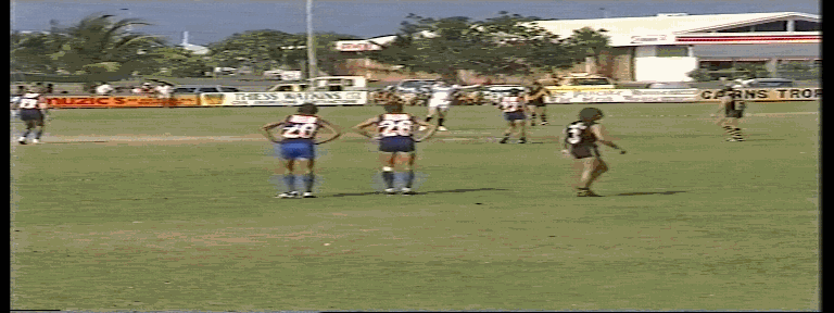

    May 2005
    Australia-PAL Land
    Ok peeps, here are 1/OBS recording and 2/Amarec recording. My hieroglyphics are LG=crappy Composite VCR; ES=ES-15 Stabiliser; GV=GV-USB2; ULY2=UTVideo codec. I did try MagicYUV/Amarec, with the same result. It appears UT video (ULY2) is the only lossless codec that is used for lossless capture in OBS; not user-adjustable. I didn't try VDub because it didn't pass my CBA test.
    Enjoy!

    And the MP4 of the same part of the tape (I didn't trim this, to preserve the MP4 data). Deinterlaced with "YADIF2x". I don't know what that "2x" means; it didn't produce 50 frames per sec.

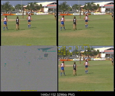

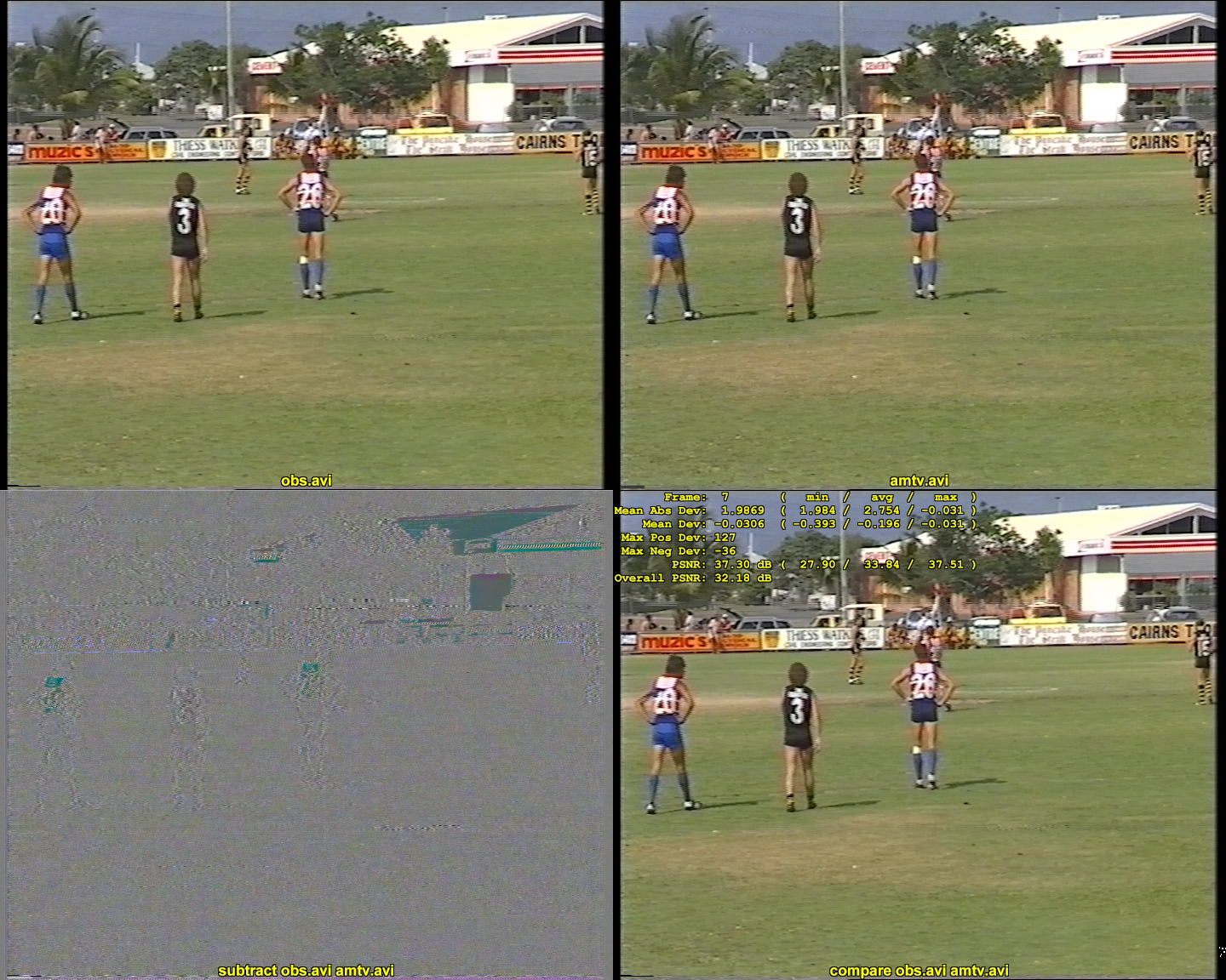

  17. Captures & Restoration lollo's Avatar
    Jul 2018
    Italy
    Final conclusion: Avoid OBS for VHS capturing like the plague
    Agree?
    I agree. Lot of inserted and dropped frames in OBS. Does it report this or not?
    In addition, for frames that match, there are evident differences.
    I never tested it, so I cannot provide facts, but for sure OBS has something "strange"
