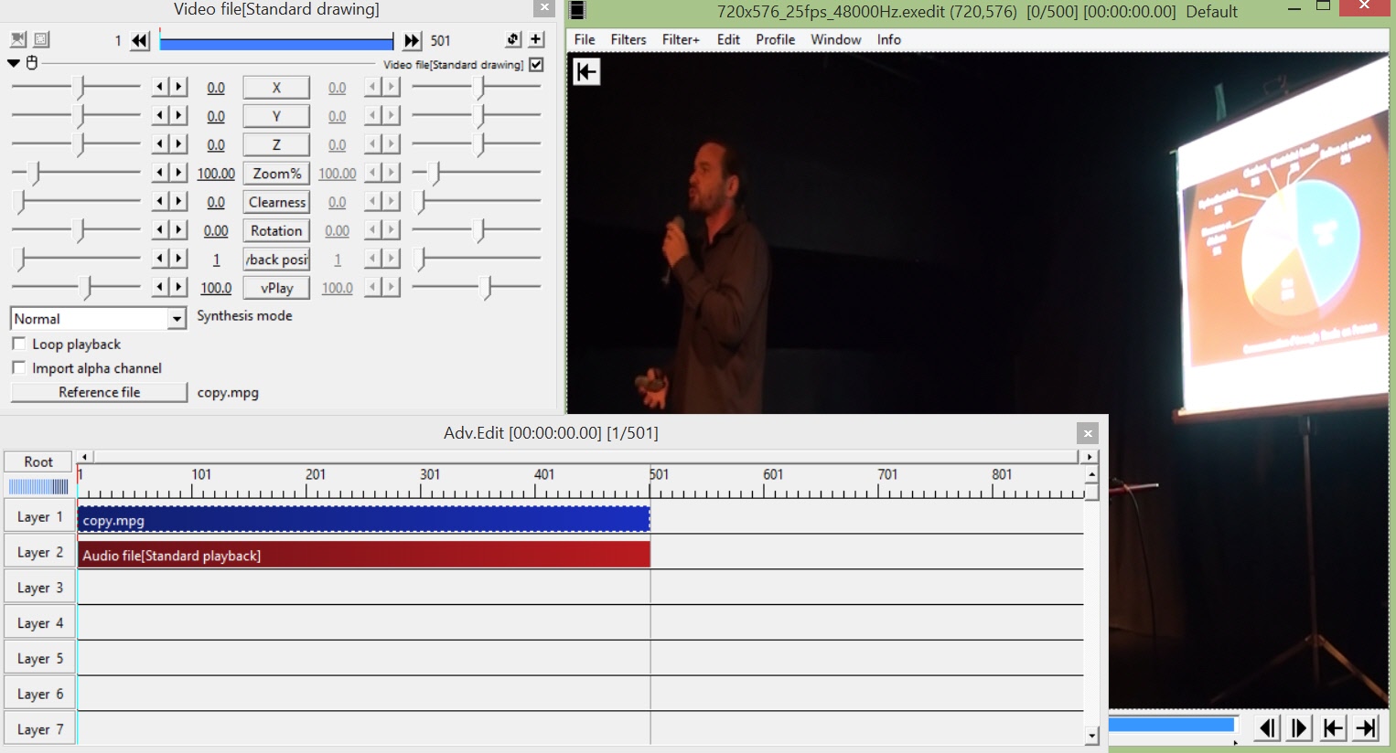

    Edit: Ran the following command, dropped the file onto the Layer 1 line in the timeline, and lo and behold!
    ffmpeg -i full.mpeg -c:v copy -c:a copy -f vob full.mp4
    Are we positive AviUtl actually supports MPEG files?

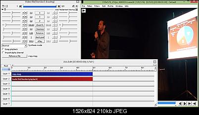

    Yes, positive. Interesting that it worked as MPEG2 in a MP4 container for you ...WTF ?!
    This is in 1-6[xp] on a Win8 OS - I tend to use that one, whenever there is 5.1 audio. But 1-10[win7] also opens it up , but with wrong framecount (it's misreading interlaced content). 1-6 does it correctly with the correct 0-500 frames = 501 total, interlaced
    But it sounds like you're leaning towards avisynth...
    This is the variation using the HDRAGC mentioned earlier. It was bob deinterlaced, and 2nd instance of HDRAGC is used on the highlights by using Invert()
    Anyways, there are many ways you can approach this - there are many filters within aviutl or avisynth you can use to get similar results. Curves mentioned earlier would also work in vdub, but you need to convert it to full range RGB first, otherwise you clip the overbrights

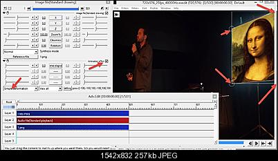

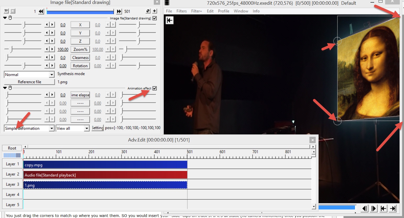

  10. BTW "corner pin" effect in aviutl to distort an image is under animation=> simple deformation
    You just drag the corners to match up where you want them so the perspective matches. You would insert your "slide" clips on track 3, because higher numbered tracks "cover up" lower numbered tracks (reverse to what you'd be used to in something like photoshop or an image editor). So you 'd still brighten the shadows in whatever way that you want, you can composite the slide on track 3
    If it's all static (no camera movement) once you position the 1st slide you can just copy & paste the effect to the other slides (because the location will be the same) . (Those dotted lines in the preview won't be there when you render it, it's just in the preview)

    I'll insert full width slides, because displaying them on the right half would be too small.
    Amazing Thanks much for the tip.
