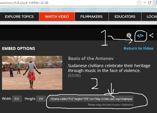

    These videos seem different than many PBS videos, in which you can get a VideoInfo.
    From that webpage click on the embed symbol "</>" just above the video and copy the link. Change "viralplayer" to "videoInfo".
    Otherwise, select episodes from the main pbs webpage for this program. http://video.pbs.org/program/pov/
  5. From that webpage click on the embed symbol "</>" just above the video and copy the link. Change "viralplayer" to "videoInfo".
    Yes, I see that now (both methods you mentioned will get you the magic videoInfo number, 2365538436).
    <iframe width="512" height="376" src="http://video.pbs.org/viralplayer/2365538436" frameborder="0" marginwidth="0" marginheight="0" scrolling="no" seamless></iframe> [See below screenshot]
    EDIT: anybody interested in this topic, I clearly explain how to download if you have the videoInfo number.
    See here and go to posting #8:
    https://forum.videohelp.com/threads/369370-capturing-from-pbs-I-think-I-am-close-but-ne...-a-little-help
