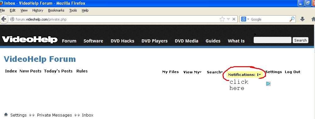

  19. Eshmunazar,
    I'm sending you a private message. Please log in and check it.
