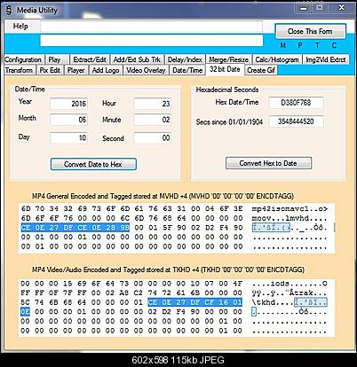

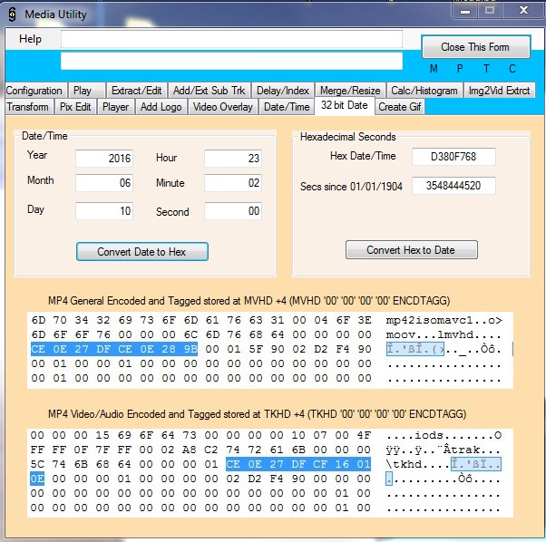

    How did you figure out that was where the encoded date was for the .mp4? Using your #16 post showing the example, I have been able to figure out how to correctly calculate the HEX value for a given date and modify a .mp4 file. So thanks for the insight there.
    What documentation did you look at to learn where the encoded date is? I checked a .mkv file hoping it was the same but it isn't.
    Got to the following site and it explains the location of MP4 'Atoms' and their location. I also have an HTML page that I have modified to decode 64 bit hex characters although it is fairly easy in Visual Basic to convert.
    https://developer.apple.com/library/mac/documentation/QuickTime/QTFF/QTFFChap2/qtff2.html
    Each container for a video has its encoded date in a different place if it contains it at all. Media info will show this in the General are unless it is not contained at all. If it is empty, on an MP4, the hex data will contain all '00' but changing this to a valid entry will then display the encoded/tagged data.

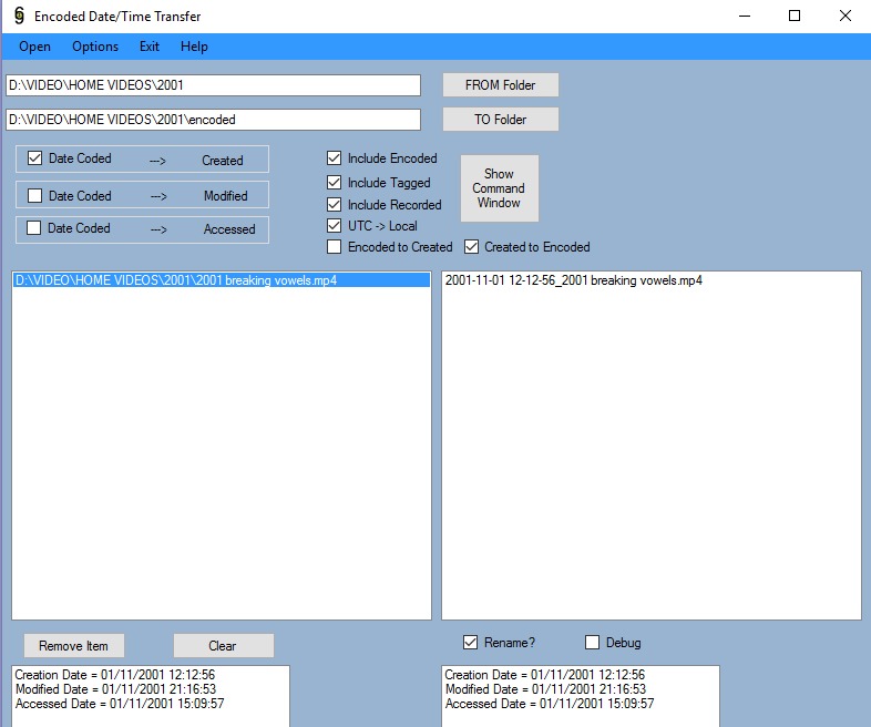

    Originally Posted by Budman1 View Post
    threehappypenguins, are you looking to just change the Recorded date?
    Hi Budman,
    I am uploading all my home videos to Google Photos, but
    1/ the date change there does not always work
    2/ when you upload to an album with 100 videos already in it, it is very hard to find the ones you have just uploaded, they could be anywhere, Photos is a bit of a mess in this regard.
    SO, I would like to change the date stamp so Google sorts it properly by date.
    I have noticed that the normal File properties Created Modified Accessed dates do not affect Google Photos sorting, it seems there is another Date Created one, which Adobe Bridge can see, but not edit... and I cannot seem to change that with any app...
    When I run your app on some files, they all come out as 0kb files, though the dates do seem to have changed. What am I doing wrong? Red writing says "Could not write header for file..."
Name:	encode files.jpg
    tx
    Mark
  10. Member Budman1's Avatar
    Jul 2012
    NORTHWEST ILLINOIS, USA

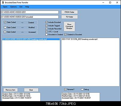

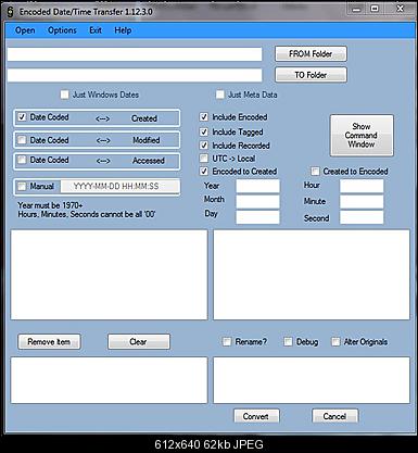

    @fredphoesh I've done a rewrite on my program and you should go to https://forum.videohelp.com/threads/373763-Tool-to-batch-rename-video-files-based-on-en...e?goto=newpost. I even have a newer version that I have yet to upload but I keep the link current there.
Name:	Lates datetime.jpg
    I am interested in the 0 length file. Can you post the mediainfo for the original and the complete error with information before and after as to why it couldn't write the header? I would appreciate it.
    I don't know how the cloud works but I do know if you send a file even to a new drive, Windows likes to assume its a brand new file because it just showed up and set the created date, etc. as if it was just created. Could be something like that happening.
    Budman1

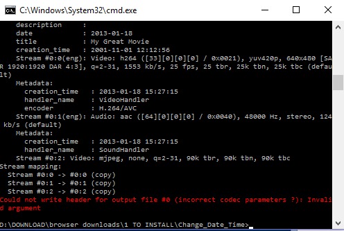

    Dec 2016
    Hi Budman,
    I don't see a download link to the new app version at that url... can you post it here please?
    Im writing to a sub folder in the same directory as the original, so I am not encoding to the cloud. The error message goes before I can copy it!! Makes it very hard to copy. I will do a long batch which will give me time to copy the first error.
Name:	error batch change timestamp.jpg

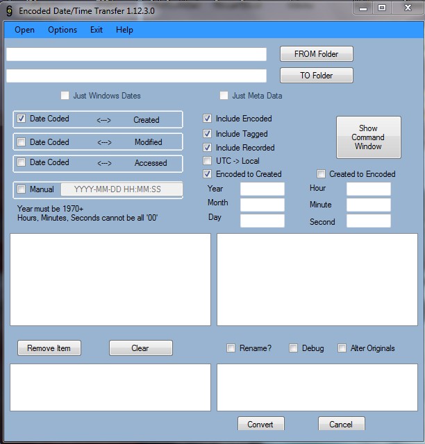

    Okay the link and latest had a bug in it so I reposted at the above link so it isn't posted all over the place until it is finalized. Go to the link above and read comment 34. It should now work and I fixed a couple other problems so Change original, Change name, and manual should all work together. just be careful what you select.

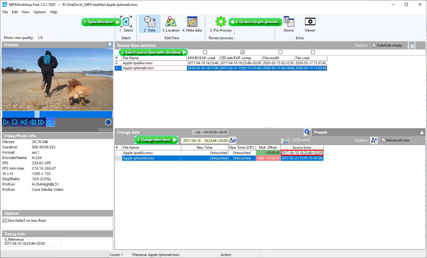

    Apr 2021
    Netherlands
    Hi,

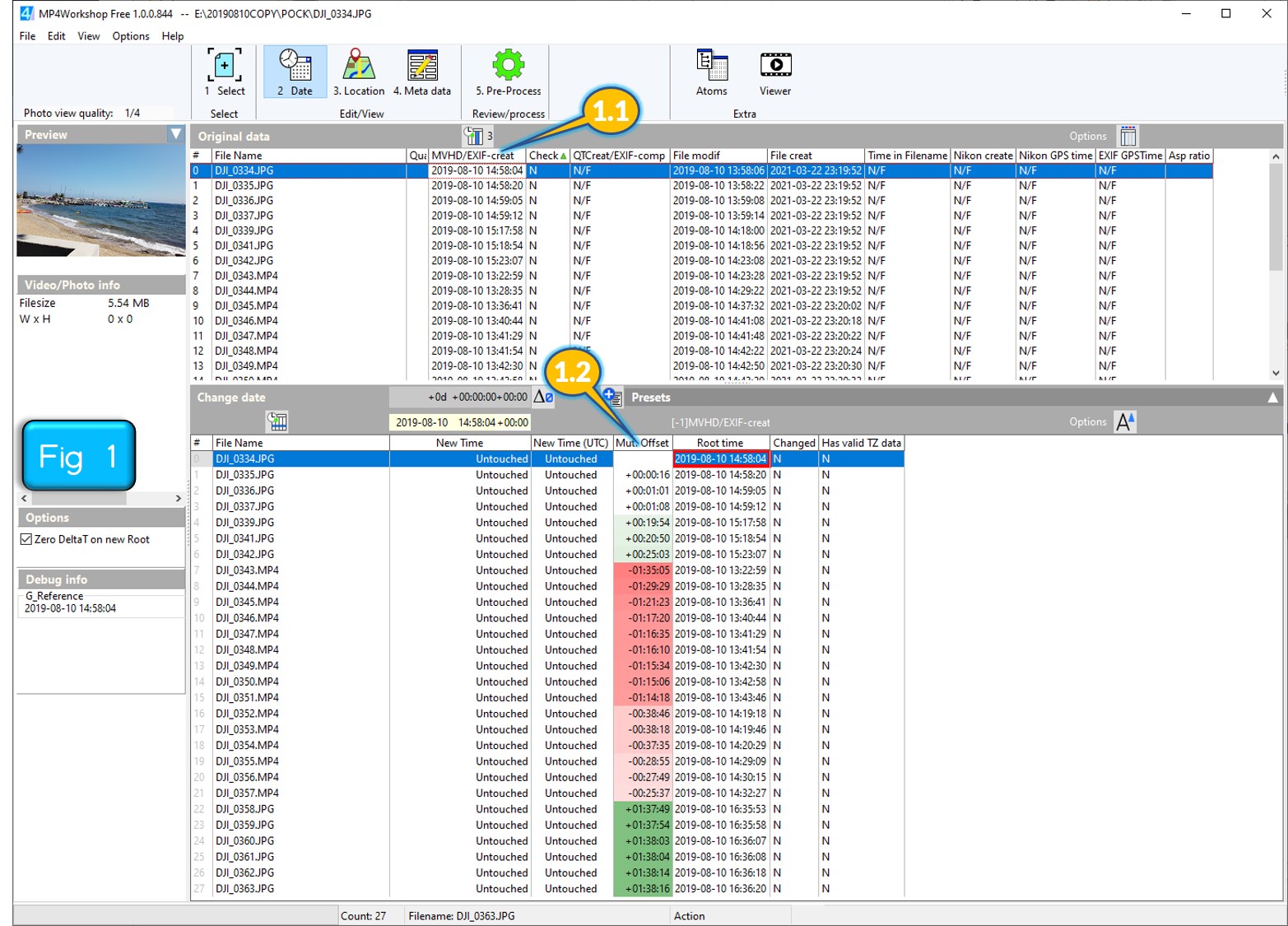

    You can also try to use MP4Workshop. It is a new software designed to edit the internal metadata of the MP4 file, and can also add timezone offset to make it align correctly with all other movies and pictures in for example GooglePhotos. It is free software, you can download from mp4workshop.com.
    It can handle single files, but in essence it is aimed at batches of files (including JPG and MOV), which is usually the case when you camera setting is wrong..
    It is free, GUI based, does NOT re-encode you video and has a preview window for the file you're working on. Ans it adds UTC and timezone offset: so no further weird effects in GooglePhotos or other programme used.
    See mp4workshop.com
    Greetings, John

  19. DECEASED
    Jun 2009
    Heaven
    Originally Posted by JohnJackson View Post
    Hi,
    See mp4workshop.com
    Greetings, John
    Thanks for the free software.
    It works — but the interface is a mess
    — and as a consequence, even the manual page on your site is not clear enough.
    "Programmers are human-shaped machines that transform alcohol into bugs."
    Apr 2021
    Netherlands
    El,
    Thanks for trying the software! Yes, I can imagine the interface is complex if you use it for the first time. One of the problems is the many possible sources of 'original time'. I think you should be able to see them in an overview so you can pick your 'source time'. When I also added the possibility to change JPG files it became even more complex...Is it this large number of columns that makes it messy? I could autohide columns that contain no data. I'm also trying to introduce checkboxes above the columns to make selection look more logical.
    Since I worked on the software, it now looks logical to me. But it's work in progress.. I'm also working on some YouTube video to add more clarity. It is difficult to make a simple interface for such a complex task...
    Can you explain what is really messy or unclear? If you have suggestions I could make changes, but I dont want to add many more tabs...

    Hi all,
    A new version of MP4Workshop (see above) is published. There is less clutter in the GUI and has a built-in tutorial call-outs to show how to change the timestamp of a file. You can switch off the tutorial call-outs under the Help menu. See MP4Workshop.com.
    It can handle single files, but in essence it is aimed at batches of files (mp4,mov and jpg), which is usually the case when you camera setting is wrong..
    Important to note: the software adds timezone offset! Many mp4/mov files only contain a timestamp in the mvhd atom, and this is only UTC time. Files from Apple devices usually contain the Quicktime tag/key ‘com.apple.quicktime.creationdate’ and this seems to be the only key that is widely used by many softwares (like GooglePhotos) to read the time including offset (e.g. 2021-03-04 12:18:02+01:00). When not present, MP4Workshop adds this key to your video file so it can store the time correctly, including the offset. For jpg files it adds Exif GPSTime (UTC) and local time.
    It is free, GUI based, does NOT re-encode you video and has a preview window for the file you're working on. There is a tutorial on the website, and it has built-in tutorial hints for first-time use.
    Greetings, John
    [Attachment 58579 - Click to enlarge]
