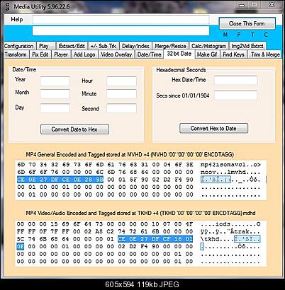

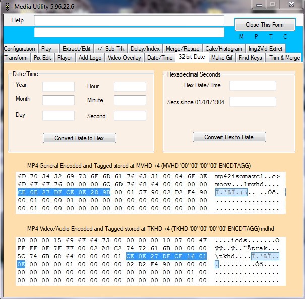

    @NightShadow... That is correct, if that is the way you are going, but if you or others go the other way, Windows dates to Meta changes the results are different. Below are 2 different uses Meta2CRT and CRT2META. Notice the One direction is catastrophic for 2 files that are playable and have a thumbnail (Meaning the decoder also liked them).
ID:	39893Click image for larger version
    Going MetaData to Windows Created/modified should be no problem but it is ALWAYS a good procedure to keep originals until editing is done and verified. Many have written in here and asked how to fix corrupted files after they no longer have the source files and the answer is always the same. I will post the new link as soon as my faster internet is up again.
    Budman1

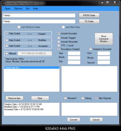

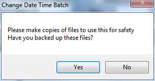

    Thanks for your fast reply.
    It didn't work though. I tested with one file.
    Made selection as shown.

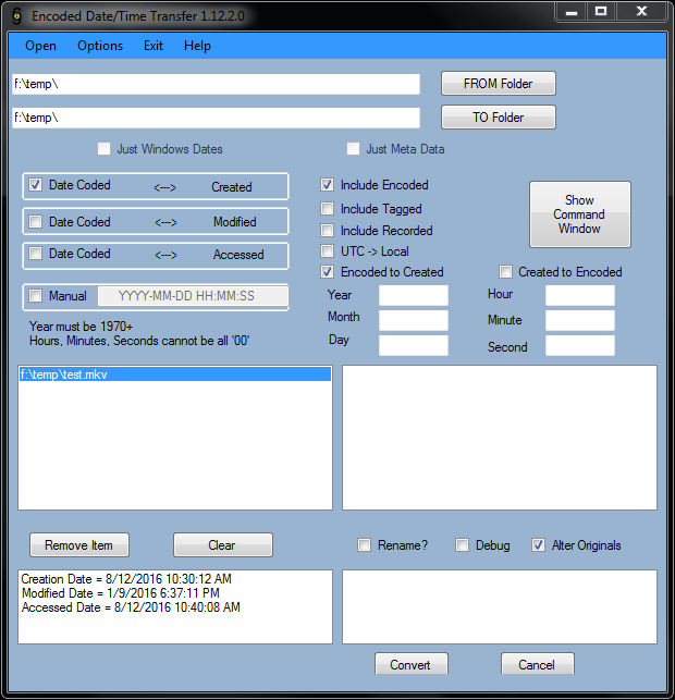

Name:	Change Date Time.PNG
    I want to replace the file creation date with the encode date which is stored in the metadata.
    Did I make the right selections as show in the attached image?
  4. Member Budman1's Avatar
    Jul 2012
    NORTHWEST ILLINOIS, USA
    @NightShadow, That looks like the right selection but bear in mind that after the file is changed the date and time in the lower box will not change until you click the file again.
    Update... Just checked and sure enough I was asleep again when I coded it. Think this is fixed now. I changed the link and it should work now.
    New Version https://files.secureserver.net/0sqAfho5vHt8P9
    Budman1

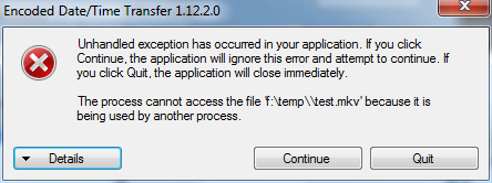

  5. Originally Posted by Budman1 View Post
    Update... Just checked and sure enough I was asleep again when I coded it. Think this is fixed now. I changed the link above and it should work now. https://files.secureserver.net/0s4WP9YVhk50S5
    Budman1

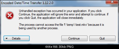

    Sorry but it didn't work.
    It was attempting to overwrite the file instead of changing it's attributes.
    I attached some screenshots to help you with the troubleshooting.
Name:	Change Date Time 1.PNG
    Made selections then pressed convert.
    Name:  Change Date Time 2.PNG
    Pressed yes.
    Name:  Change Date Time 3.PNG
    Pressed yes again.
Name:	Change Date Time 4.PNG
    Pressing continue does nothing and quit just closes the program.
  6. Member Budman1's Avatar
    Jul 2012
    @Nightshadow... looks like we have a mismatch in out versions. Notice the double backslashes? Your computer is actually working in the F:\ directory. I do add the backslash to the path but because my visual studio does not include it when finding the root filename. I added a couple popups to a version to find out where your version picks up the slash if you would care to try. I'll upload and send link in PM. If I may ask, what version of Windows do you run and what .NET version?
    In the mean time I'll try to find a way around this without adding the slash.
    Thanks for your response and help fixing for others who may have this problem.
    Budman1

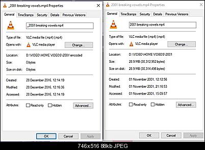

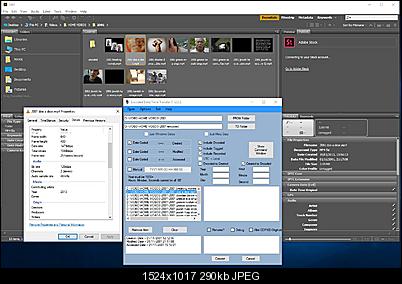

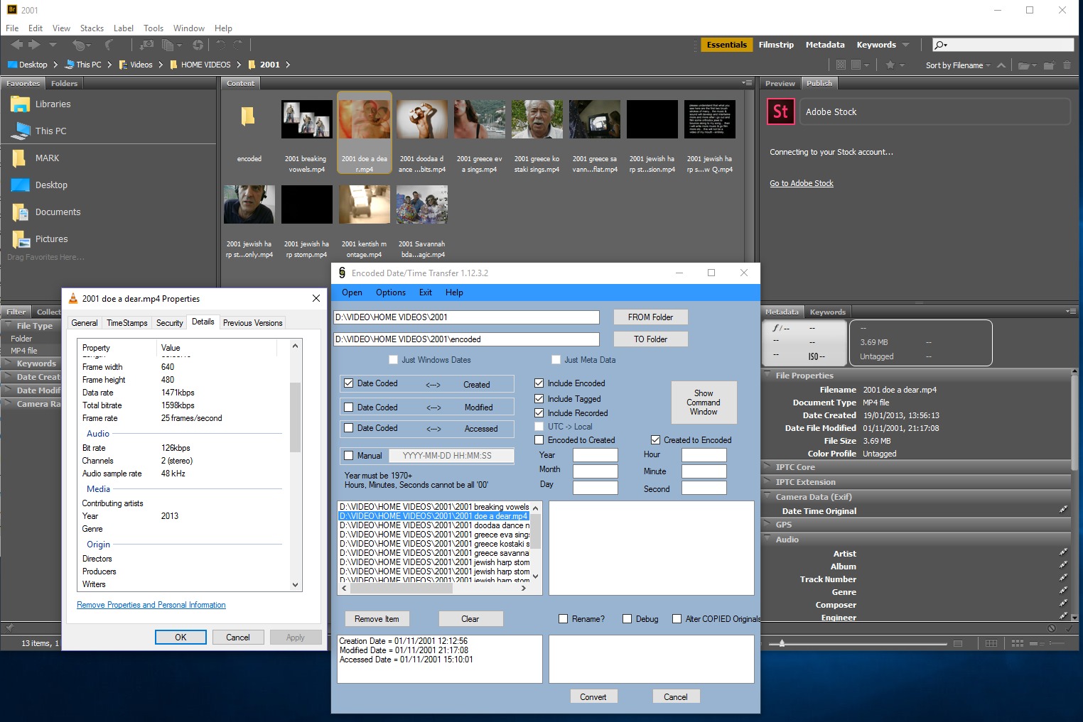

    Dec 2016
    Hi Budman,
    I am still getting 0kb files and the same error I posted yesterday with the new version.
    I am not sure this app can do this particular date change I am wanting...
    Windows file properties dates are all 2001 for this file, Created, Modified Accessed. But see the jpeg here, on the left, you see the windows file properties DETAILS panel... over ehre the date of 2013 is under a section called Media. This date is also seen by Adobe Bridge (on the right) and by Google Photos (I believe). So I do not know if this 2013 "Media" date is the same as the encode date? If so, this will help a lot if I can get it working.
    Were my settings on your app correct to make this date change?
    Thanks!
Name:	media created date is what google looks at.jpg

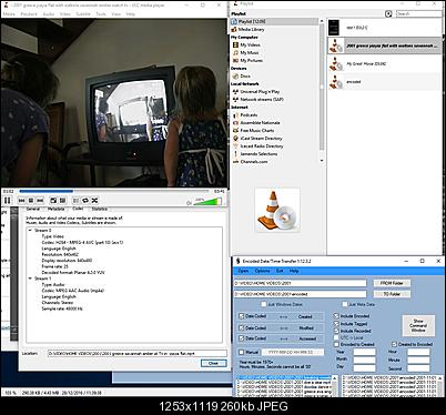

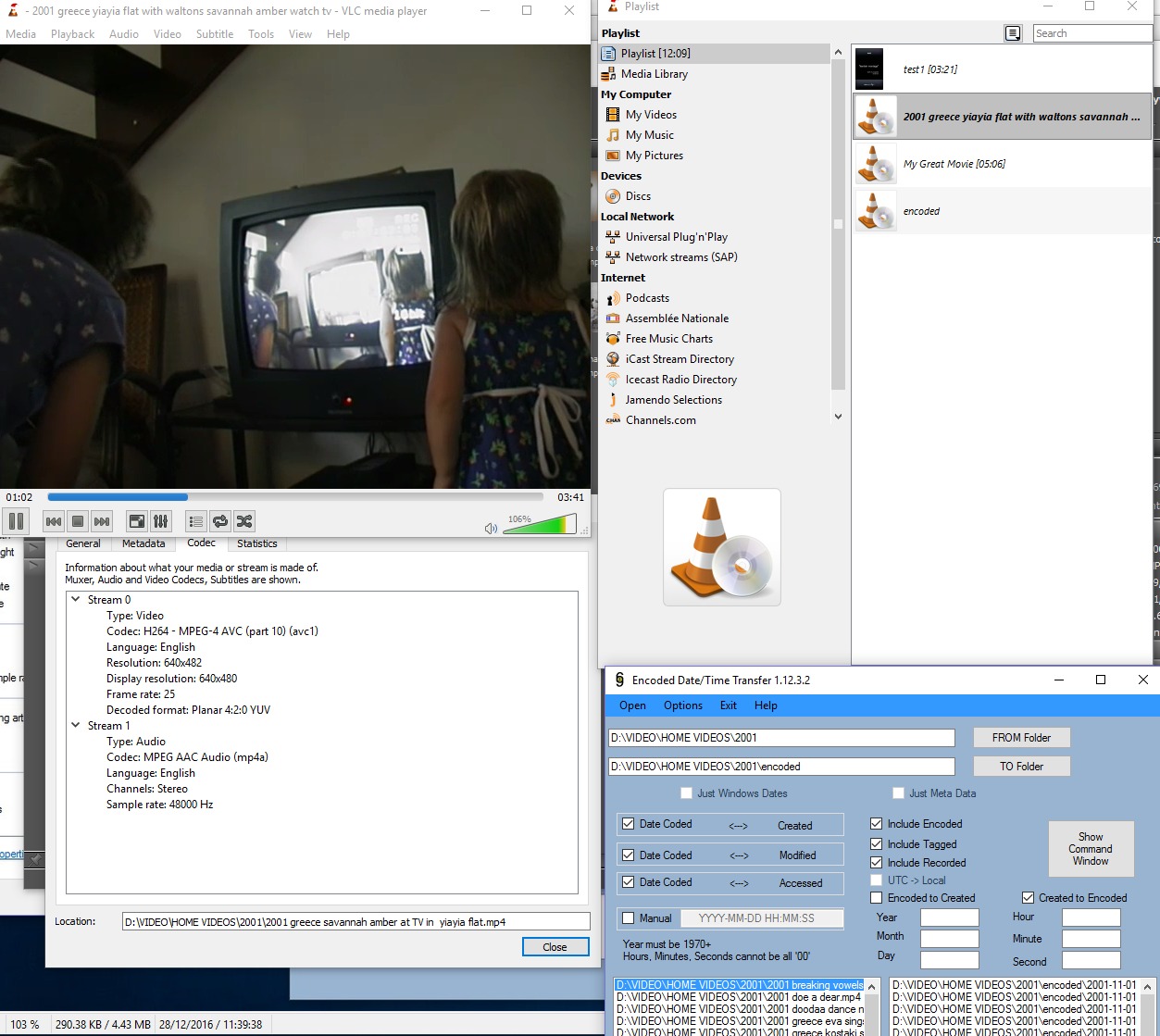

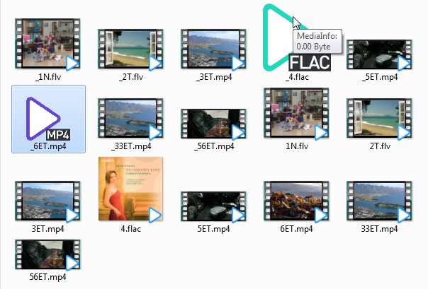

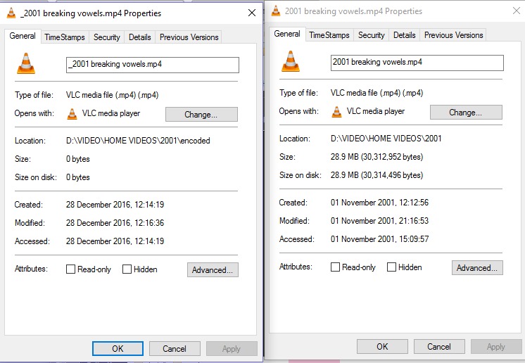

    Dec 2016
    I may have found out something.
    TWO of a batch of 10 DID actually convert.
    These two files are the only two in this batch which do not have Language English in the Codec info, see jpeg. All the others say "Language : English" and they come out as 0kb files.
Name:	files that say English lanugage dont encode.jpg
    ALSO, this shows how the files are 0kb, but interestingly too, that the Windows basic dates all changed to today's date, which is definitely not what I intended
Name:	0kb files and date changed in wrong way.jpg

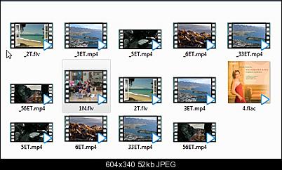

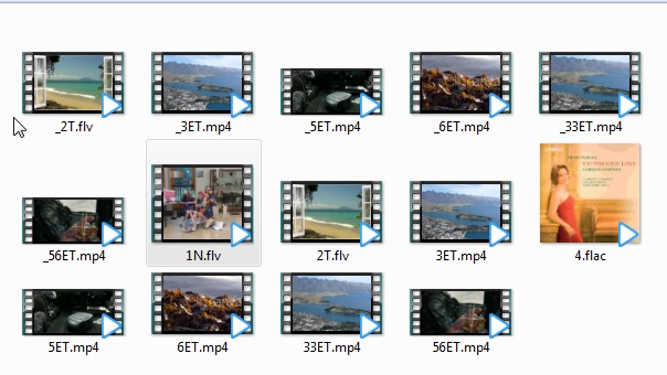

  14. Hello Mr. @Budman1,
    I was searching for a program that does exactly what the program you created does and I've tried your program and it works great, with only one issue and that is some times I get a error message saying that media info has not returned information in 0.005s and that the file will be skipped. After I hit okay it actually creates the new files with the changed attributes but If I try to do more than one file it doesn't work. I'm using windows 10, not sure if you have the time to help me but I would really appreciate it.

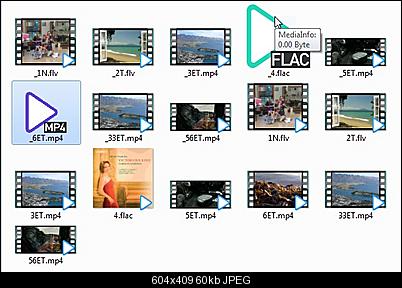

  15. Member Budman1's Avatar
    Jul 2012

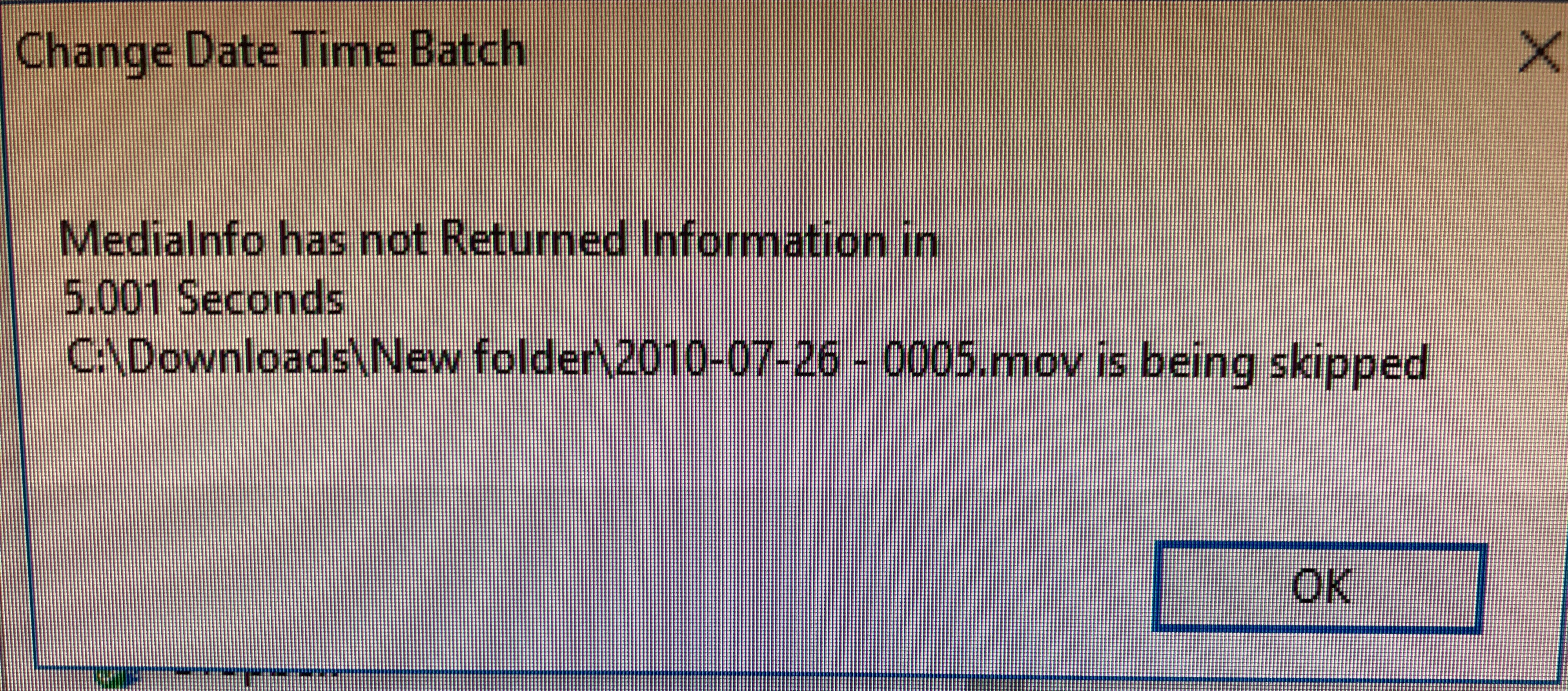

    @bulls23ant, There is a built in 5 second delay for MediaInfo to get the information from your file. This is necessary because, ever since around Windows XP, A windows program will turn Dos loose and continue on. Since I use the CLI MediaInfo and then check the results, if I didn't pause, the results would never be available in time. If you are using a USB drive or a large MOV file and other reasons, the MediaInfo may not be available in 5 seconds.
    It may show up before you click ok but normally it is set to skip this file and go to the next. I'm interested in if it actually does complete and in what direction, Created2Encoded or Encoded2Created?
    More than one failed file or just if another file follows it? Does it work if none of the files fail?
    Budman1
