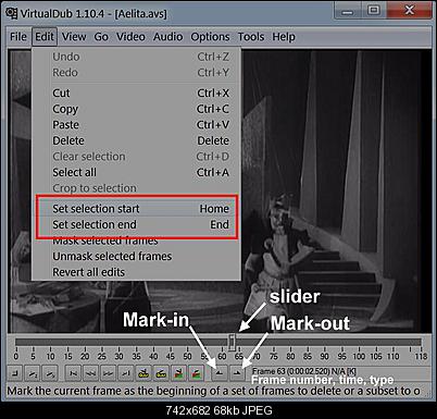

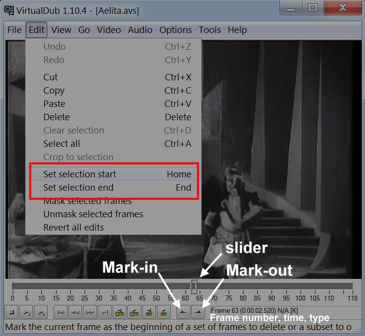

    Also I'm having difficulty just monitoring where I need to edit. A simple playback function that I can watch does not seem to be available on the various buttons.
    In other words, Do I have to view the file in full motion in something else just to get an exact frame cut?
  9. Originally Posted by loninappleton View Post
    Left and Right arrow keys.

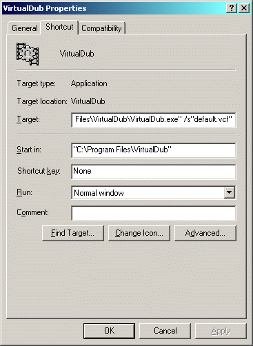

    I'm looking at the script now that we are on the same Virtual Dub program-- not Mod.
    What is the "s" for in the script just after the slash going to default.vcf?
    s = script. It's the switch to tell VirtualDub to load a script when it opens, and in my previous example the script would be default.vcf
    So you could create the default.vcf file, Save it to the VirtualDub folder, then modify the Target in the shortcut you use to open VirtualDub to look something like this:
    "C:\Program Files\VirtualDub\VirtualDub.exe" /s"default.vcf"
    Obviously you'd leave the path set to the actual location of VirtualDub if it's different. Just add the part in blue to the end of what's already in the Target box.

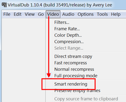

  17. One other thing. Apparently the latest Virtual Dub at Videohelp is 1.10.5 and updated to 2014.
    This 1.7 I'm using Virtual Dub modplus doesn't even show up on the Videohelp software list.
    It's sounding like babble to me as well. Sometime back I got the 1.7. It was not called modplus on its header except in some file description.
    If I go ahead and get rid of these "mods," what dependencies or codecs should be part of a new installation?
    Here we are talking about Virtual Dub 1.10.4/1.10.5 portable circa 2014 as listed at Videohelp.
    Looks like back to the future to me.
  18. Originally Posted by loninappleton View Post
    (smart rendering) This is in Virtual Dbu current edition as I understand it, not Virtual Dub Mod.
    Is this correct?
    Yes, smart rendering was added to VirtualDub a few years ago. VirtualDubMod does not have the feature.

    1.) I downloaded and installed the Virtual Dub 1.10.4 AMD-64.
    2.) Made a shortcut on the desktop for that.
    3.) I put the default.vcf in the program directory of this Virtual dub
    4.) The string I have entered into the shortcut shows to be:
    C:\Users\lon\Desktop\VirtualDub-1.10.4-AMD64\vdub64.exe+/s"default.vcf"
    and produced an error. It could be the plus sign after .exe and I don't know where it came from.
    Please clarify the syntax for the paths you see above and any errors noted in this install.

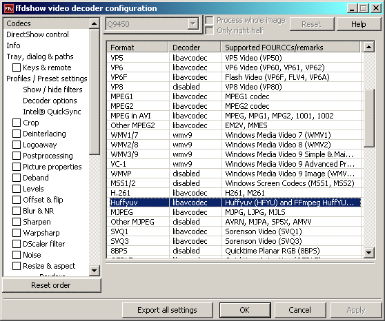

    I also moved Huffy uv to the 'plugins directory' of this Virtual Dub 1.10.4 AMD64
  21. Originally Posted by loninappleton View Post
    Keep in mind that 64 bit VirtualDub will require 64 bit filters and many third party filters are not available in 64 bit versions. If your going to use AviSynth it will also require 64 bit AviSynth and 64 bit AviSynth filters. Again, many third party filter are not available in 64 bit versions. 64 bit AviSyth is also less stable than 32 bit AviSynth.
    Take the + out and replace it with a space. Installing VirtualDub on your desktop will work but it's an unusual place to put it. I don't have the most up to date 64 bit version -- is vdub64.exe the right program? On mine that's the command line version. The GUI version is veedub64.exe. I believe .VCF is the correct extension for 64 bit VirtualDub scripts, but with 32 bit VirtualDub it's .VDSCRIPT.

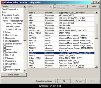

    I made a shortcut to the desktop.
    Moved the default.vcf to the new 1.10.4 directory.
    Edited the shortcut (with a space) as/s"default.vcf" from the previous instruction above.
    [note]
    With all this shortcut business the casual reader should note that the format is
    " " space /s" "
    It's highly confusing and hard to read to get right.

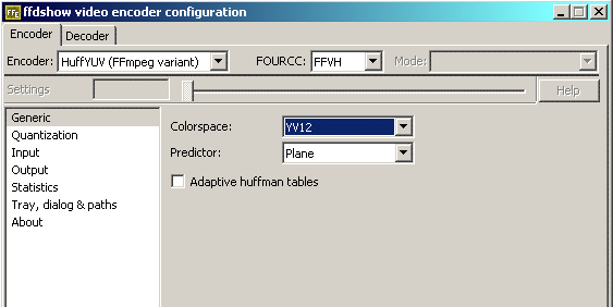

  26. If you have ffdshow installed, maybe use that for encoding instead of the official huffyuv codec. ffdshow will appear in the list of codecs as it does in jagabo's screenshot above. When you select it and click on configure, the window that opens looks something like this:
    And you can choose the ffmpeg version of huffyuv as the encoder. It supports YV12 video, whereas the official huffyuv does not, as far as I know. The only downside is I don't think the official huffyuv codec can decode the ffmpeg version, so it needs to be decoded with ffdshow instead.
    If you have ffdshow installed, there's probably no need to install the official huffyuv codec, unless there's a benefit to using it rather than the ffdshow version that I'm not aware of.
    The ffdshow encoder also includes the FFV1 encoder, which is also lossless. It compresses more, but it's also much slower.
    Edit: And apparently you need to be careful regarding which version of huffyuv you use if you want to compress RGB. Apparently version 2.2 is broken in respect to RGB. It's probably best to stick with version 2.1.1
    http://forum.doom9.org/showthread.php?t=67121
    The ffdshow version of huff doesn't seem to support RGB compression.

    I did find something else though: Range wherein I think begins to answer the original question. In other words it indicates a numeric option to edit.
    You can use Video -> Range to select a range by frame numbers or times. But you can do the same visually using the slider and the Mark-in and Mark-out tools. Or Edit -> Set Selection Start/End.
