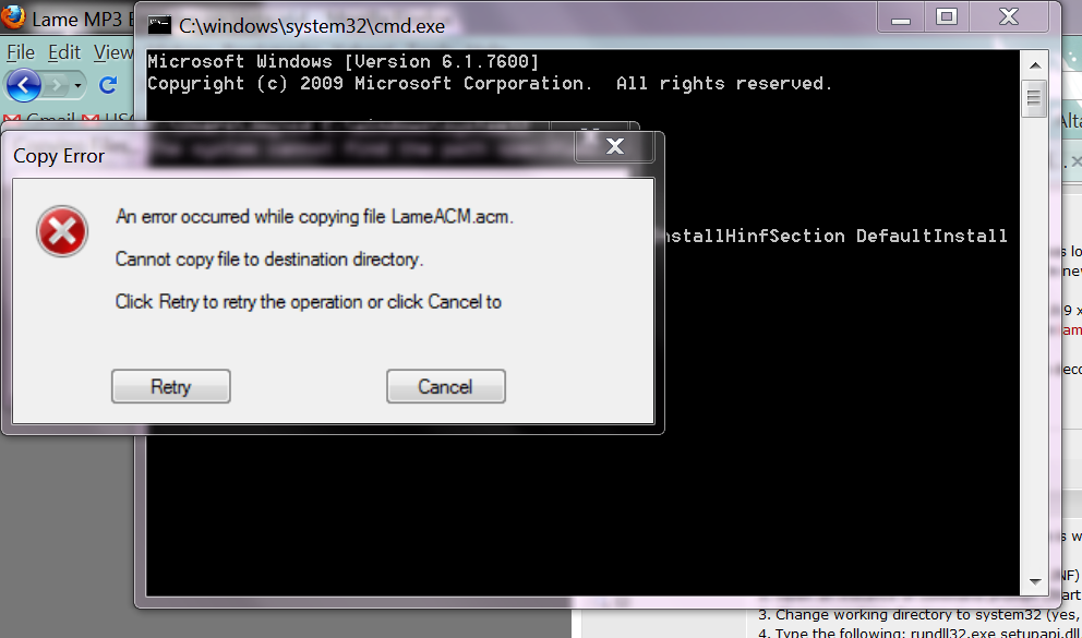

  16. Hi All,
    I've followed every single step as mentioned above, but still receiving the following error message: "An Error occurred while copying file LameACM.acm. Cannot copy file to destination directory.'
    What else should I do in order to get Lam MP3 working in the virtualdub???????

  21. Originally Posted by joylamyy View Post
    Hi All,
    [Attachment 4310 - Click to enlarge]
    Just registered to say that you need to run the command prompt in administrator mode (find it in Start menu, right click>Run as Administrator) if this message appears.
  22. Originally Posted by Clerlic View Post
    Yeah, running as Admin was only mentioned about 5 times earlier in this thread.
