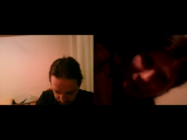

    I've been using Evaer for Skype to record video calls. I realized (very late) that this program really sucks, and switched to Pamela, but in the meantime I recorded a number of video calls with Evaer that present several problems. The one I want to deal with first is images partially rotated. The video shows two images side by side. The one in the left is properly displayed, but the one in the right is rotated clockwise, as you can see in the snapshot below.
    I don't have a clue of how to fix this problem. Is there a way to edit this video and make it look right (i.e. keeping the left part as is and rotating the right part 90 degrees)?

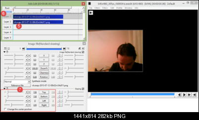

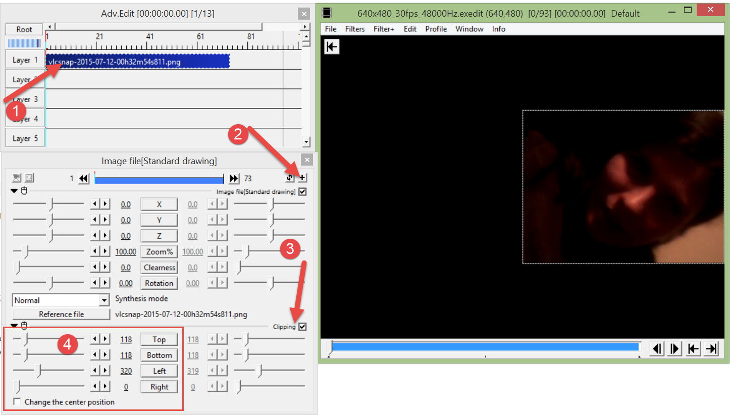

  10. It's pretty easy to do in the free aviutl. There's a bit of a learning curve for any software, but here is a quick tutorial. Another benefit of aviutl is it will import almost any format.
    1) Drag your video onto the advanced editing timeline onto track 1. Click the video layer, and image file [standard drawing] box will pop up if it's not up already. That is where you make adjustments.
    2-4) Push the "+" button in that box in the top right corner (that's where you add filters), and select "clipping". Adjust the crop values so only the right half shows. The dotted line shows the border in the preview and move as you adjust the top/bottom/left/right values. There is a reason why you start with the right side - in aviutl, layers on the bottom "cover up" layers on the top. If you're used to photoshop and layers, it's the opposite

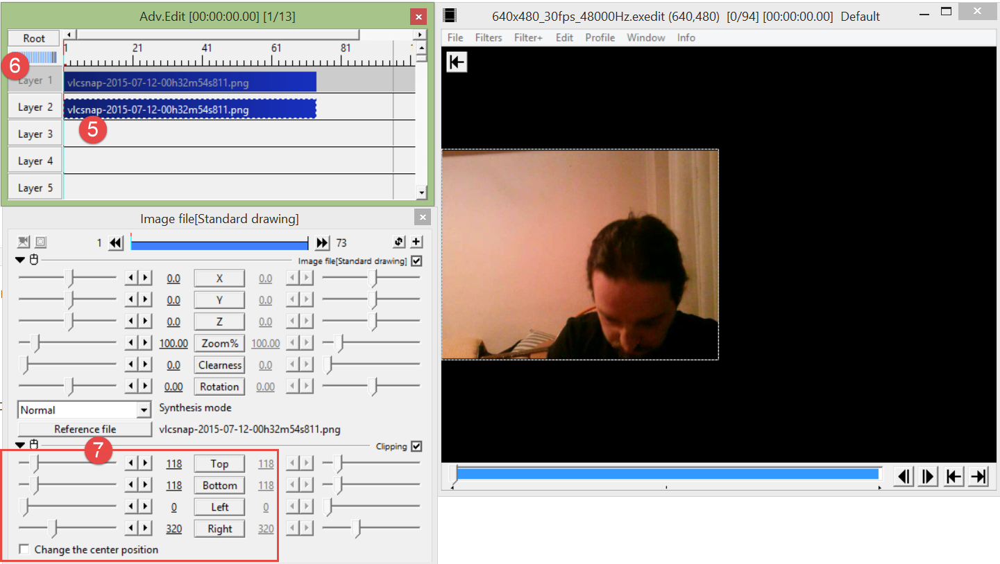

    5) Next, Select the clip on the timeline, right click copy, right click , paste onto layer 2. If you miss aligning them, just left click and drag it over. This copies everything, including the "clipping" (cropping) effect.
    6) If it helps for the next step, you can temporarily toggle the visibility of layer 1 by hitting the layer switch (it will grey out)
    7) So with the layer 2 selected, adjust the crop value so only the left shows.

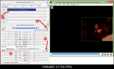

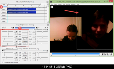

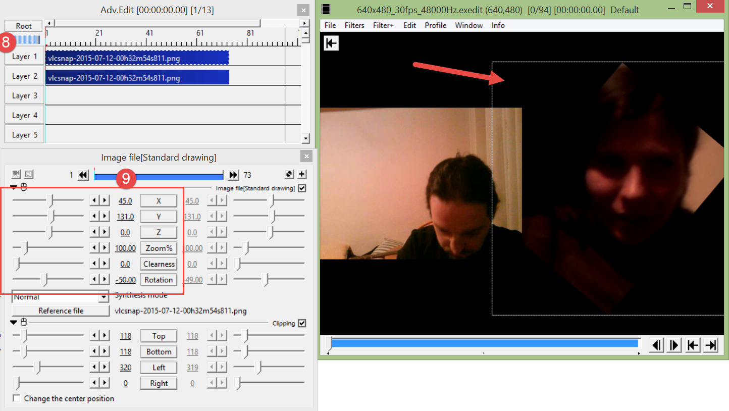

    8) Enable visibility of layer 1 again and select layer 1 clip (it will show dotted line in the timeline when you have a clip selected)
    9) adjust the rotation parameter of clip 1, and x, y position (easier to drag it with the mouse in the preview window). You can adjust the zoom value if you want to scale up or down, to cut off the corners as you desire

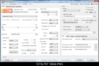

    I would use the x264adv export GUI, with AAC audio . I think there are guides to getting it set up (I think either racer-x or maverick tse in the aviutl thread) . You can access it by using File=>Export with plugin => Adv. x264 Export GUI
    You have to set up the executable paths for x264 and the AAC encoder in the GUI. I would use either QAAC or NeroAAC for the AAC Encoder. Everything else you can probably leave at default, except you might want to adjust the CRF factor . Lower values yield higher quality and larger filesize. Default is 23 which I think is a bit too high for general use (too low quality) . Or if you need a specific filesize you can use 1 or 2 pass bitrate mode. If you get lost on how to set up the x264adv GUI , then just ask either here or in the aviutl support thread

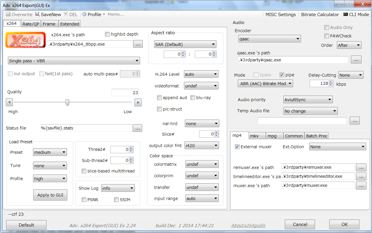

    Hi, I ditched this whole thing quite a while ago because things weren't really working with the lovely woman in the video. Now I want to give it another try. I'm following again the nice mini tutorial posted by poisondeathray but I'm having some issues:
    When I open my video file I receive this error message: "[Warning]: Detected CTS duplication at frame 3". After that the program seems to work well, but I wonder if this has something to do with the next issue.
    When I try to export the edited file the program starts to work, but after all the video rendering is complete I receive the message "File export failed". The program creates a file with the video, but with no audio.
    The console displays this info:
Name:	AviUtl console.png
    Looks like there is a problem with the audio. When I was exporting I did select the paths to the video and audio encoders, and also the paths to the muxer, the remuxer and the timeline editor just in case. I left the rest as it was:
Name:	x264 setup.png
    So, am I doing something wrong? Or maybe it's a problem with my video file?
  17. @alonshow - the error message points to qaac (audio encoding) . Some versions of qaac either require quicktime with apple application support installed, or coreaudiotoolbox.dll plus some other files in a subfolder called qtfiles . (There is a workaround thread regarding qaac specifically on the doom9 forum , if you don't want "apple stuff" installed on your computer - basically it involves extracting a bunch of dll's from the apple installer and putting them in a subfolder). I would make a post in the aviutl support thread referencing this thread , as Maverick will know which version is being called for that aviutl version, and workaround
    https://forum.videohelp.com/threads/366724-Aviutl-Tips-Tricks-and-Support-thread
    Or it might be easier to use another audio encoder like neroaac (but it usually requires you downloading the nero encoder separately), or fdk-aac. I don't recall offhand if Maverick bundled any of them with aviutl. Or even lame MP3 (which won't require any other steps). In terms of AAC, Apple is generally considered the "best" by most people, but at high bitrates, it's difficult to tell the difference between the top AAC encoders
    Or if you weren't making any time edits (in terms of cutting or adding footage, ie changing the length of the video) , it might be better to remux the original audio into the new video , that way you don't lose any audio quality

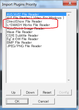

    Try swapping the input plugin order for "L-Smash Works File Reader" and "DirectShow File Reader"
    if that doesn't solve the problem, re-encode the source files once with FFmpeg, Mediacoder, Handbrake,Megui or anything of your choice, play them once to see if they are fine, than feed into AviUtl again.

    The console error disappeared after I installed iTunes manually and the resulting file has the audio now.
    I'm not 100% sure of how I fixed the CTS error, but I think it was what you suggested: swapping the input plugin order for "L-Smash Works File Reader" and "DirectShow File Reader". This is my current plugin order:
Name:	Import plugins priority 1.png
