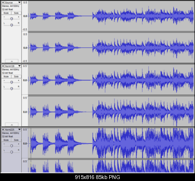

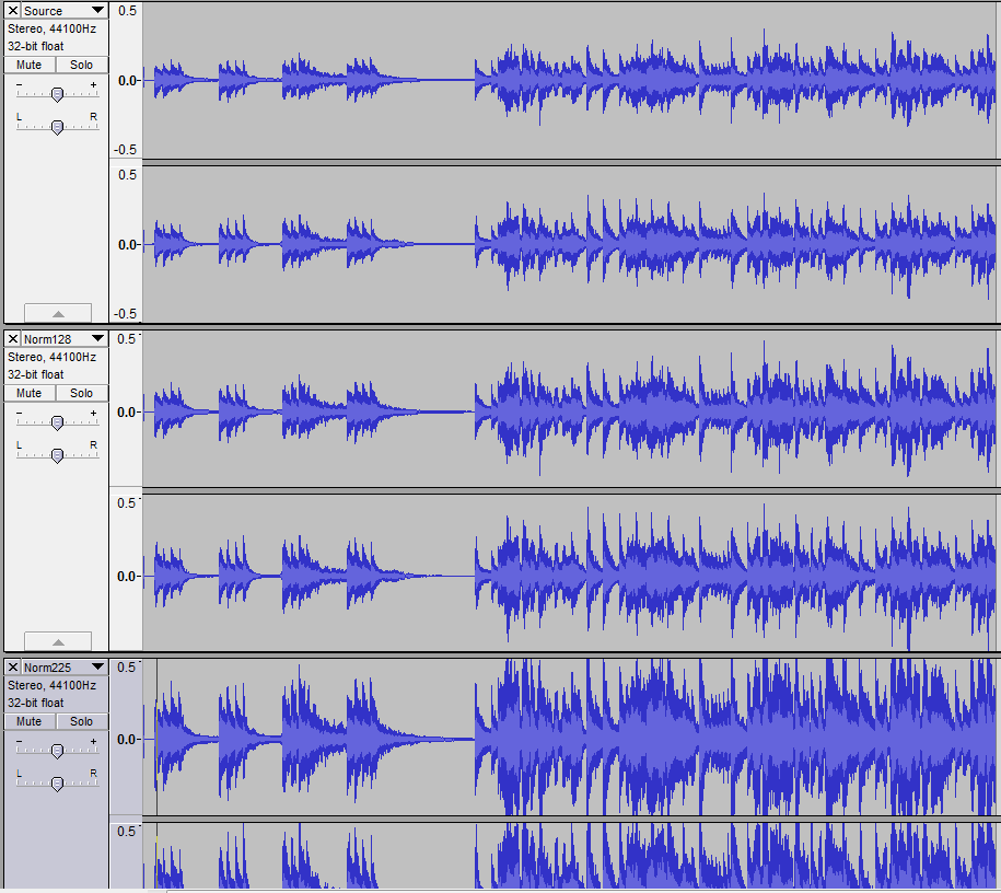

  6. The "Normalize volume" function is tricky to use because
    You CANNOT PREVIEW its effect! The effect will only appear in the encoded file.
    Also if the source audio is already loud enough, there may not be any effect at all.
    Whether you can distinguish the differences after applying this effect would depends on your equipment also.
    Valid range from 0-255, you may treat this range corresponding to 0-100%
    Here I uploaded a few samples that you can verify the effect yourself:
    1. The Source.avi is a short clip with very soft music. Try applying the Normalization function on it.
    2. Norm128.wav: the audio track extracted after applaying Normalization at value=128
    3. Norm225.wav: audio after Normalizing at 255
    If you want to do a listening test, remember to tune down the master volume of the OS/Equipment
    You may also load the wav into Audacity, and you should get a pretty obvious comparison:
