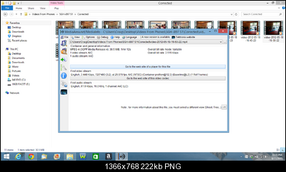

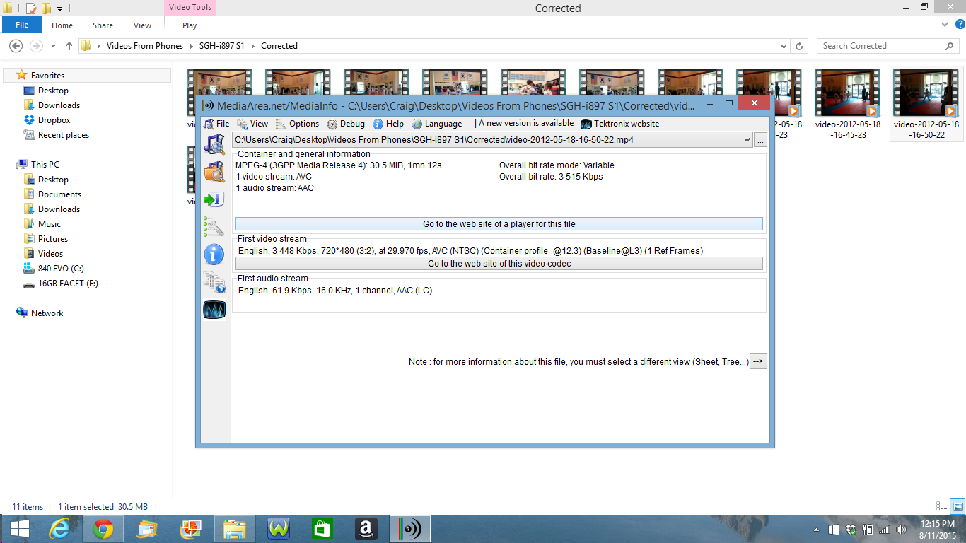

  5. How it looks (photo) and how this will be done (picture)?
  6. Here is a screenshot using Mediainfo before running the batchClick image for larger version

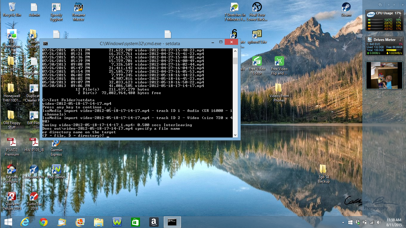

  7. Here is screenshot of bat file where it asks a questionClick image for larger version
Name:	Screenshot 2015-08-11 11.59.39.png

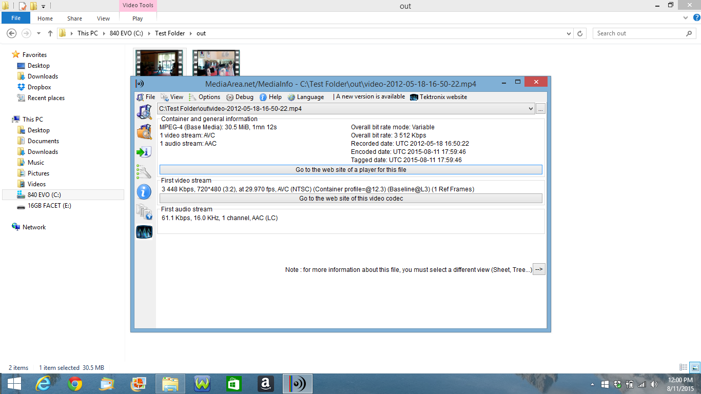

  8. I selected F for file, here is a screenshot of the new file using Mediainfo. The Recorded date is correct, the other two show todays dateClick image for larger version
Name:	Screenshot 2015-08-11 12.00.49.png

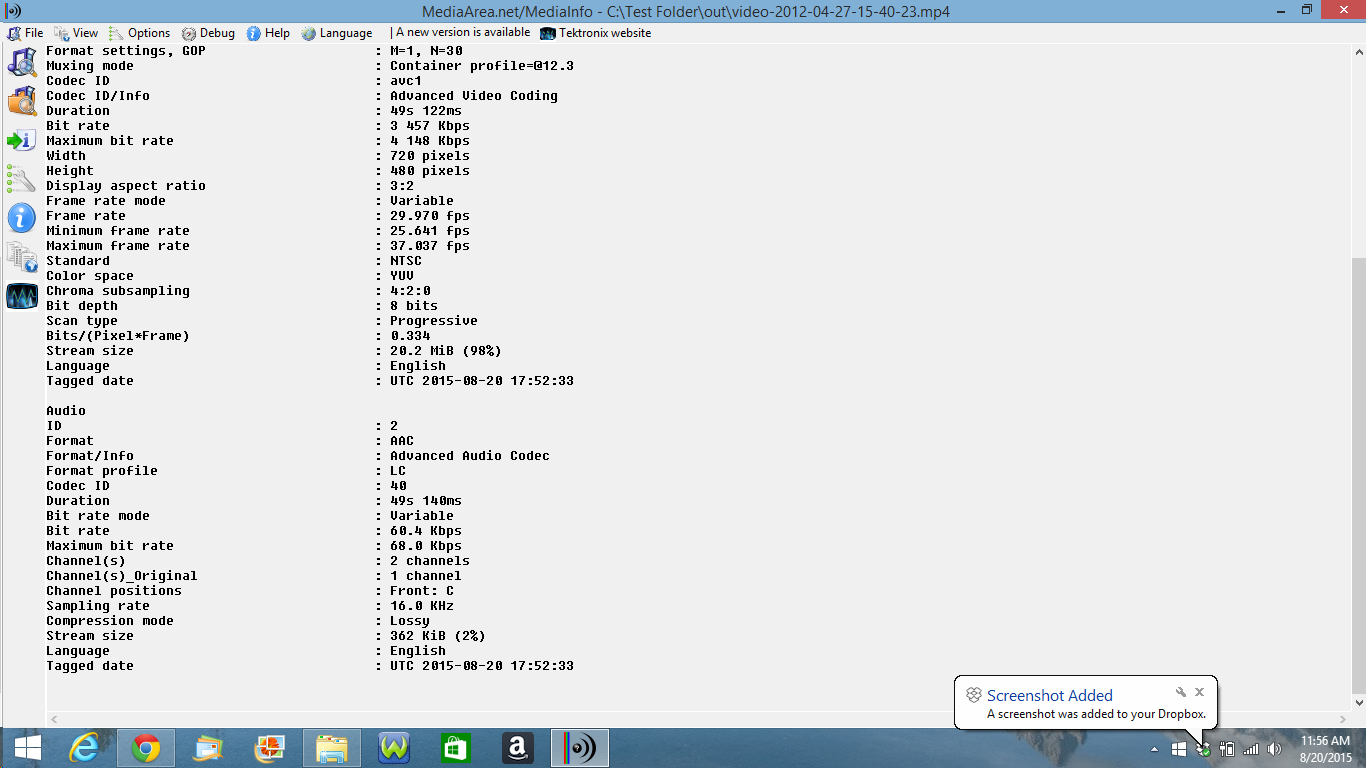

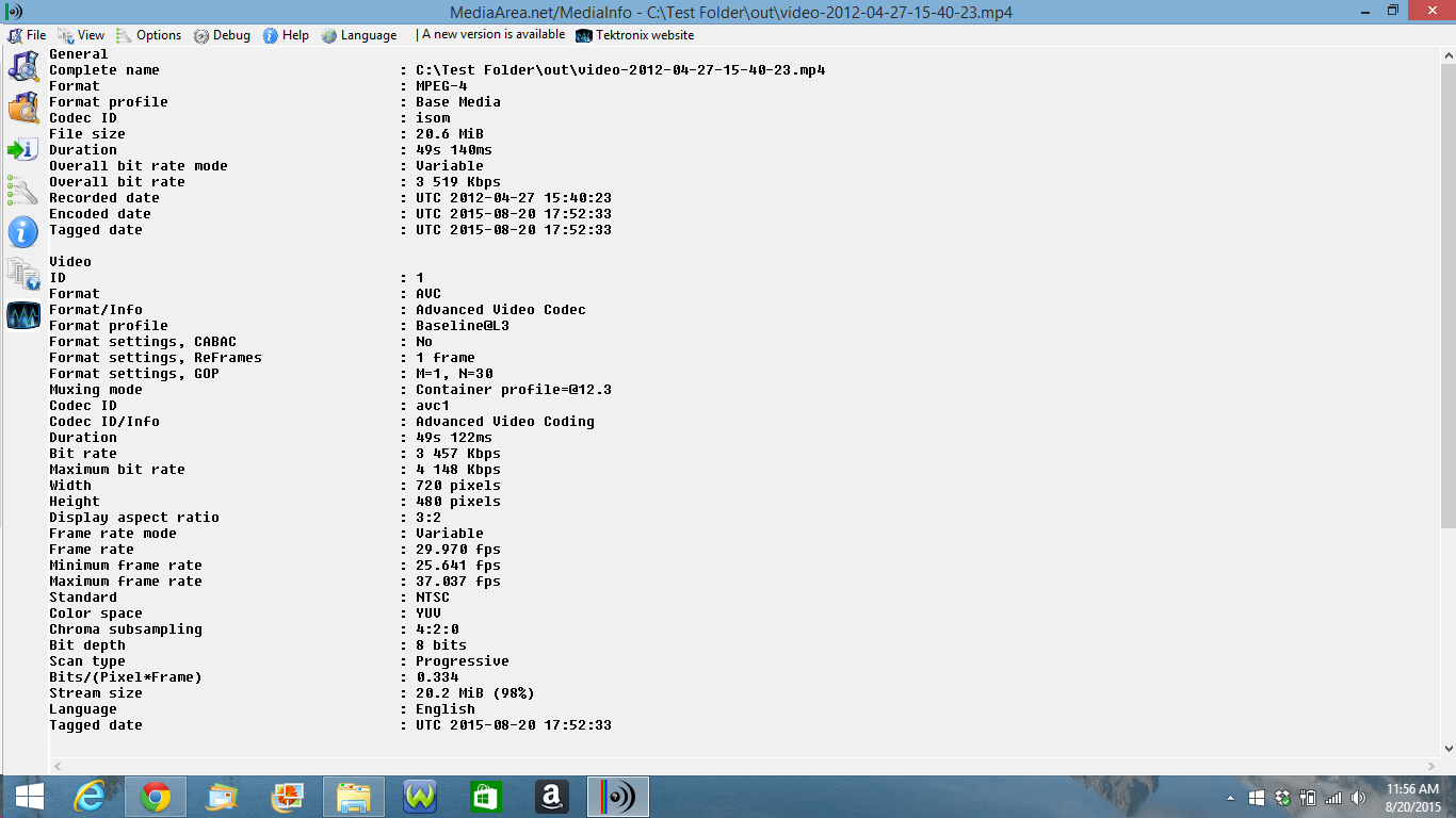

  10. Okay,
    This fixed the batch file errors. BUT, the Encoded Date and Tagged Date are still using today's date.Click image for larger version
Name:	Screenshot 2015-08-20 11.56.26.png
ID:	33236Click image for larger version
Name:	Screenshot 2015-08-20 11.56.30.png
