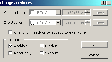

  3. xplorer˛ has the ability to change that sort of thing from it's Actions menu.

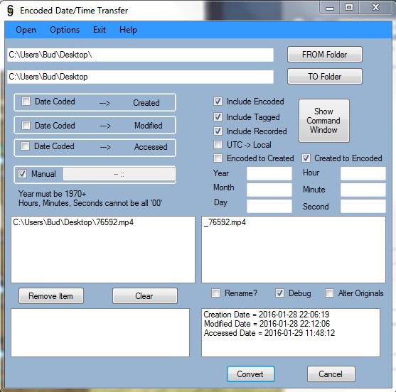

  18. Member Budman1's Avatar
    Jul 2012
    NORTHWEST ILLINOIS, USA
    milkieed,

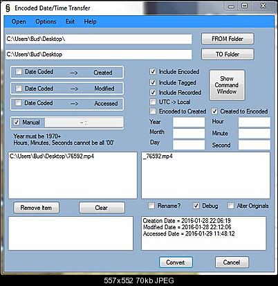

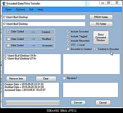

    Okay here is the final version with the UTC to Local ability. Should work same as the last one except for this part. It's simple and error correction is minimal but it should work for you. It's downloadable at: (UPDATED BELOW)
    New link available in other thread
Name:	ScreenHunter_166 Sep. 21 13.16.jpg
Name:	ScreenHunter_57 Feb. 05 21.13.jpg
    [Attachment 23403 - Click to enlarge]
    UPDATE 01-19-2016 New Version with manual set and remove function
    If you Use Manual and do not enter a date it will remove the Encoded/Tagged dates.
    Rough final test so remember to USE COPIES TO TEST AND NOT YOUR FAVORITE VIDEOS until you sure it works.
    Be careful of the ALTER ORIGINAL check box.
    Old Link
Name:	ScreenHunter_189 Jan. 29 11.49.jpg

    Originally Posted by Budman1 View Post
    milkieed,
    https://files.secureserver.net/0sdI6vs83gMRS5.
    [Attachment 23402 - Click to enlarge]
    Thank you Budman1, your answer solved my problem. Is there a new version of this program ?

    UPDATE: I updated the program so you can go Date Created/Modified to Enocoded or Encoded/Tagged to Created. I've updated the image and my download link above also..
    There is only one update and that was to handle the "MOD" extension some cameras save the pictures with. Other than that it was written for a specific use but made available for anyone who might want to do the same things. If there are errors or additional features needed, I could probably update it but for now it should change the date/time okay, using information from MediaInfo that it pulls.
    UPDATE
    Let me know if you need additional features, etc.
    Budman1
    [Attachment 22785 - Click to enlarge]

    Just found this thread and tried your software to change dates for lots of GoPro files. Works great. Thanks.
    wwaag
  24. Member Budman1's Avatar
    Jul 2012
    wwaag , It was very nice of you to let me know the results. So many times the experts here give great suggestions and solutions to people who request help and many times they do not receive feedback or solutions or results. Feedback helps not only the experts but also others that may come across these threads later looking for the same solutions.
    It really means a lot to us to know it worked for you, especially since you were not even the original requester. Thanks you and it's good to know that it works for the Go-Pro files as well for others who may need that.
    Thank You again!
    Budman1
  25. Member wwaag's Avatar
    Jan 2002
    Olympic Peninsula, US
    You're quite welcome. I know exactly what you mean. I participate in a number of editing forums often trying to help the newbies. Sometimes, it's a bit discouraging when you really make an effort to help and get absolutely zero response.
    One question about your program. Although it's always safer to make a copy, would it be possible to simply change the attributes of the original file? It certainly would be a lot quicker. Moreover, the "date created" changes once you copy the file back to the original location.
    wwaag
  26. Member Budman1's Avatar
    Jul 2012
    waab... Yes it is easy to make a version that renames the original or better yet creates a file with the SAME name as the original in another folder. I'm assuming you are copying the altered files back and renaming them to original names since Windows doesn't usually change the Created date by copying but if you change the name, Windows essentially thinks you are making a 'New" file and gives it the current date and time.
    I made a copy because I'm sure someone out there uses the dates as a means to reference the jobs they do as a BUSINESS and if they don't watch their checkmarks and do a batch change, they have more encoded/created dates than they could ever remember.
    Which way are you going? Encoded -> Created or Created -> Encoded? Would you want the files copied with the original Created date into a 'Dated' folder inside the folder that contains your original file? Or just a check mark that causes operations to be preformed on the original files?
    budman1
  27. Member wwaag's Avatar
    Jan 2002
    Thanks for the quick reply. My preferred workflow would be Encoded>Modified and simply a check mark to permit operations to be performed on the original files. No need for copying.
    wwaag
  28. Member Budman1's Avatar
    Jul 2012
    OK. I assume you do not care about Created then? Just Modified? I'll work on it but to be safe, when I send it, try a separate folder with copies in it to be sure. It should just change those without copying again.
  29. Member wwaag's Avatar
    Jan 2002
    Thanks so much.
  30. Member Budman1's Avatar
    Jul 2012
    Okay for WWAAG only I sent a private msg with the link for the program (Zipped EXE) to modify the originals or not. Just replace the EXE file and try it out with a folder with copies of videos to try initial test.
