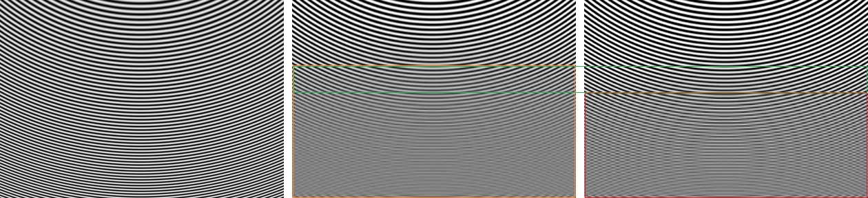

    Here you posted a 1440x1080 zone plate scaled to 720x480 and then via 720x540 vs 640x480. I've highlighted portions of the section that you cropped. Very roughly eyeballed, orange is where the 720x540 becomes mushy, red is where the 640x480 breaks down, and green is where the 640x480 retains better definition than the 720x540.
Name:	Newpball scaling comparison.png
    The 640x480 looks mainly worse in the red section, but that's because this is an artificial scenario where the horizontal resolution has been constructed to be fully utilized. You should be able to show the same thing using something like Big Buck Bunny or other CG content. Neither case is the same as an image filtered by a lens hitting a sensor, that's then processed and compressed.
