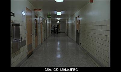

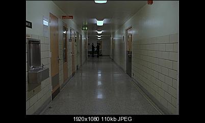

  7. OK, so here are images from all the different encodes, and the original, as seen on both my computer and TV.
    ORIGINAL Video from DVD in MPC-HC:
    [IMG][/IMG]
    648x480 with DAR = 4:3 (from MPC-HC)
    [IMG][/IMG]
    648x480 with DAR = 16:9 (from MPC-HC)
    [IMG][/IMG]
    710x480 with DAR = 4:3 (from MPC-HC)
    [IMG][/IMG]
    710x480 with DAR = 16:9 (from MPC-HC)
    [IMG][/IMG]
    NOW Pictures that I took from my Actual TV Screen showing the same video filling up the entire 16:9 Widescreen 1080p TV screen.
    ORIGINAL - As seen on my TV Screen
    [IMG][/IMG]
    648x480 DAR=4:3 (ON TV SCREEN)
    [IMG][/IMG]
    648x480 DAR=16:9 (ON TV SCREEN)
    [IMG][/IMG]
    710x480 DAR=4:3 (ON TV SCREEN)
    [IMG][/IMG]
    710x480 DAR=16:9 (ON TV SCREEN)
    [IMG][/IMG]

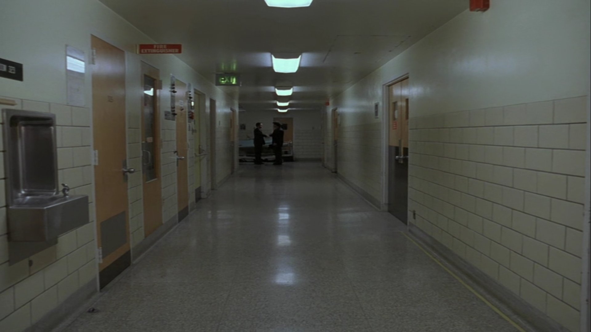

  13. Originally Posted by manofsteel31 View Post
    For being Scaled or Stretched, the picture still looks "normal" to me.
    That's because there's nothing in the frame that's of identifiable aspect ratio. Find a frame with a round ball, globe, or a car tire viewed directly from the side. Or something you know should be square, viewed head on. It will be much more obvious.
    4:3 (correct DAR):
    16:9 (incorrect DAR):

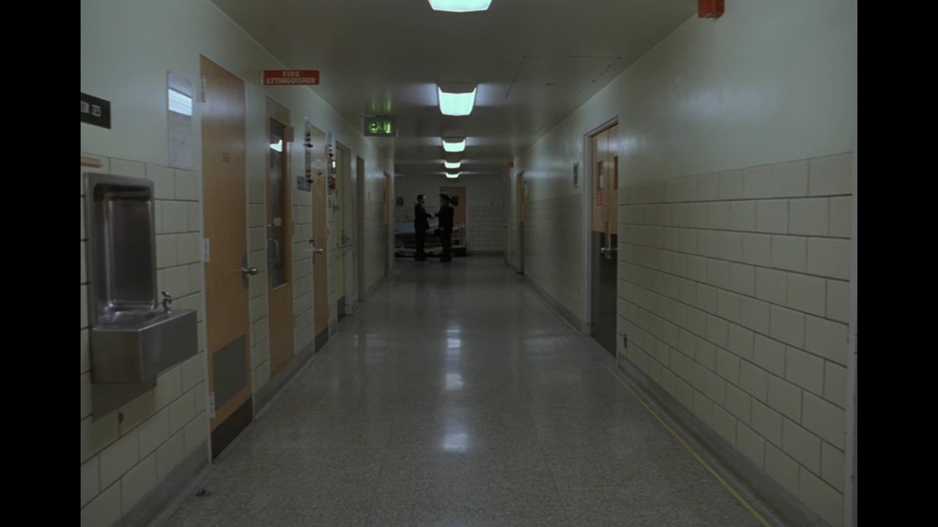

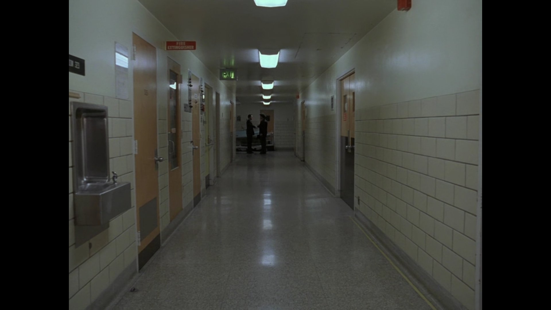

    Looking at your pics it appears your video is 4:3 but your TV is even stretching the 640x480 4:3 encode to fill the screen. There must be a setting to stop it doing that. If your TV is the same as mine when playing a video via USB press the Tools button on the remote. I have three options for picture size. "Original", "mode 1" and "mode 2". The first doesn't resize, the second resizes until the height or width fill the screen, and the third stretches to fill the whole screen. Mode 1 is the mode you'd want. That should play the 4:3 video fullscreen with black bars down the sides. Try the 640x480 encode with square pixels first. When that's displaying correctly, try the anamorphic 710x480 encode. If it displays a bit wider than the 640x480 encode then the TV doesn't obey the aspect ratio and for video to display correctly you'll need to resize to square pixels rather than use anamorphic encoding.
    For the record, if you use the MPC-HC File/Save Image menu for saving screenshots, it'll save them with the wrong aspect ratio if they're anamorphic. MPC-HC will save a 4:3 720x480 DVD as 720x480 even though it's displaying it as 640x480 (4:3). For anamorphic video you need to use Alt+PrintScreen (on your keyboard) and save the screenshot manually, or use MPC-BE instead. I'm pretty sure it saves screenshots with the correct aspect ratio for anamorphic video. I think MPC-HC is confusing the issue at the moment.
    Notice how these two screenshots from your post #7 look exactly the same:
    That's probably because MPC-HC doesn't obey the aspect ratio when saving screenshots even though it should be displaying the video itself differently.
    648x480 with DAR = 4:3 (from MPC-HC) would be correct and it's also how the picture should be displayed.
    Notice how the pic "710x480 with DAR = 4:3 (from MPC-HC)" is slightly wider. Once again, that's probably because MPC-HC isn't obeying the aspect ratio when saving screenshots, Don't let that confuse you.
    A few pics in case the whole thing's confusing you a bit (it does at first).
    A video with an exact 4:3 aspect ratio should display like this when using your TV's USB media player, if it's displaying correctly. Whether it be 640x480 with square pixels or some other resolution with a 4:3 aspect ratio, it should display like this:

    If you play a 710x480 anamorphic encode with an exact 4:3 aspect ratio it should look the same as above. If your TV ignores the aspect ratio it'll display it as 710x480 worth of square pixels and the picture will be a little stretched. Not a huge difference for 4:3 NTSC, but still wrong. It probably means you won't be able to use anamorphic encoding.
    Currently, our TV appears to be doing something like this to the picture:

  18. Originally Posted by hello_hello View Post
    Looking at your pics it appears your video is 4:3 but your TV is even stretching the 640x480 4:3 encode to fill the screen. There must be a setting to stop it doing that. If your TV is the same as mine when playing a video via USB press the Tools button on the remote. I have three options for picture size "original", "mode 1" and "mode 2". The first doesn't resize, the second resizes until the height or width fill the screen, and the third stretches to fill the whole screen. Mode 1 is the mode you'd want. That should play the 4:3 video fullscreen with black bars down the sides. Try the 640x480 encode with square pixels first. When that's displaying correctly, try the anamorphic 710x480 encode. If it displays a bit wider than the 640x480 encode then the TV doesn't obey the aspect ratio and for video to display correctly you'll need to resize to square pixels rather than use anamorphic encoding.
    A video with a 4:3 aspect ratio should display like this when using your TV's USB media player, if it's displaying correctly.
    LOL ... Your exactly right. I had my TV set to "mode 2" which forced all videos to fill up the entire screen. As soon as I switched it to "mode 1" the video filled the screen from top to bottom but gave me the Black Bars on both sides.
    I re-tested all the encodes on the TV using Mode 1 and yes the 710x480 was wider that the 648x480 video. The 710x480 was also closest to the ORIGINAL video's size as well, but I assume thats because the original is simply being read as 720x480 by the tv and its not paying attention to the 4:3 aspect ratio.
    Also, the two 710x480 looked the same and the two 648x480 videos looked the same. So the DAR I specified as 4:3 vs 16:9 when I encoded them seems to be ignored. Either that or MeGUI is ignoring my choice because even though I encoded 2 copies of each size with different DAR values, MediaINFO lists them as the same. The 648x480 videos with DAR values of 4:3 and 16:9 both show in MediaInfo as 4:3. And both 710x480 videos show as 3:2. Not sure why that is?
    So given all that, what exactly is your recommendation? Are you saying I should just resize directly to 640x480 or 654x480 or do those numbers need to change due to how much each video or cropped, or what?
    Just tested similar videos encoded at 720x480 on 3 different apps on my iPad and they all filled the whole screen without any black bars on the sides either. Perhaps all 3 apps have default settings to automatically stretch the image to fill the screen as well. Not sure.
  19. My Samsung TV's USB media player ignores any aspect ratio and displays the video as though it contains square pixels, so I have to resize to square pixels. If your TV is the same, I guess you'll need to do likewise.
    Probably. Try a 16:9 DVD. If it doesn't display as 16:9 the TV is ignoring the aspect ratio. I'm sure mine ignores it no matter what the video type. "Mode 2" can fix it if the video is actually 16:9, but other than that, you're out of luck.
    You're not confusing the Input DAR with the output are you? If you're referring to setting the Input DAR then normally you don't (aside from choosing ITU or not). The Input DAR will be what it is. You crop etc and for anamorphic encoding MeGUI should calculate the correct output DAR (it'll be listed at the top under the Script tab if you're using anamorphic encoding). There's nothing for you to set, as such. Of course if you set the Input DAR to 16:9 and don't crop or resize the output should be 16:9 if anamorphic encoding is enabled. Same if the Input DAR is set to 4:3, even if it's not the correct Input DAR.
    I'm not 100% sure what your process is there, but MeGUI will only set the correct output DAR if anamorphic encoding is enabled. If it's not enabled, you need to resize to square pixels.
    Yes, they need to change according to how much is cropped. Resize to square pixels so the aspect ratio distortion is close to zero as possible.
    I resize to square pixels so I don't need to worry about aspect ratio issues (and because I have to if I'm using the TV's media player). That's up to you though. Either way, ideally you'd not resize the height. For square pixels, crop as required, then resize the width to give you the correct aspect ratio. For a 4:3 DVD that might be 640x480 (assuming no top or bottom cropping). For a 16:9 DVD that might be 854x480 (you'll need to enable MeGUI's up-scaling for that one as I explained earlier).
    Having said all that, I do what I want, not necessarily what's "ideal". So sometimes I resize the height a bit after cropping and/or adjust the cropping so I can resize to exactly 4:3 or 16:9 dimensions. I tend to resize PAL DVDs to 960x540 when "ideally" you'd probably resize to 1024x576 (no height resizing). In other words...... it's up to you how you do things, but for resizing to square pixels, keep the aspect ratio distortion as close to zero as you can.
