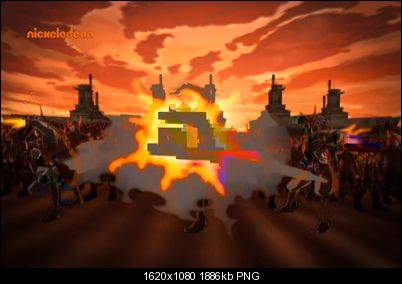

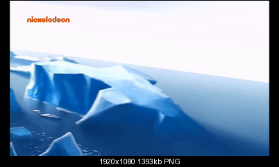

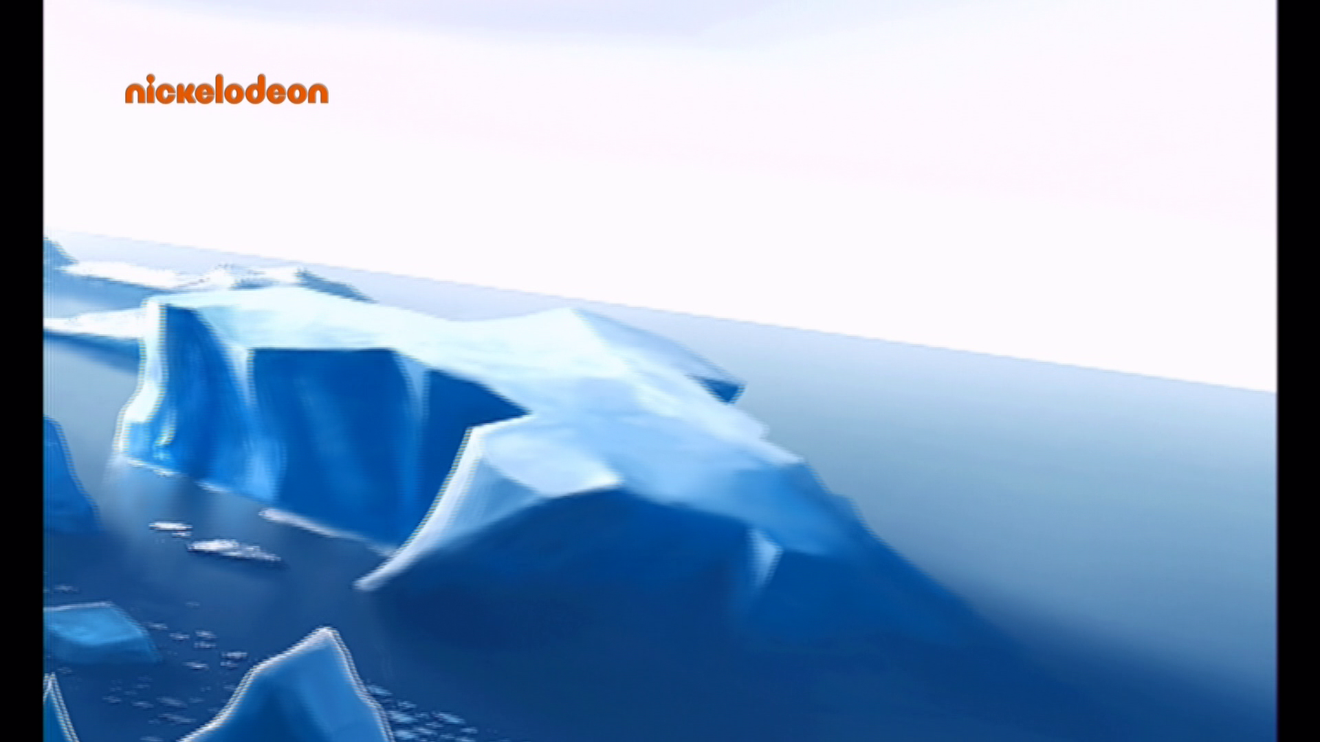

  1. I have a tv capture that needs some magic. It's a stretched, cropped, sped up and upscaled to 1080i video of Avatar: The Last Airbender. The DVDs I bought way back are full of halos and blending, something this capture doesn't have for what I've seen. It looks like it has about the same interlacing issues I had with another capture, except for the fact I now have an untouched TV capture and this show was made in NTSC land.
    I have this avisynth code:
    ffVideoSource("Clip1.mkv")
    AssumeFPS(50)
    Crop(66,0,-66,-0)
    TFM()
    QTGMC().SelectEven().SelectEven()
    Spline36Resize(1620,1080)
    ColorMatrix(mode="rec.709->rec.601")
    Changing AssumeFPS to 25 and removing one SelectEven results in 25fps video that looks more like 12.5fps.
    Compared to the DVD, the right aspect ratio is about 3:2 after cropping the black side bars.

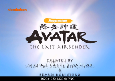

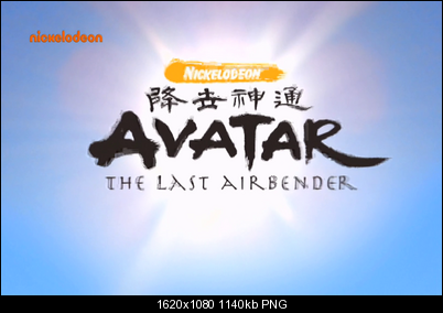

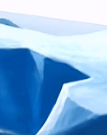

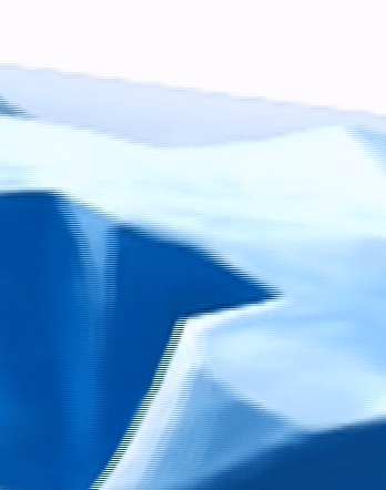

    The panning movement doesn't seem smooth, it does produce some blocking/flickering, and the lines are blocky
    Does anyone know how I can rid of this?
    Also, is it possible to slow it down (25->24/23.976 fps) inside avisynth? I now use tsmuxer for that.

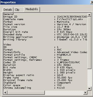

  5. Originally Posted by manono View Post
    when opening it using FFVideoSource in an AviSynth script it shows every other frame to be a duplicate.
    That's a longstanding bug in ffVideoSource and some interlaced AVC. The clips are 25i. Specify the frame rate in ffVideoSource:
    ffVideoSource("filenmame.ext", fpsnum=25000, fpsden=1000)

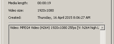

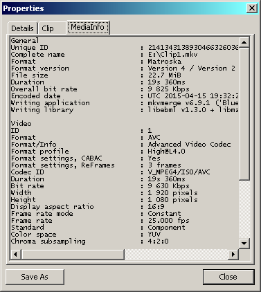

  6. 25i? So even MPC-HC is wrong when saying it's 50fps? One wouldn't think it would be so difficult to find the correct framerate. So I guess everything I wrote for pub was wrong. Thanks for the correction. Here are a couple of pics from MPC-HC taken from his Clip1.mkv:
    Image Attached Images

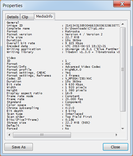

  7. MPCHC (updated about 3 months ago) on my computer simply says 25 fps interlaced.
  8. My MPC-HC and your MPC-HC don't seem to be in agreement (jagabo beat me to it).

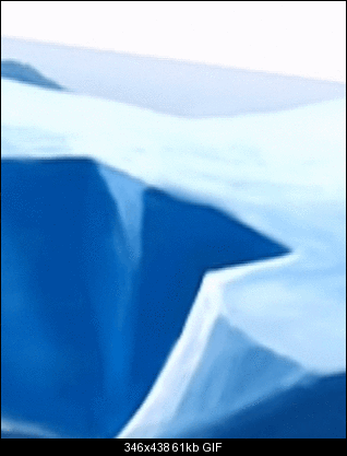

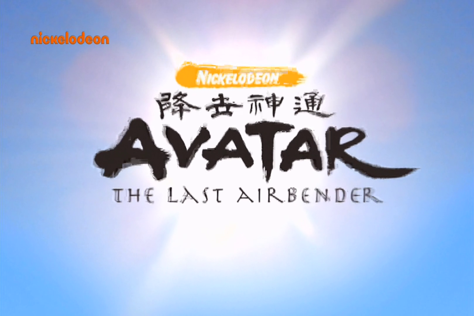

  11. I've only looked at the first three clips but Clip 3 still has me a little puzzled. When I play it in MPC-HC I see wobbly lines, but there's a distinct clean/dirty pattern (seems mostly like 2:2). Same when looking via Avisynth, only there's a clean/dirty combing pattern. What's causing that? I'm indexing with L-Smash because the version of ffmsindex I have keeps dummy spitting with this one.
ID:	31283 Click image for larger version

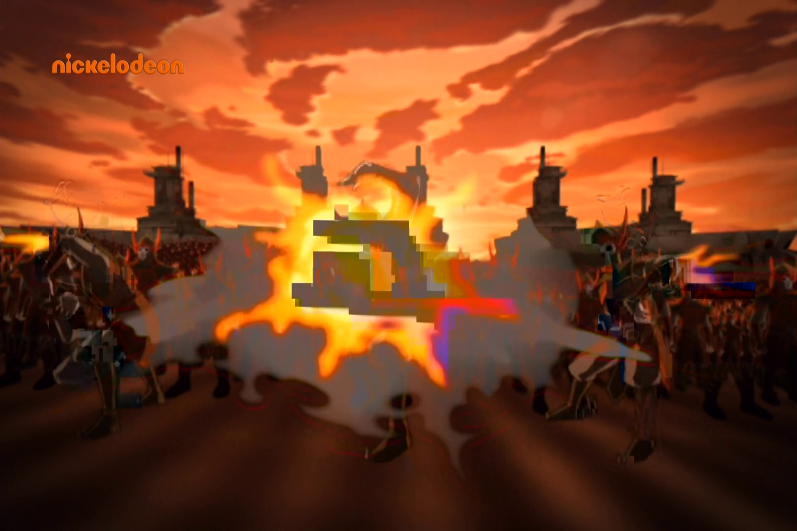

    Results with this when I use Clip2.mkv:
    Is this a ffVideoSource error, is my source that bad or is it something else?
  14. Try ffVideoSource("Clip2.mkv", fpsnum=25000, fpsden=1000, seekmode=0).
