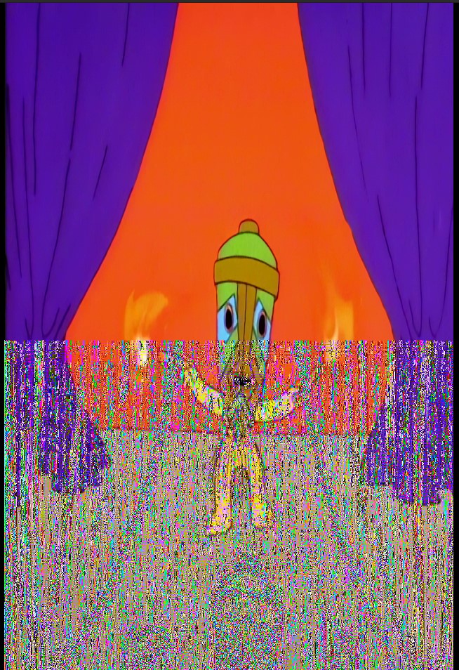

  8. As I started Season 9 I bumped into the reality of 10-bit x264 and, after I made the mistake of comparing its output quality to that of 8-bit x264, I've decided to upgrade to 10-bit. However, I'm not quite sure how this changes my script:
    # Set DAR in encoder to 6480 : 4739. The following line is for automatic signalling
    global MeGUI_darx = 6480
    global MeGUI_dary = 4739
    LoadPlugin("F:\[0]StandAloneApps\MeGUI-2500(core)2443(data)0.3.5(libs)[Portable]\tools\ffms\ffms2.dll")
    FFVideoSource("SourcePath", fpsnum=30000, fpsden=1001, threads=1)
    ### Deinterlace ###
    LoadPlugin("F:\[0]StandAloneApps\MeGUI-2500(core)2443(data)0.3.5(libs)[Portable]\tools\avisynth_plugin\TIVTC.dll")
    TFM(Order=-1,Mode=5,Slow=2,CThresh=6).TDecimate(Mode=1,Cycle=15,CycleR=3)
    Vinverse()
    ### Deshaker ###
    Stab(Mirror=15)
    ### Crop ###
    Crop(8,0,-8,0)
    ### Resize ###
    RatioResize(10/11.0,"PAR")
    ### Gibbs Noise Block ###
    Edge=MT_Edge("prewitt",thY1=20,thY2=40).RemoveGrain(17)
    Mask=MT_Logic(Edge.MT_Expand().MT_Expand().MT_Expand().MT_Expand(),Edge.MT_Inflate().MT_Inpand(),"xor")
    MT_Merge(dfttest(),Mask,Luma=True)
    ### Overall Temporal Denoise ###
    SMDegrain(tr=2,thSAD=600,ContraSharp=True,RefineMotion=True,Plane=0,Lsb=True,Lsb_Out=True,PreFilter=2)
    ### Debanding ###
    GradFun3(thR=0.55,Radius=12,Mask=2,SMode=1,Lsb=True,Lsb_In=True, StaticNoise=True,Y=3,U=3,V=3)
    DitherPost(Stacked=True,Prot=False,Mode=0)
    ### Line Darkener And Thinner ###
    FastLineDarkenMod(Strength=20,Prot=6,Thinning=0)
    aWarpSharp2(Blur=4,Type=1,Depth=3,Chroma=2)
    From what I understand 10-bit x264 doesn't need dithering. So in the above script SMDegrain is converting to 16-bit with Lsb=True, then sending this 16-bit output to GradFun3 with Lsb_Out=True, then GradFun3 is processing this 16-bit input with Lsb_In=True and outputing 16-bit to Dither for conversion to 8-bit before sending it to x264 10-bit. What I can't figure out is how to skip the Dither conversion to 8-bit and instead send the GradFun3 16-bit output directly to x264 10-bit. Or is the Dither 16-bit-->8-bit necessary for the line darkening and thinning? Thanks for any help .

  12. After reading the Dither tools documentation and a bit of trial-and-error I came up with:
    SetMemoryMax(256)
    SetMTMode(3,3)
    ### Deinterlace ###
    SetMTMode(5)
    TFM(Order=-1,Slow=2,PP=0).TDecimate(Mode=1)
    SetMTMode(2)
    Vinverse()
    ### Deshaker ###
    Stab(Mirror=15)
    ### Crop ###
    Crop(8,0,-8,0)
    ### Resize ###
    ### Overall Temporal Denoise, Could Probably Be Optimized ###
    ### Debanding ###
    GradFun3(thR=0.55,SMode=1,Lsb=True,Lsb_In=True,StaticNoise=True)
    DFTTest(Lsb=True)
    F=DitherPost(Mode=-1)
    S=F.FastLineDarkenMod(Strength=24,Prot=13,Thinning=0).aWarpSharp2(Blur=4,Type=1,Depth=3,Chroma=2)
    D=MT_MakeDiff(S,F)
    DitherPost()
    MT_AddDiff(Last,D,U=2,V=2)
    ### Preview Source OR Send 16-bit Output To x264 10-bit ###
    # DitherPost()
    Dither_Out()
    which output wrong color space, wrong aspect ratio video. However, adding:

  25. I'm really really sorry to dig this thread up, but I've been encoding my Simpsons NTSC dvds myself and this script is by far the closest I've got to making them look good.
    I'm a total noob at this but I have taught myself enough of AviSynth to bodge my way through (had to remove the LSB comment from SMDegrain for example). I've used this most recent script and the output I get is actually really quite nice. However I want to use the non upscaled point so when I comment this in:
    ### Resize ###
    LinearResize(640,480,Kernel="Bicubic",A1=-0.5,A2=0.25,Lsb_In=True,Lsb_Out=True)
    I get this:
    [Attachment 74946 - Click to enlarge]
    As you can see, not ideal.
    If I leave it upscaled I do get the correct output, I think, but I'll be honest, I have no idea when it comes to using CRF or the command lines mentioned.
    Sorry for the necro again, just looking for some help.
  26. Hi drojman, thanks for the painful memories, ha ha. I, as you, was learning on the fly with MUCH help from the geniuses here (and elsewhere) and, after all these years, I've forgotten quite a bit being a mere hobbyist (I still encode Blu-ray sources regularly but haven't dealt with DVDs & interlacing in ages). I used MeGUI as a front end for AviSynth (that's where I made the CRF and command line changes); what are you using? Also, why are you unwilling to upscale your sources? I'd happily upload my stand alone version of MeGUI with all my presets and plugins if you think it would help you, and I'll try to wrap my head around your issue.
    Edit: Maybe try:
    ### Resize ###
    LinearResize(640,480,Kernel="Bicubic",A1=-0.5,A2=0.25)
    without the "LSB" bits or, if not wanting to upscale, just delete the resize line.
    EditEdit: This is my current NTSC Simpsons script after making changes to various versions of various things:

    EditEditEdit: Well, it seems I've made so many changes with plugins, etc. that my latest above script causes MeGUI to crash. More testing...
    Last edited by LouieChuckyMerry; 18th Nov 2023 at 18:57. Reason: Information, Information
  27. I think I am now you from the past! I'm very happy you still post here
    Part of the problem I think is I was using standalone AviSynth + and MeGUI, even the script with upscaling that was working for me would just crash or not open in MeGUI, so I would be absolutely thrilled if you could share your setup, that (hopefully) would save me a huge headache.
    As for why I like to keep the non upscaled version...I'm not honestly sure I can give you a good reason, it's just something I've been trying to do for so long that now I feel like I just need to get my head around it. I realise that's ridiculous, and I fully intend on also having upscaled versions for Plex - the Disney plus versions for me go too far in the filtering and look very off. The script that I was able to run earlier looked great to me, if only I could get it working properly!
    Thank you.
  28. Give me some time; I need to finish a couple things this afternoon but will attack this evening .
  29. I appreciate you even taking a look
  30. The perfect cure for a MASSIVE self-inflicted hangover . Anyway, it turns out that the crash isn't caused by my script, it's a couple additions made by DGIndex (I used the .m2v video as my source at first and MeGUI defaults to DGIndex for that file type). DGIndex adds two lines, one to load the DGDecoder.dll and one to load the ColorMatrix.dll, despite the fact that they auto load. Neither FFMS nor L-SMASH adds those line so they work fine. Keeping the source in an .mkv container makes L-SMASH the default indexer and all is well (Just don't inform jagabo that I did that, ha ha). So the last script I posted works well...oops, not so fast. As I was typing I was running four tests with the same thousand frame section of the source: the .m2v indexed with DGIndex (with the problematic lines corrected), the .m2v indexed with FFMS, the .m2v indexed with L-SMASH, and the .mkv indexed with L-SMASH. And now I remember why jagabo had me strip my sources to .m2v files and use DGIndex: the L-SMASH and FFMS .m2v indexes and the L-SMASH .mkv index all cause problems that lead to audio sync issues. Arggg! Anyway, I'll head to the MeGUI "General Questions And Troubleshooting" thread at doom9.org and ask if it's possible to have DGIndex stop adding those lines. In the meantime, a (somewhat inelegant) workaround would be to index all your sources as .m2v with DGIndex then use a combination of a search program like Everything and source editor like Notepad++ to batch correct the offensive lines (you'd use Everything to search your main source folder and subfolders, then specify ".avs", then open all of those with Notepad++, then use "Find-Replace" to fix all the lines at once). Yea haw! Ahhh, I'll upload my stand alone MeGUI with presets and my AviSynth plugins folder and PM you a link. As for the bad lines, I'll edit my above script so that the bits that need to be deleted are in red.
    Edit: Er, I forgot that the above script doesn't include those lines, just a moment...
