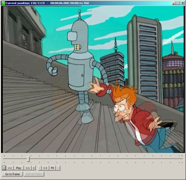

    And here's a sample from my PAL DVD's: S1.E1-FuturamaSample[PAL]
    Suggestions for a change to the "### Deinterlace-Match Fields-Decimate ###" section that would cleanly decimate the PAL video to 23.976 fps are much appreciated.
    EDIT: I'm much more interested in quality over speed.
    Last edited by LouieChuckyMerry; 14th Apr 2019 at 13:16. Reason: Information. Information...
  6. Is the sample typical or an anomaly?
    Because pretty much all it needs is
    TFM()
    AssumeFPS(24000,1001)
    Except for the glitch around frame 118, but there's blending in both fields, so you either live with some blending for a frame, or you take it out and there'll be a glitch in the motion. Both top and bottom fields are blended for a couple of frames, so I don't think there's any way to extract a clean one.
    I had a look at your script, but it made my head hurt and I had to lie down for a bit.
    So the attached thingy is:
    mpeg2source("D:\S1.E1-FuturamaSample[PAL].d2v", cpu=6)
    TFM()
    SomeFilteringCopiedFromAScriptStillOnMyHardDriveSoImNotClaimingItsClever()
    ExtraBandingBeGone()

  8. Originally Posted by LouieChuckyMerry View Post
    How would one "take it out"? Any way to replace it somehow, like duplicating a "clean" frame next to it?
    I've never tried to interpolate missing frames, but I think there's a function for it.
    Much of the time, I'd repeat a frame and drop the problem one if possible
    Trim(0,117) + \
    Trim(117,117) + \
    Trim(119,0)
    but there's too much motion and you can see the glitch. Fortunately, there's plenty of motion where the blended frame happens so it's pretty hard to spot.
    You can minimise the blending by bossing TFM around a bit. I think it was something like this:
    A = TFM()
    B = TFM(pp=3, field=0)
    A.Trim(0,117) + \
    B.Trim(118,118) + \
    A.Trim(119,0)
    If I remembered the frame numbers correctly, it'll match and de-interlace in the other direction, and there's less blending, but it adds a slight glitch to the motion.

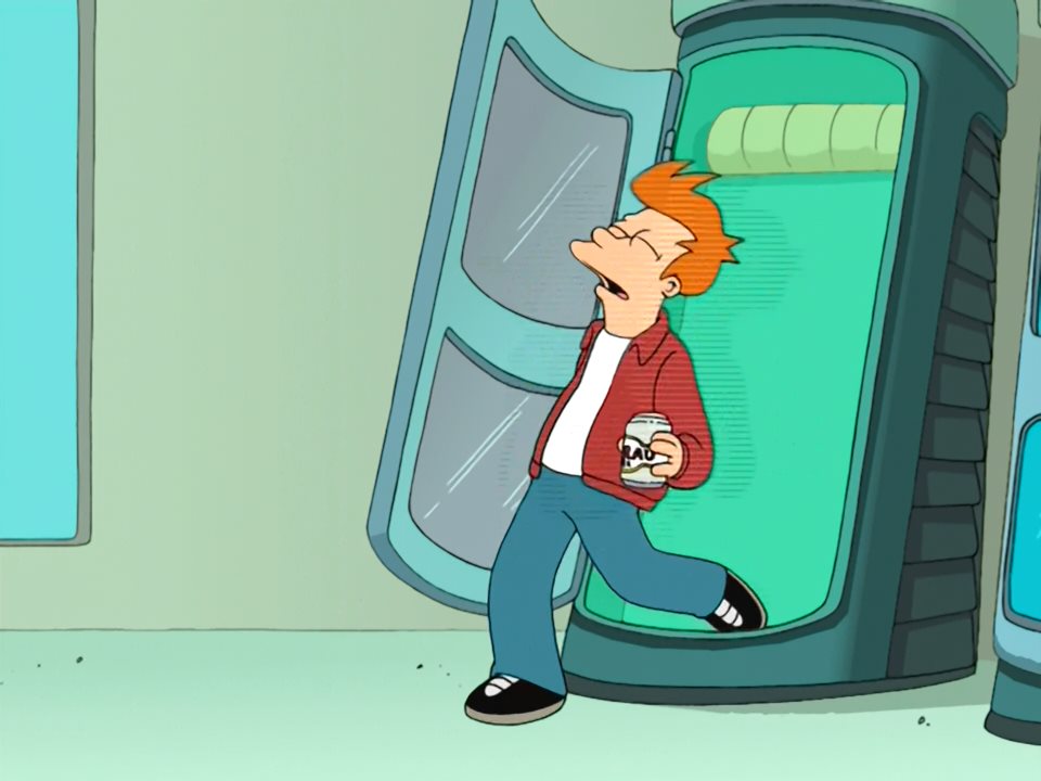

  10. Originally Posted by LouieChuckyMerry View Post
    I didn't have much luck with frame interpolation so I used a picture editor (Photofiltre) to first fix frame #118 and AviSynth to stick it back into the video:
    TFM()
    Q=ImageSource("118.bmp",End=118).ConvertToYV12()
    ReplaceFramesSimple(Last,Q,Mappings="118")

    What's up with that? I let a single episode run overnight and MediaInfo shows 23.976 fps but the time of the episode seems to have about doubled and it does play in slow motion.
  19. Originally Posted by LouieChuckyMerry View Post
    After my last post (see the EDIT) I ran a test with:
    QTGMC()
    SRestore(23.976)
    and the rest of the script the same, and the results were very interesting; the horizontal artifacts--please, what are they called--were still there but the single bad frame was gone. Then I ran the same script but with the deinterlacing before the color conversion, and the horizontal artifacts were gone but the single bad frame was back. This I don't understand .
    SRestore normally looks for blended frames and tries to keep the non-blended ones, but for a field blended source the blending usually happens in a fairly consistent pattern.
    Your sample isn't field blended (apart from a couple of frames) so to reduce the frame rate SRestore needs to delete "some" frames, and probably for a non-blended source, duplicate frames would be removed in preference to non-duplicates, but there's no blending pattern as such, which is why I said you probably got lucky the first time, and there'd have to be some sort of a glitch in motion where the blended fields are, because there's no clean fields to use.

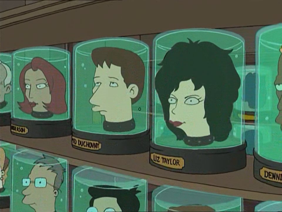

    Screenshot 1 is
    FastLineDarken(Thinning=0)
    Spline36Resize(1440,1080) # the resizing is only to make the differences easier to see.
    Screenshot 2 is
    AwarpSharp(Depth=20)
    Screenshot 3 is
    MergeChroma(AwarpSharp(Depth=5), AwarpSharp(Depth=20))
    The "good" in screenshot 3 is the chroma meets the lines (or gets much closer) without messing with them too much. You can see it in the orange in her hair, or the green, which doesn't bleed onto her arm as much.
    The "bad" is maybe the chroma sharpening is a little over-done. The line on the left side of Peter's face looks a bit orange in screenshot 3. Depth=10 might have been enough. Still, I'd rather live with that. Everything in video filtering seems to be some sort of a compromise.
    I assume MergeChroma(aWarpSharp2(Depth=19)) in your script is doing much the same thing, except the luma is being taken from the source clip after de-interlacing or IVTC, rather than a clip with AwarpSharp(Depth=5) applied. Depth=5 is pretty mild, so the difference wouldn't be huge.

    The first three screenshots are: TFM(mode=5, pp=3, UBSCO=False)
    The next three screenshots are: TFM(mode=7, pp=3, UBSCO=False)
    Once again it's something of a compromise. Where mode=7 does find a clean frame, sometimes there's a little "glitch" in the motion instead of blending. You'd have to decide for yourself which you dislike the most. I could live with the blending where there's a lot of motion as it goes by quickly and doesn't stand out.
